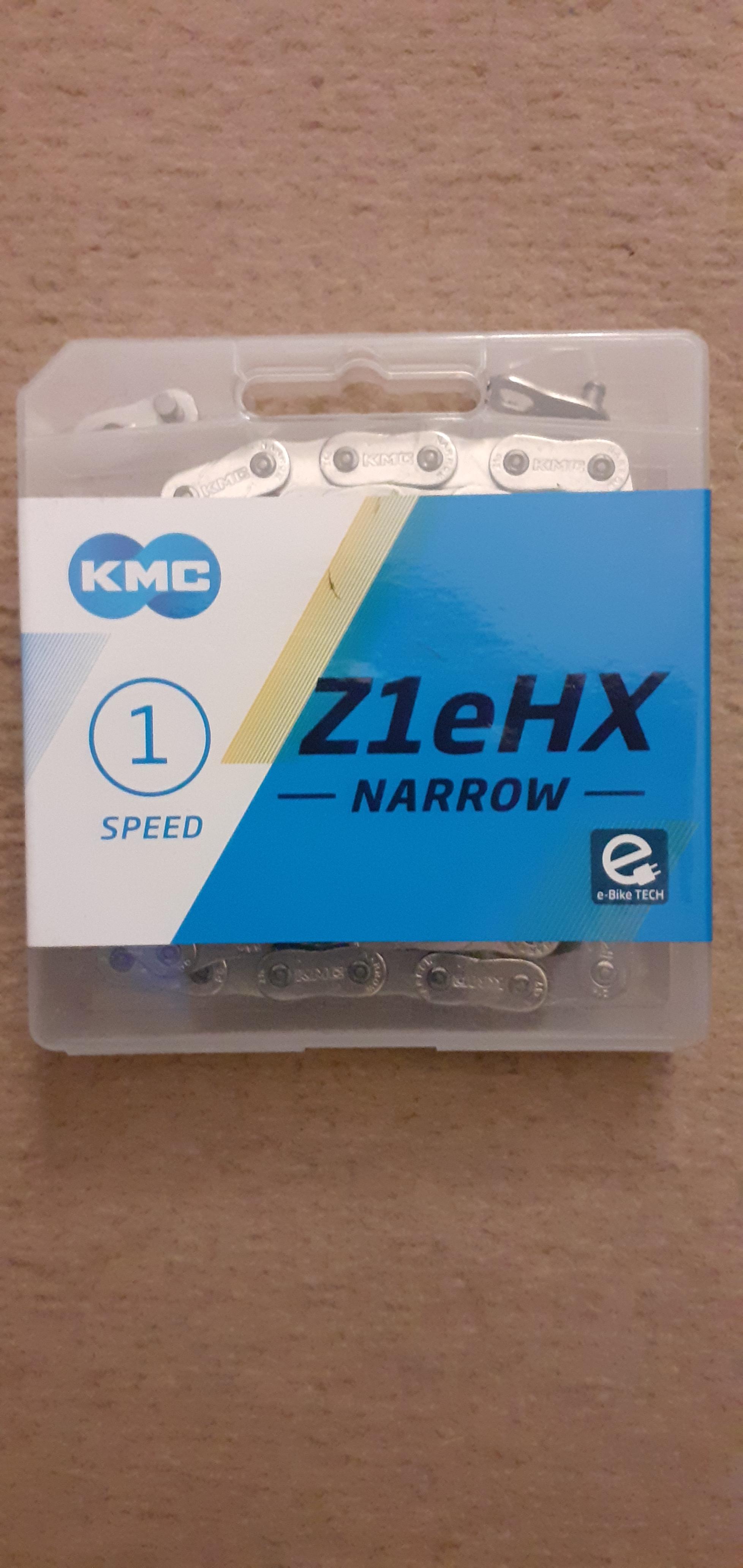

Cool. As I bought the bike 2nd hand I'm keen to put a new chain on asap really.

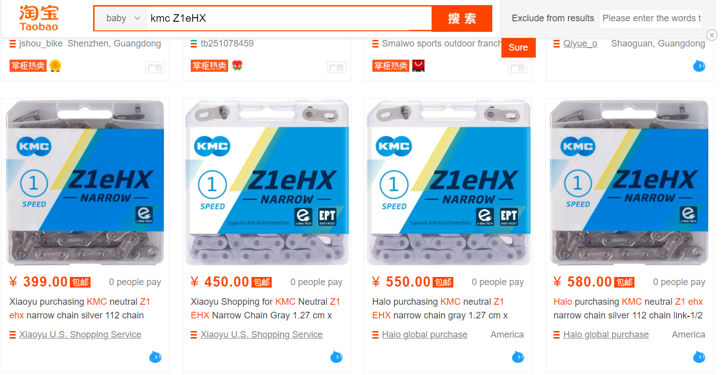

seems like 610 were really hard to find now. The Z1eHX indeed available but confused on the price.
