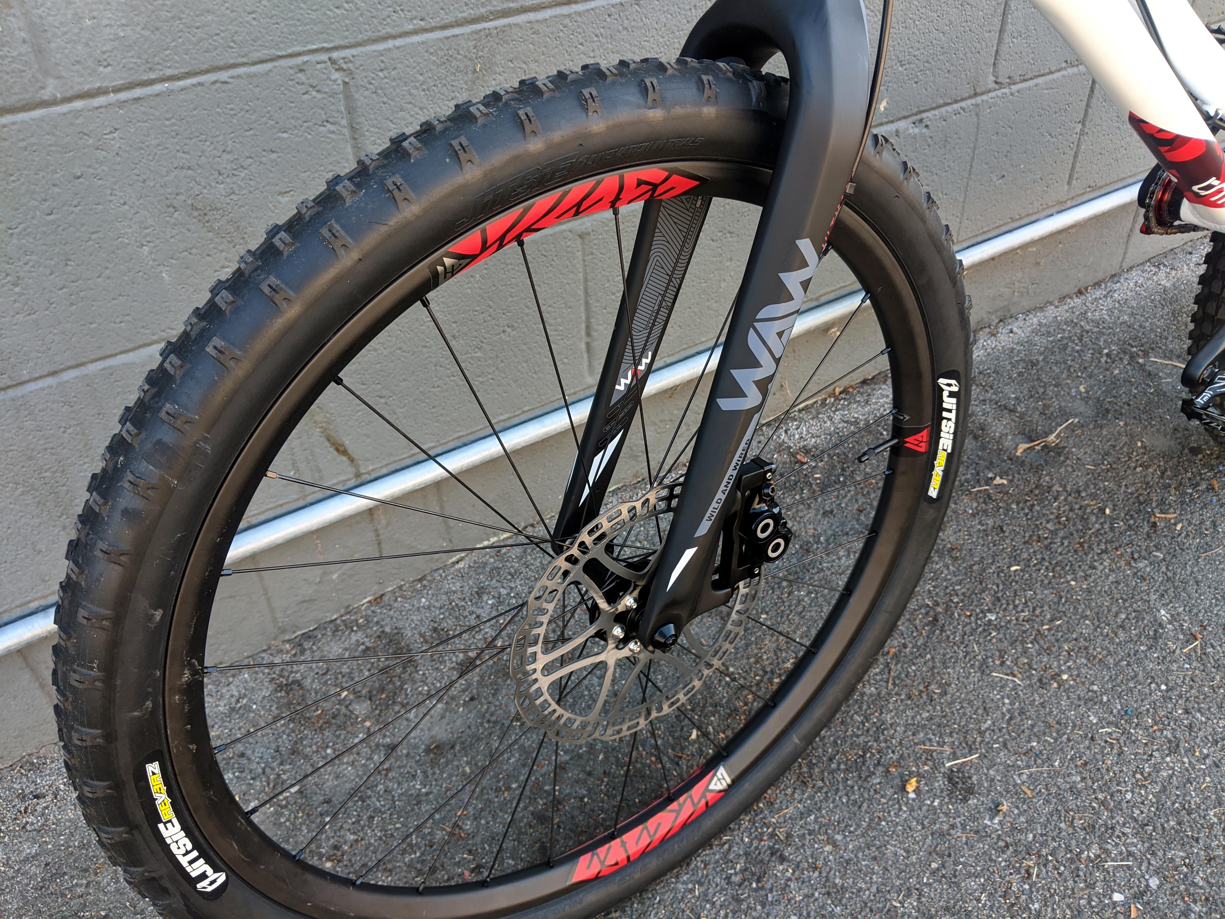

Initially, I bought the WAW carbon disc 26" through-axle fork, and everything was fine until I installed it into the frame and measured the wheelbase. It turned out that the wheelbase with the WAW fork is 1085 mm. That's 10 mm more than with my current Rockman Carbon 24" fork!
That was totally unexpected and unpleasant. Apparently, I haven't taken into account that the WAW fork is a bit higher (405 mm) and has slightly larger offset (35 mm) than the fork I'm currently using. I'd be OK with 1075 mm WB which is long but acceptable, but 1085 mm WB is just too damn long.
While looking for alternatives, I found a 24" disc carbon fork made by Extention with the 20 mm offset and 415 mm height. This seemed interesting, because according to calculations, this fork would make the WB about 1071 mm. Plus, this fork looked beefier (and was heavier), had thicker steerer tube walls than Crewkerz, had 15 mm through axle, and was designed for 180 mm rotors (while Crewkerz made their fork for 160 mm rotors for some reasons). So I imagined the front end with this fork would be as rigid and stiff as it can be.
The only issue with Extention is that they have a steerer tube threaded inside, and a special star nut/top cap designed for internal routing. This design isn't compatible with traditional sloped stem top caps (or stems with integrated top cap like my Clean Pro), so I'll need to make an adapter for a traditional M6 top cap bolt.

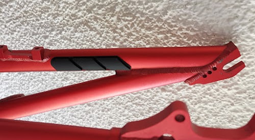

I'll try to use a slightly unusual chainstay protector. Made of some kind of rubber, it's here mostly to eliminate chain slap noise.
