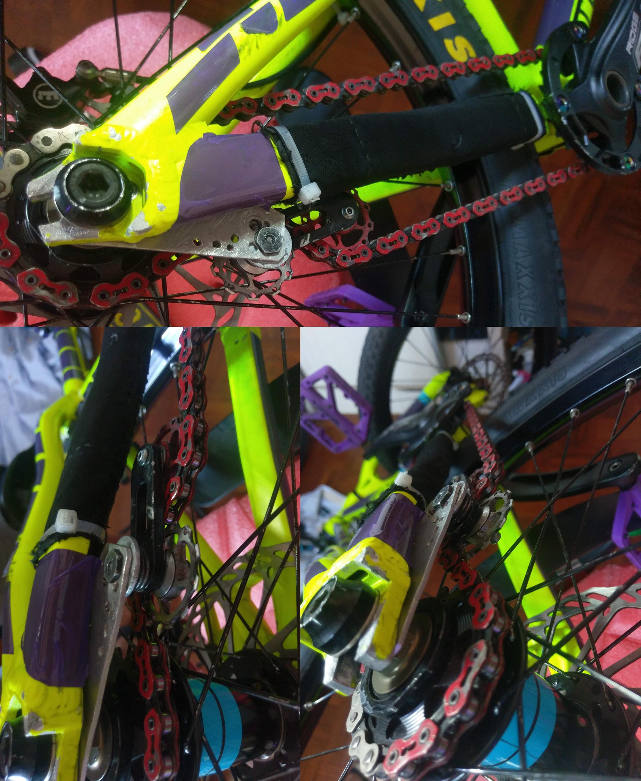

it's the video where I build my orange Hex, not sure of the exact name sorry.
I used 1.8mm titanium, any thinner and it didn't give enough tension and any thicker I couldn't bend with hand tools.
It's not Sugru for the slider, it's a polymorph plastic. Basically a plastic (similar to nylon) that comes in pellets and softens in hot water and can be moulded into whatever shape you want.

I was thinking this one (tensioner is at 7 mins) though it seems my memory was out and apparently it's 1.2mm sheet rather than 1.8 however if you have a vice I'm sure 1.8mm would work fine.
This summer will be that tensioners 4th birthday!

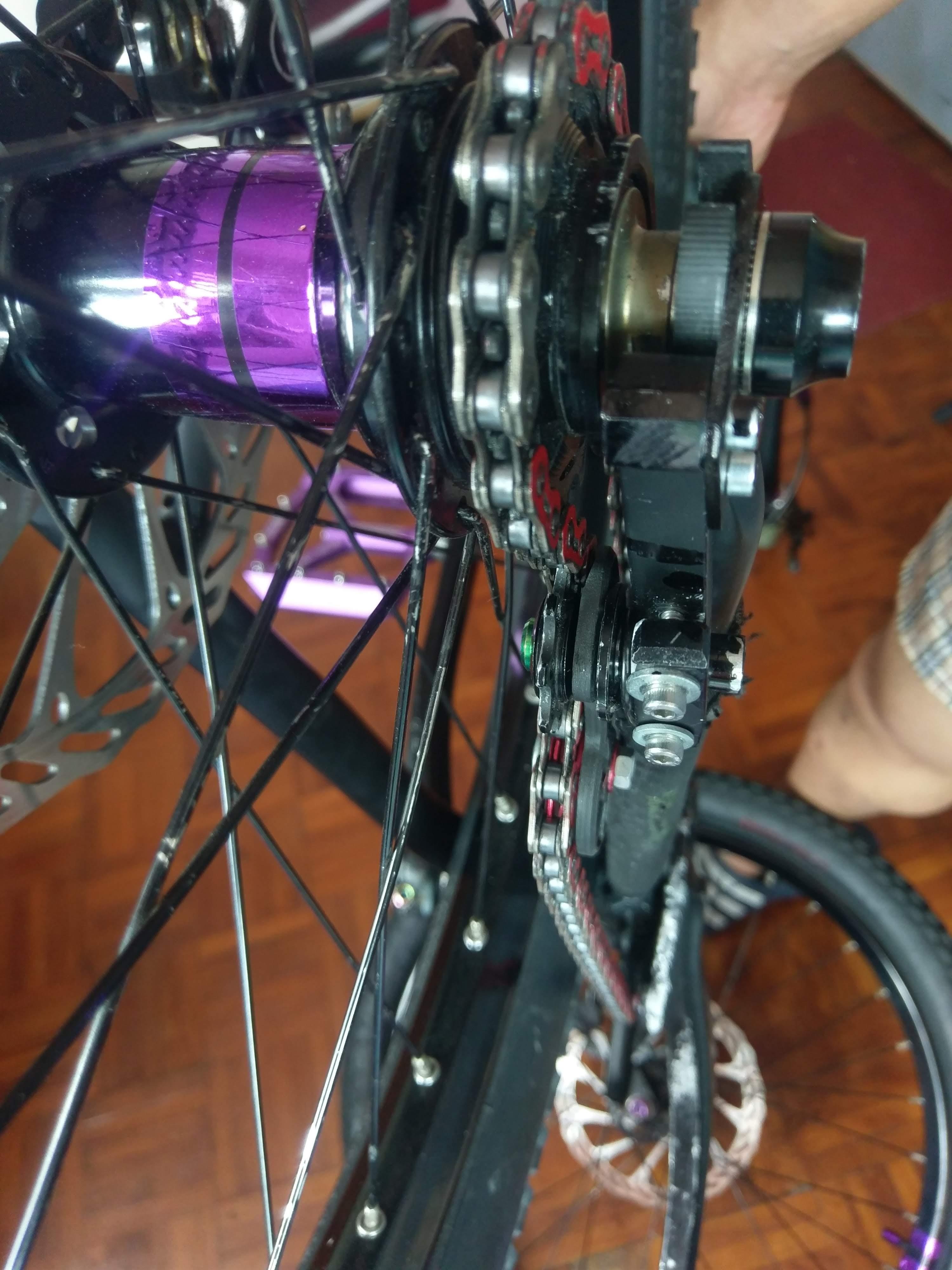

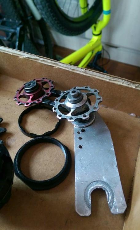

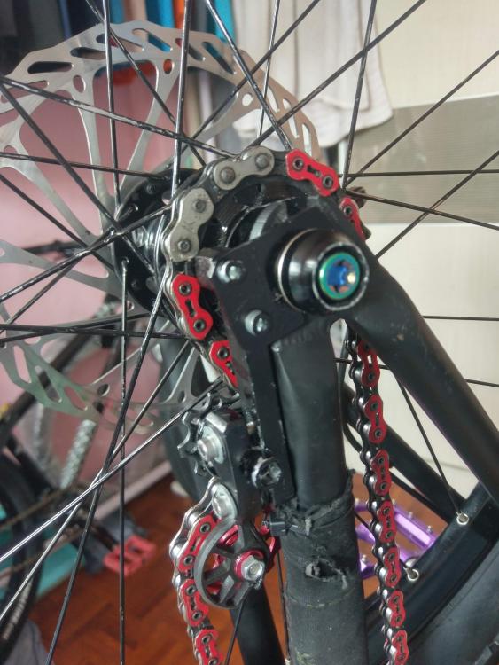

Made the same one as Ali did, from 1.5 mm thick titanium in my case. Wouldn't go any thicker, hard enough to bend as it is. Broke the first one, because my bend was a little too sharp and I went a bit too far with bending. So made the second one with more of an even smooth bend all over. Use power tools or a new very fine blade if you use a hand saw, and a new drill bit, and use cutting fluid, otherwise it's a lot of work to cut.
In the end I went back to the standard dual pulley tensioner. More chain wrap and nothing pulling down on your wheel (thought better safe than sorry with the very delicate I9 freewheel, as tensioning it like this does put some stress on it).
