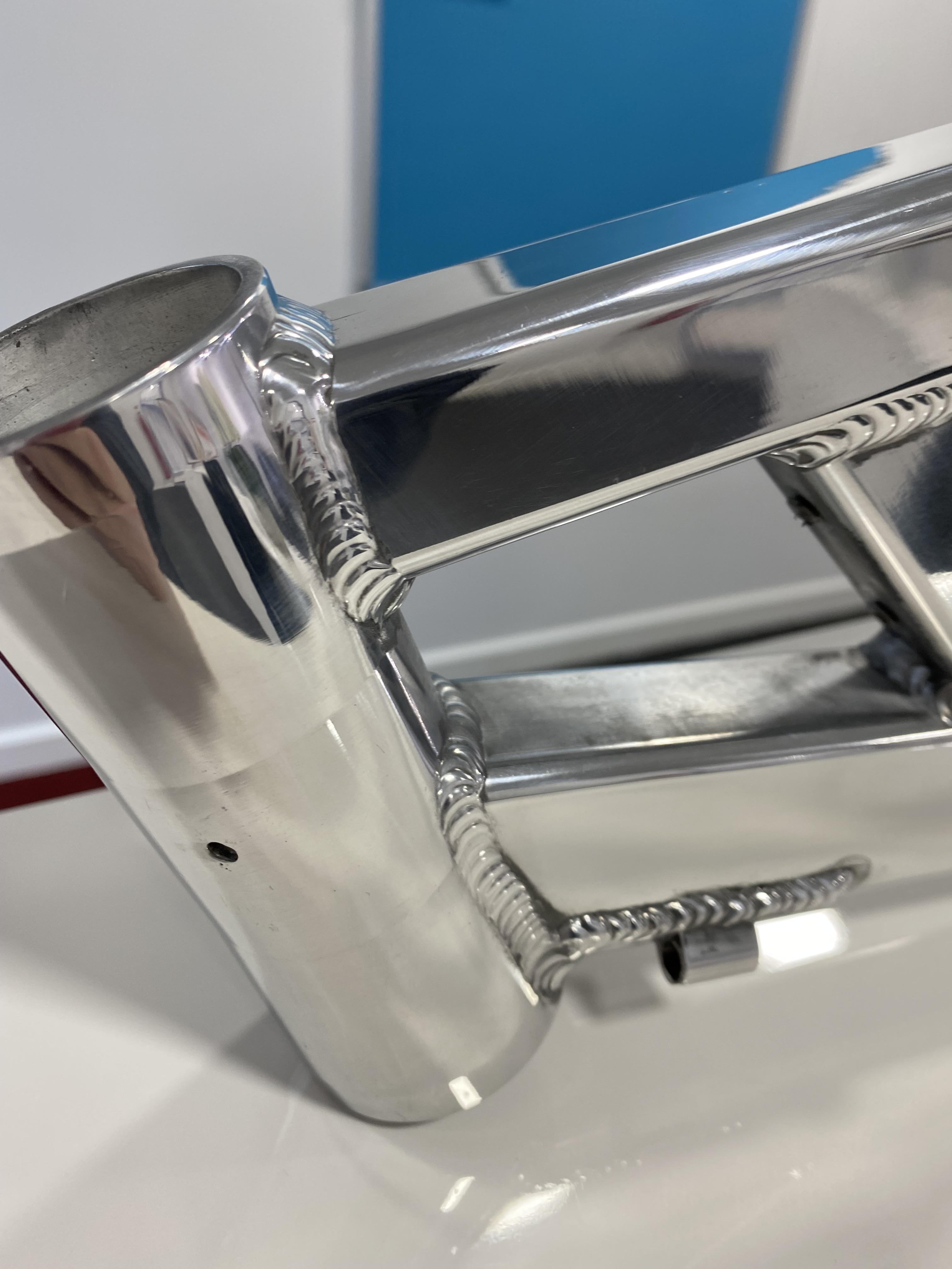

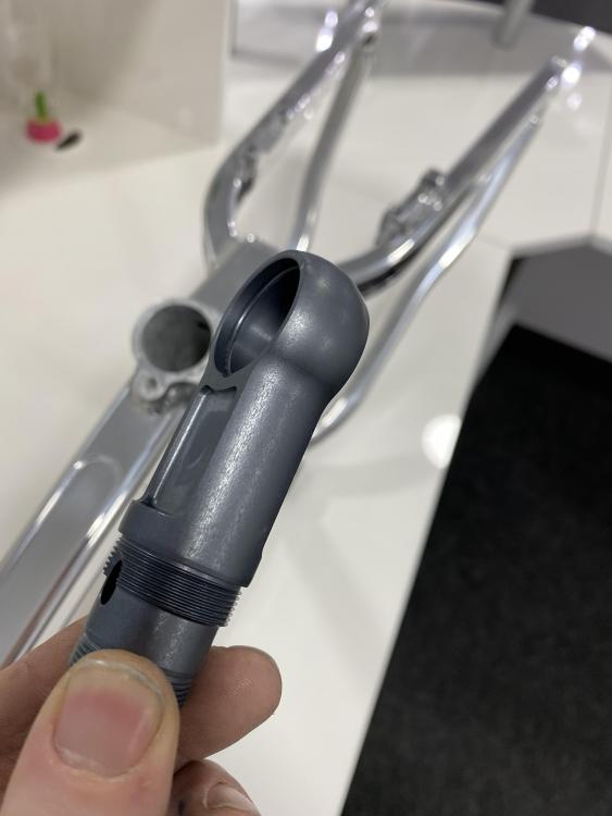

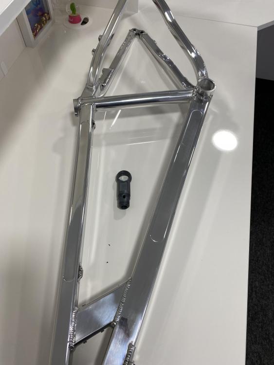

grant wildman Posted March 7, 2022 Report Share Posted March 7, 2022 (edited) I bough this frame a few years back and have just shelved till now. Decided to go against the standard powered coat red (what the frame was originally) or the polished silver and have opted to get the frame anodised in a grey/gunmetal colour. I think there may have been a stock variant in grey, maybe a team issue version? Received some pictures of the frame now its has been returned from the polishers. It was dip stripped and cleaned, but the process dulled the frame so it needed to be polished before any anodising could take place. Being that the frame is 7005 series aluminium, it cant be hard anodised due to the zinc content, so it will be a standard anodising finish. Adam from AA anodising has been a delight to deal with. Thorough and professional. Looking forward to the end results. Hopefully I’ll have the frame back later this week and can get it built up. I have all the components, minus a seat post ready and waiting. Will use a monty mini seat temporarily. More pics up shortly Parts list : Frame Pace RC250t Frame HS33 mounts frame number 005 Forks Pace RC32 trails fork V-mounts Crank Middleburn RS7 crank - Talon 22 ring and black filthy ‘Ard bash guard. Trial tech ISIS Bottom bracket Inspired Pedals Front brake Avid ultimate lever and V-brake Rear brake ’04 HS33 rear brake Front wheel Mavic X517 rim black - Hope pro 3 hub Rear wheel Mavic EX721 rim black - Chris King Classic black - King Cog Stem Thomson elite stem 90x15 Handle bar Renthal Jump bars 70x710mm Hope headset zz44 Edited March 7, 2022 by grant wildman 7 Quote Link to comment Share on other sites More sharing options...

PLIW Posted March 10, 2022 Report Share Posted March 10, 2022 Very very nice. Polishing before anodising is a must unless you want a rough finish. Impressive work done so far. Quote Link to comment Share on other sites More sharing options...

grant wildman Posted March 11, 2022 Author Report Share Posted March 11, 2022 Really please with the photos of the finish. Looking forward to receiving it next week to build it up. Will get some close ups of the finish when I have it. Quote Link to comment Share on other sites More sharing options...
PLIW Posted March 11, 2022 Report Share Posted March 11, 2022 Wow that’s clean. Quote Link to comment Share on other sites More sharing options...

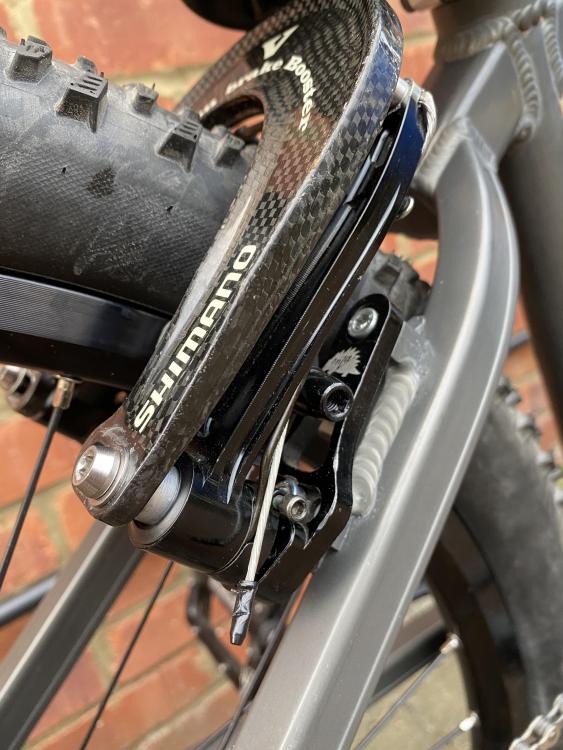

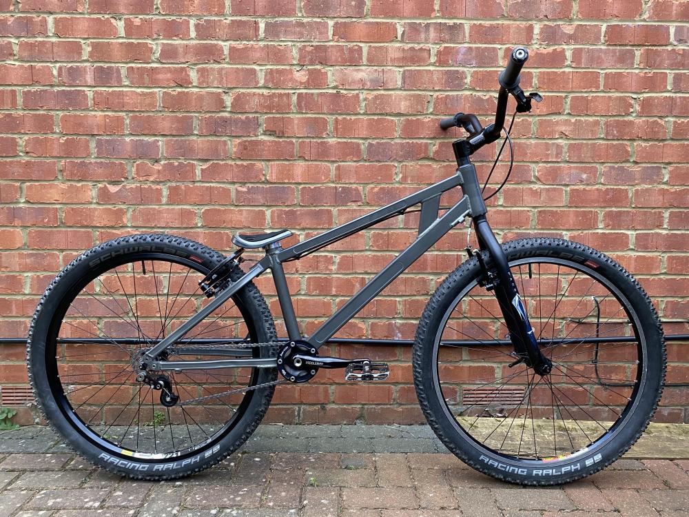

grant wildman Posted March 28, 2022 Author Report Share Posted March 28, 2022 Made a start on the build. Toying with brake set ups, but currently it’s set up with dual Avid ultimate vee’s. May swap the rear brake to an ‘04 HS33. Tyre choice is the next thing to sort. These 2.25 Ralph’s are great but a little narrow, so looking for something a little wider. Frame graphics I need to order and refit the head badge. Also waiting on a seat post as I’ll fit a proper saddle. Has turned out pretty light too. I’ll get it on the scales soon. 5 Quote Link to comment Share on other sites More sharing options...
Ali C Posted March 28, 2022 Report Share Posted March 28, 2022 legendary! 1 Quote Link to comment Share on other sites More sharing options...
Davetrials Posted March 28, 2022 Report Share Posted March 28, 2022 That is f**king flawless 1 Quote Link to comment Share on other sites More sharing options...
DJEHB Posted March 28, 2022 Report Share Posted March 28, 2022 That has to be up there as one of the best looking trials bikes. Love the spec too! 1 Quote Link to comment Share on other sites More sharing options...
PLIW Posted March 28, 2022 Report Share Posted March 28, 2022 Defo needs a set of Maguras on it. Stem and bars look a little too high. I’ve got a set of Azonic OCR and bars that would work. Glad your fitting a proper seat, a nice Tan Flite would look perfect. Very nicely done though Quote Link to comment Share on other sites More sharing options...
aener Posted March 28, 2022 Report Share Posted March 28, 2022 ...Or we could let him build his own damned bike how he pleases. Looks lovely! Oh how I wish rims could stay the colour of the rim with a grind. Looks so much better smooth, but just doesn't work the same (if you're doing the kind of riding where you want a grind, that is ) 4 Quote Link to comment Share on other sites More sharing options...
grant wildman Posted March 28, 2022 Author Report Share Posted March 28, 2022 4 hours ago, PLIW said: Defo needs a set of Maguras on it. Stem and bars look a little too high. I’ve got a set of Azonic OCR and bars that would work. Glad your fitting a proper seat, a nice Tan Flite would look perfect. Very nicely done though I’ll only fit a Rear HS33 if I do, think It might look cleaner. But I’ve always preferred Vee’s over Maguras. The bar an stem fitted feel great, 90x15deg stem and 70mm rise bars. I think the Azonic combo would be too low, thanks though. Not going for replica/retro (despite the frame and most of the components being old) build with this bike. Just built it how I like with the parts I like. You know I’ve got a few retro bikes and while retro/replica builds looks great, they still ride like old bikes and are hard work, unless you are Ali C of course. So I want to ride this one. I think a Tan flight will be harder to find than the forks were! But I’m on the look out for something along those lines. Cheers Quote Link to comment Share on other sites More sharing options...
PLIW Posted March 28, 2022 Report Share Posted March 28, 2022 3 hours ago, grant wildman said: I’ll only fit a Rear HS33 if I do, think It might look cleaner. But I’ve always preferred Vee’s over Maguras. The bar an stem fitted feel great, 90x15deg stem and 70mm rise bars. I think the Azonic combo would be too low, thanks though. Not going for replica/retro (despite the frame and most of the components being old) build with this bike. Just built it how I like with the parts I like. You know I’ve got a few retro bikes and while retro/replica builds looks great, they still ride like old bikes and are hard work, unless you are Ali C of course. So I want to ride this one. I think a Tan flight will be harder to find than the forks were! But I’m on the look out for something along those lines. Cheers https://www.ebay.co.uk/itm/SELLE-ITALIA-FLITE-1990-SADDLE-NUBUCK-BROWN-/224808579844?mkcid=16&mkevt=1&_trksid=p2349624.m46890.l6249&mkrid=710-127635-2958-0 I got one here and it’s really really nice. Quote Link to comment Share on other sites More sharing options...
grant wildman Posted March 28, 2022 Author Report Share Posted March 28, 2022 4 hours ago, aener said: ...Or we could let him build his own damned bike how he pleases. Looks lovely! Oh how I wish rims could stay the colour of the rim with a grind. Looks so much better smooth, but just doesn't work the same (if you're doing the kind of riding where you want a grind, that is ) Your right, a TGS style bike running rim brakes really needs a grind, but some sticky pads on a smooth rim are fine for an old street basher like this bike (and its rider). All as long as its not wet out! 1 Quote Link to comment Share on other sites More sharing options...

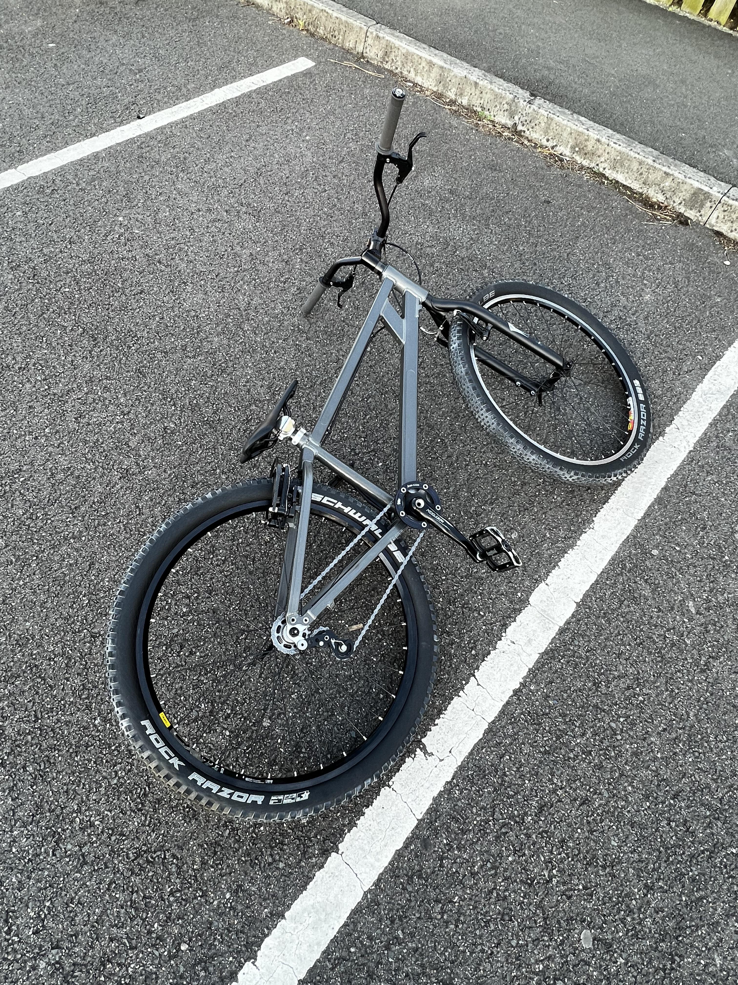

grant wildman Posted August 2, 2022 Author Report Share Posted August 2, 2022 Still need to fit the head badge and sort some frame graphics, but some bigger tyres and a saddle have been added. 5 Quote Link to comment Share on other sites More sharing options...
craigjames Posted August 2, 2022 Report Share Posted August 2, 2022 That looks stunning, very envious! 1 Quote Link to comment Share on other sites More sharing options...
AdamR28 Posted August 2, 2022 Report Share Posted August 2, 2022 What a beaut 1 Quote Link to comment Share on other sites More sharing options...
