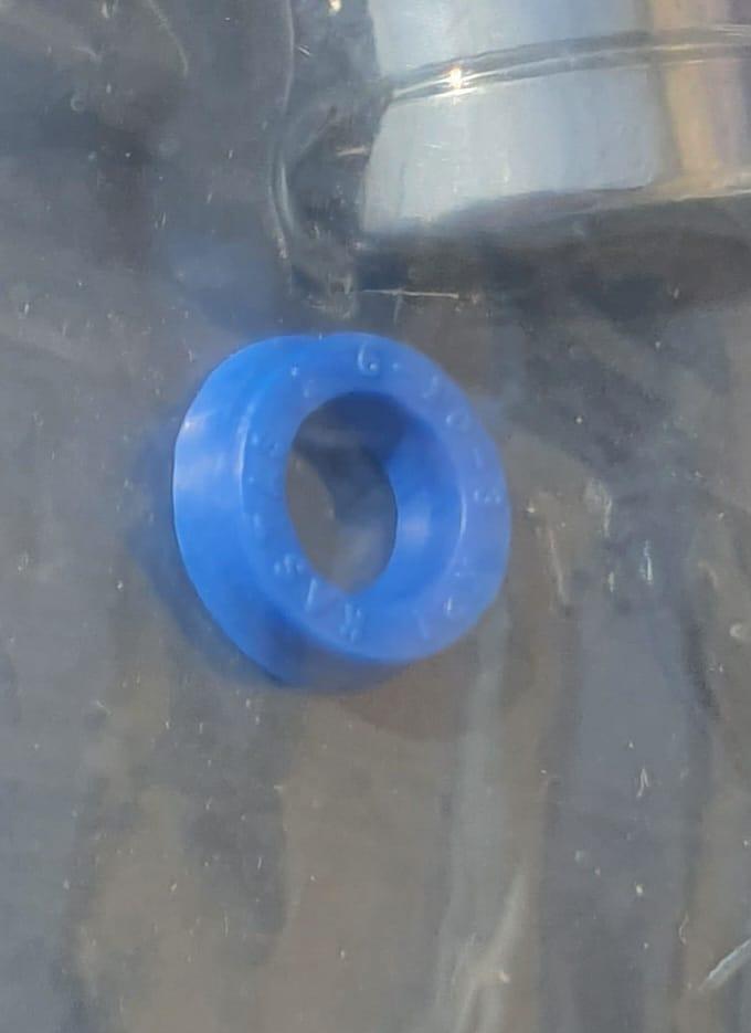

Rip Posted March 19 Report Share Posted March 19 (edited) Not mine but a mate went over the bars earlier and now his back brake doesn't work at all, lever to bar with zero resistance. No visible damage on the outside, no oil leaking anywhere, everything done up tight etc. Tried a fast bleed then a full bleed but exactly the same. We've decided he probably needs a new lever because the internals are not serviceable but does anyone have any idea what could have happened as I'm curious? He's going to take it apart but hasn't as of yet. I'm wondering how an internal part got damaged so badly without any significant visible damage. Aso I assume nowhere sells the actual master cylinder without the HC3 lever blade? Not having to buy the blade would take a chunk out of the £98. Aso anyone know if an MT5 lever would work with an MT7 caliper? Edited March 19 by Rip Quote Link to comment Share on other sites More sharing options...

Rip Posted March 20 Author Report Share Posted March 20 Confirmed blown seal on piston in lever. It wasn't even a hard or fast crash, just a slow over the bars. These plastic MT levers are rubbish. I'm personally switching to Hayes Dominions before this happens to my set. Quote Link to comment Share on other sites More sharing options...

Rip Posted March 21 Author Report Share Posted March 21 (edited) So what causes a seal to blow like this (and in two places) after a very low speed over the bars crash? The lever being pushed in to quickly? Edited March 21 by Rip Quote Link to comment Share on other sites More sharing options...

Rip Posted March 21 Author Report Share Posted March 21 (edited) Bore looks ok initially but he's going to get an endoscope down there later. I made a mistake earlier, the bike didn't come from Tarty in the end because it was bought at the time when everyone was having major stock issues. Edited March 21 by Rip Quote Link to comment Share on other sites More sharing options...
Rip Posted March 21 Author Report Share Posted March 21 Bore looks ok, only thing we can think of right now is that the seals are slowly getting damaged every time they pass the bleed port up until a point where they can't take the pressure any more and just fail. Quote Link to comment Share on other sites More sharing options...
AdamR28 Posted March 21 Report Share Posted March 21 Hmm. Possible! So those are two different pistons from two different levers pictured above? Quote Link to comment Share on other sites More sharing options...
Rip Posted March 21 Author Report Share Posted March 21 4 minutes ago, AdamR28 said: Hmm. Possible! So those are two different pistons from two different levers pictured above? I got the impression both photos are the same piston and seal. I've asked if that's the case so I'll update once I know. Quote Link to comment Share on other sites More sharing options...
Rip Posted March 21 Author Report Share Posted March 21 @AdamR28yes confirmed both photos are the same piston so that seal clearly had two potential failure points. Quote Link to comment Share on other sites More sharing options...
Rip Posted March 22 Author Report Share Posted March 22 Well, he's fitted a new seal and it seems to be working again. Quote Link to comment Share on other sites More sharing options...
ben_travis Posted March 22 Report Share Posted March 22 Where did he get that seal from? Quote Link to comment Share on other sites More sharing options...
Rip Posted March 22 Author Report Share Posted March 22 30 minutes ago, ben_travis said: Where did he get that seal from? www.123bearing.co.uk He got these because they were in stock US-6X10X3-PU94 but said that UT-6X10X3-PU92 would possibly have been a better fit but they were out of stock. They are just hydraulic u-cup seals with 6mm internal diameter, 10mm outer diameter and 3mm height. The PU92 is apparently softer than the PU94 and the US vs UT is the length of the lips. I'll update the thread when we know how if they work long term or end up failing short term. So far the brake seems to work fine. Quote Link to comment Share on other sites More sharing options...

Rip Posted March 22 Author Report Share Posted March 22 4 minutes ago, LEON said: Standard modern Magura quality. Seems so, their seal looks very weak compared to the replacement. Quote Link to comment Share on other sites More sharing options...
