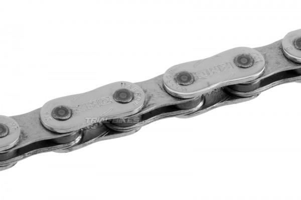

I need a new chain tool to join my KMZ Z1eHX Narrow chain, I was looking at KMC's tool (Here) but their blurb says the tool is for breaking only and not rejoining, I know they recomend using a split link but obviously I'm not going to do that so I'm wondering if their tool is not actually designed to rejoin a chain also?

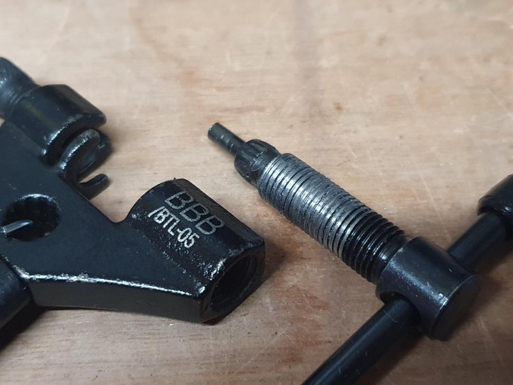

I had a BBB Nautilus II because they 'were' apparently well made but they're not any more it seems (see below) lol I managed to use this tool to break and rejoin a KMC chain with success but upon trying it for a second time the thread just stripped out when I tried to push the pin back in.

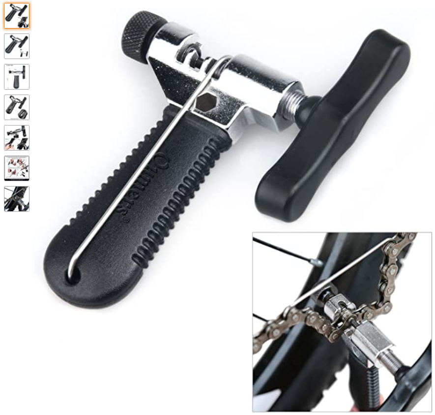

I have a Rohloff revolver 3 that's a true re-riveting tool, but $$$. I found this Oumers Chain Tool to be quite capable and very inexpensive (at least in the States). It's not a re-riveter, but it has quite a few good features for such a small tool.
