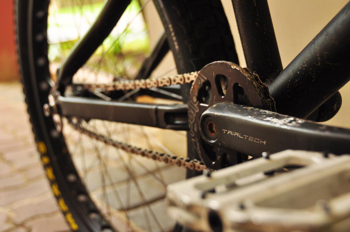

Looks fresh man, I couldn't help but notice the slack chain though?
Yep, not using a tensioner+rear axle not sitting completely in the dropouts=slack chain. Seems fine for now though.

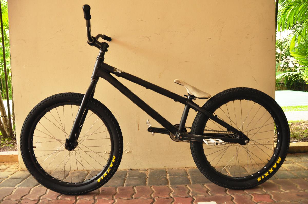

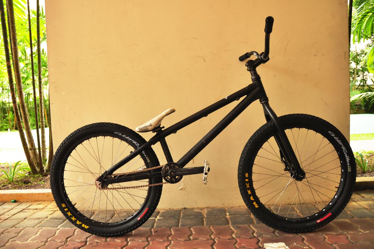

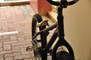

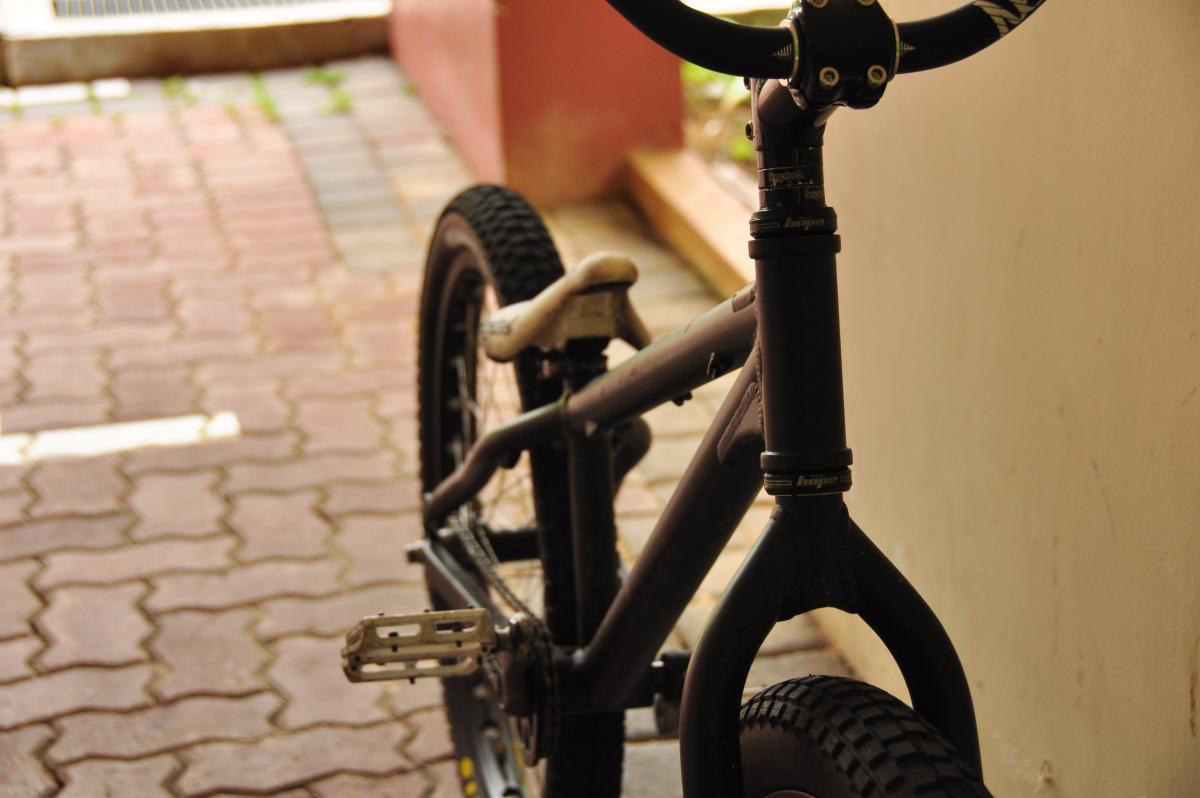

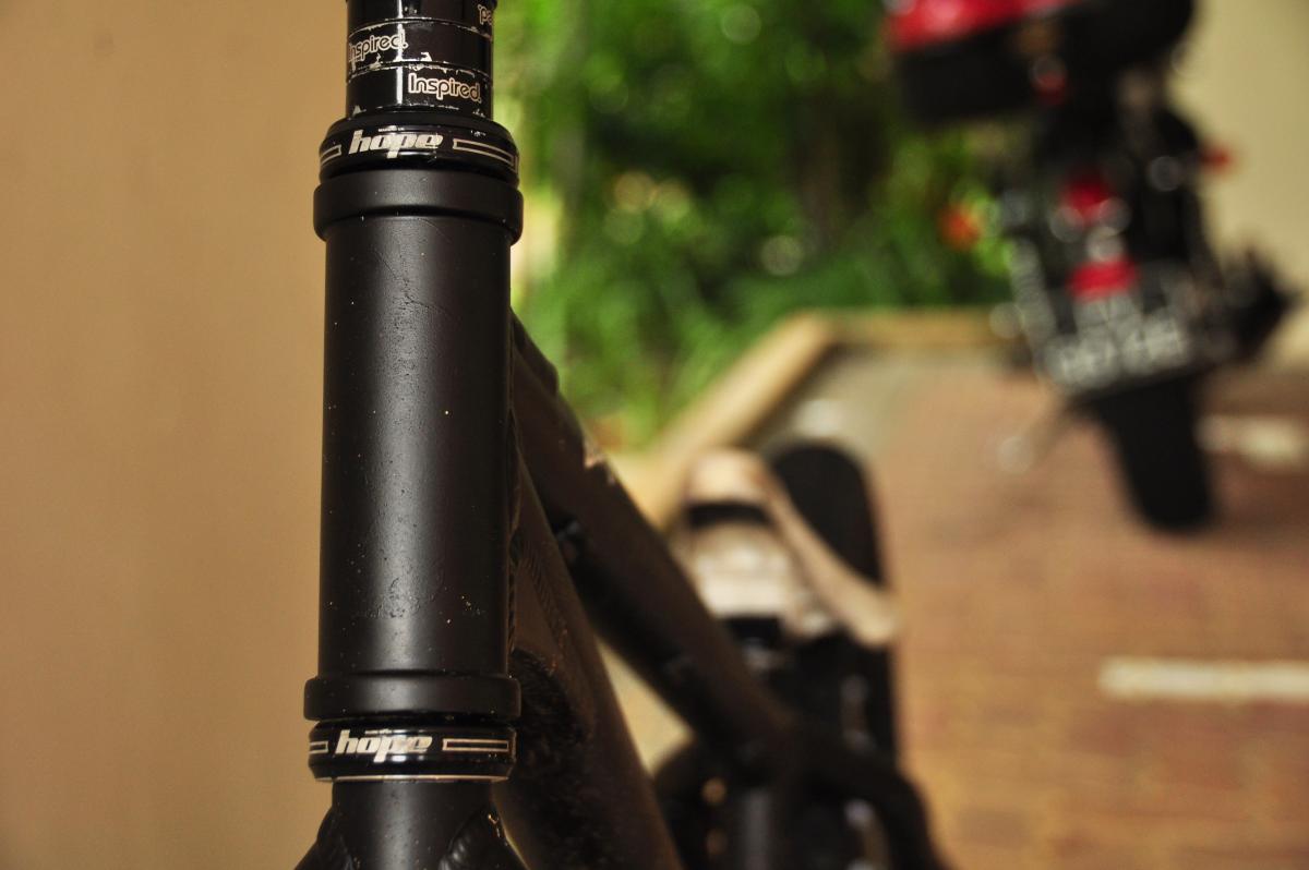

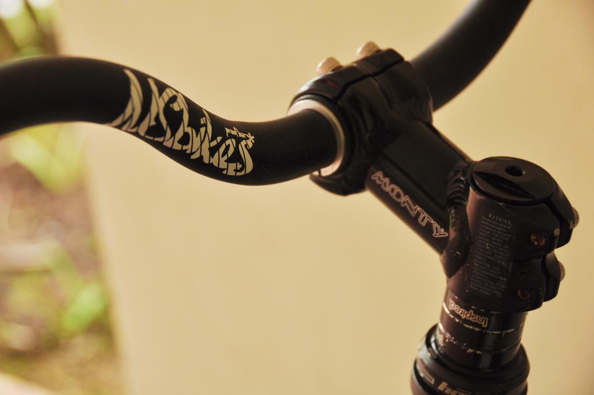

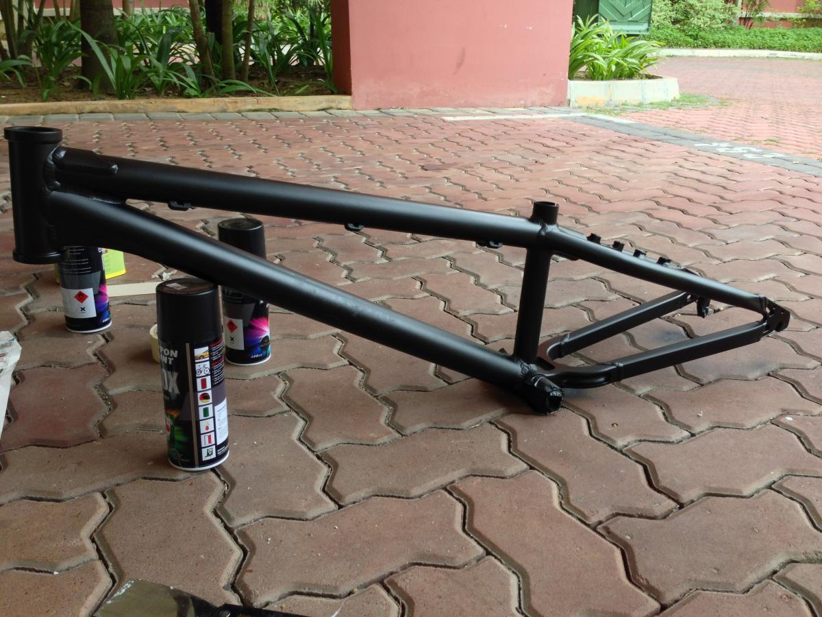

Not a new bike, but since I've bought some new parts for it and gave it a fresh coat of paint I decided to put it up here.
Before...
Painting...
And it all built up! (Sorry for the muddy bike, I couldn't resist a ride(or 3) on it)
Spec:
Frame and Forks
- Frame: Inspired Fourplay 2010
- Forks: Inspired Team
Wheels
- Front hub: Hope Pro 2
- Rear hub: Hope Pro 2
- Cassette Lockring: Trialtech
- Chain tensioner: Nil
- Front rim: Inspired Team, 24", drilled, White
- Rear rim: Inspired Team, 24", drilled, White
- Spokes: Sapim Race DB
- Rim tape: Some random one
- Inner tube (front): Random
- Inner tube (rear): Random
- Front tyre: Maxxis Holy Roller 24 x 2.4"
- Rear tyre: Maxxis Holy Roller 24 x 2.4"
Brakes
- Front brake: Nil
- Rear brake: Nil
Drivetrain
- Cranks: Trialtech 175mm
- Front Sprocket: Trialtech 23T
- Chain: Odyssey Bluebird without half link, still waiting for the chain to stretch.
- Rear Sprocket: Trialtech Sport Splined, 17T
- Pedals: Inspired Platform, White
- Bottom bracket: Trialtech
- Bashring: Inspired
Seating
- Saddle: Inspired Pivotal, Black
- Seatpost: Inspired Pivotal White
- Seat Clamp: Hope
Steering
- Headset: Hope
- Stem: Monty Urban, 80mm 10 degree rise
- Grips: Random foam ones
- Handlebars: NS Proof

I can see one problem and that´s your chain being too long, try to take one link out and it should make it easier for the tensioner too.

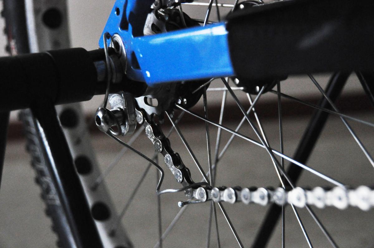

Today I took out a link in the chain, and initially it was so tight that I could barely pedal. So I loosened the bolt slightly, and the tension was just perfect. Do I need to be worried about: (i) The entire wheel coming loose because of the not-fully-tightened bolt?
(ii) The chain and sprocket wearing exceptionally quickly?
(iii) Damaging the dropouts?

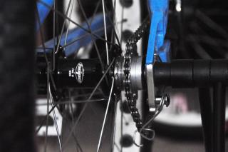

Sorry for the late reply guys, here's a picture of my current setup:
And I'm not sure where I could hook the spoke unto, because from what i see from the Tarty crew's photos, they seemed to hook unto the axle just beside the freehub body, but in my case there are spacers(?) there. Is there any other place to hook the spoke around besides the hanger bolt or the freehub body? The chainline seems pretty damn straight too, so I'm pretty sure that isn't the problem.
Hey all, so I've recently been breaking more tensioners than I have in my 4 years of riding, and I'm tired of spending money to constantly buy new ones. So, I tried to build a spoke tensioner using the Tarty crew's method. However my chain has constantly been skipping off the sprocket and into the spacers. I've also tried 'caging' the chain by hooking the spoke around it, but it also pushes the chain off the sprocket.
Is there something I'm doing wrong? This problem has really been frustrating me lately. Any help (hopefully a video tutorial, if anyone is kind enough to make one
) would be greatly appreciated. Thanks!
P.S I'm using a 2010 Fourplay frame, if that make a difference.
