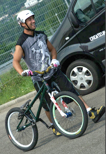

Its not as the components of the bike are ones which would be found on a trials bike not on a DJ bike, e.g. Maggy HS33 rear brake and a disc front, the super small gearing. -
Suspension Forks On A Trials Bike?
Crazy Drummer replied to Crazy Drummer's topic in Beginners Trials Chat
What's it like t ride trials with them? How much travel are you running on yours? -
Just seen this picture of Yohan Triboulant with his 24" street trials bike, i see hes running a lowered set of Marzocchi Bombers. was wondering whats peoples opinion on running a set of these? they look good, there heaver than ridged forks and more expensive. are there any benefits?
