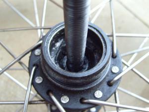

I think my axle is slightly bent. It's been suggested to me by a family member (who knows a bit about bikes, but not about trials) that I should get another one that is stronger. This person also suggested that this is the reason for my persistent problems with rear cones becoming too lose. Either way, I'm wanting to know what sort of axle I should get.
Here's a picture of my hub:
My bike is a Zona Zip built by SuperCycles, I don't know what hub it is, I don't know if you get different sized axles, basically I know nothing. What axle should I get? It would be great if anyone could link me to one on tarty or chain reaction. Or tell me that this is not the cause of my problems.

Its an Onza T-Pro hub, axles may be available separately from Supercycles, give them a call. Axle being slightly bent wouldn't be the cause of cones coming loose, if it's correctly maintained it will stay tight.
I would say it's very unlikely a stronger axle is available also, they are 10mm solid steel... you're doing very well/something wrong if you managed to bend it!
but the axle being bent will make the cones harder to set up, as their will be tight spots, and once its bent...it only ever seems to get worse :(
axles are cheap to get, just go to your lbs, its only a generic hub, be about 3-5quid inc. bearings
