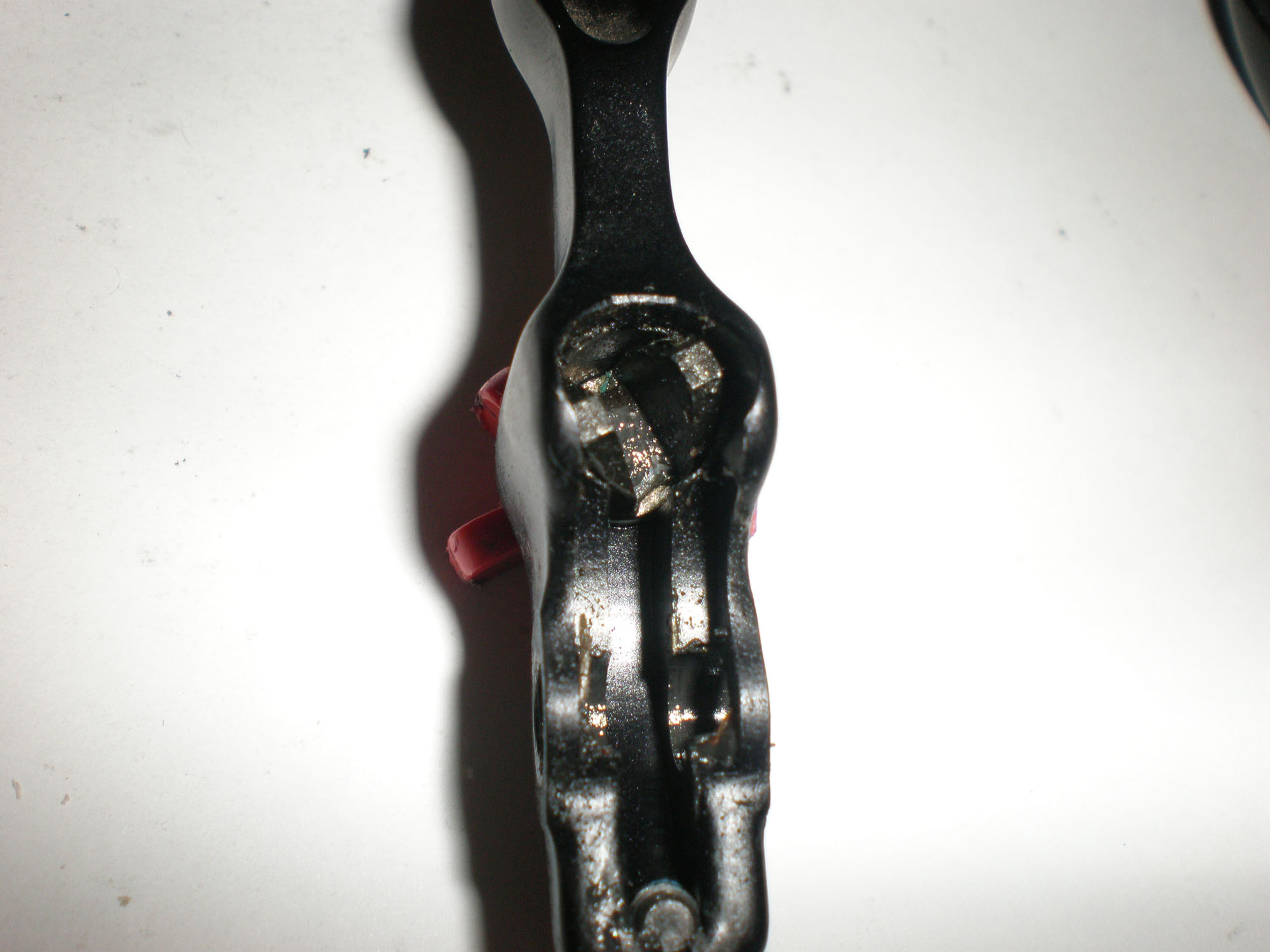

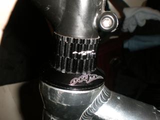

My headset has come abit loose and i don't know how to tighten it up cane any one help

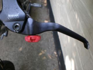

and also the little red bit on my brake lever (sorry i cant remember what it is called) doesn't work any more do i have to buy a new lever and if i do would i need to re-bleed the brake?

With the headset do the top cap up should tighten the headset dont do it to tight. If that doesnt work either the star nut is broke or the headset is knackered.

Right K,you need to undo the two bolts on the side of the stem,then nip up that allen key bolt on the top of ur stem,nip it up a bit and check it each time you do by holding the front brake locked on and pushing it backwards and forwards to see if you have tightened tour heasdset enough...
if it doesnt tighten up you'l need to check your star nut thats inside your steerer tube of your forks,you will be able to see this if you remove the bolt completely thats holding the stem down via the top cap,may be a case that you have to knock it down a little bit further,also something to check,make sure you have enough spacers (those carbon looking rings under your stem,if theres not enough on ther and theres you wont be able to tighten your headset up enough
As for your red knob thingy(this is called a turbo pad adjuster,or tpa for short) theres a section or thread on here possibly in the trials wiki that runs you through a way of fixing it,it's a bodge but apparently it works a treat....hope thats helped fella :)
Not necessarily true. The bearings could have worn slightly, or the stem could have slipped on the steerer. The star nut can break and nothing would happen, it's only there to tension the headset, not take any load.
And don't just tighten up the topcap bolt, that will damage the star nut. Undo the stem bolts so they're slack, then nip the topcap bolt up which should take up all the slack, then tighten the stem bolts up.
With the brake rebleed and if still doesnt work the tpa is knackered. There is a subject on wiki about it.
I'd take the lever blade off first and see if the TPA has broken, if it has, replace it with a bolt. If it hasn't, replace it with a bolt anyway as the standard ones are shite.
It may be that you've simply used up all of the movement in the TPA. If it isn't broken then wind it all the way in and set up the slaves again and set the pads closer to the rim.
If the lever feels really mushy like there is air in the brake, then you rebleed it.

Oh if you think your headsets f****d then check your bearings in it,if its not a cartridge unit you may be able to just replace the cage bearings that are in ther,theyre cheap as chips
Thanks m8 i will give it a go
I would have never have sorted that out with out your help thanks also my disc cylinder was loose :blink: but i sorted that out now
i will check that brake lever out soon i just need to pop to the shops quick but i do think the TPA is broken because it just keeps turning
also i don't know how to adjust the slaves Ive never tried and not knowing what to do i fort id leave them alone but i do think one off them is slightly off

For when you have a go at re setting your rear brake (Y)
http://www.trials-forum.co.uk/wiki/How_to_...p_a_Magura_HS33 you'l find lots of info on the wiki part of this forum :D

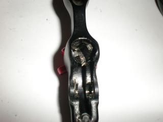

ive taken the lever off and you mentioned the bolt i could replace but i cant seem to get it out
the tpa part wont come out thats if its suppose to come out plus when you turn the tpa
nothing moves it just keeps turning so i think its broken.
