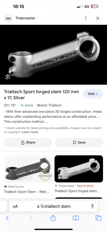

Ah there it is - trialtech 120x17 is the stem you want!
Last time I checked on online shops I could only find the 130x25 geo but I was sure that there was a shorter one… might be an older model which is now discontinued or last stock here and there but you should be able to get one second hand. Think that’ll work well on your bike, also you might want to upgrade to jitsie or trialtech high rise bars to give you some leverage over the front.
