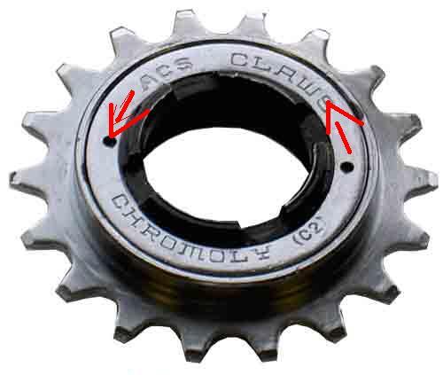

Check your pedals and cranks are tight.
OIf they are and it still does it, it's your freewheel.
Which means you have to tighten it.
[attachmentid=9080]
Get a small screw driver and put into the wholes next to the arrows on the picture and hit it with a hammer in the direction shown in the picture.
id do this beofre every ride.
Jobs a good 'un.

i had a da bomb pro team magura that hada an acs freewheel on it.. i then got pi**ed of with tightenin it and eventually sold the bludy thing. i should have got a new freewheel but couldnt be a*sed, got my moneys worth back from ebay though :D .. GET A NEW FREEWHEEL MATE (Y)
