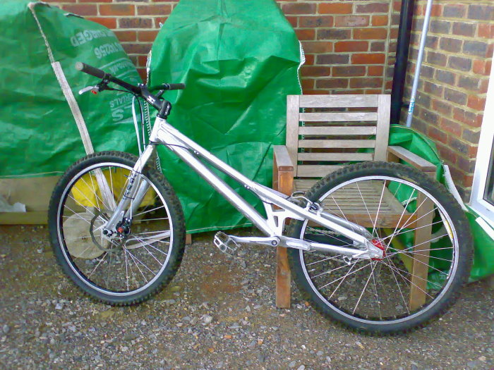

  7. Current Specs: 05 Zoo Pitbull Long - 1080wb Echo Hifi stem Front Hope XC disc hub Rear ProII Trials 06 - Red Zoo bars 07 Avid BB7 08 Front Disc Brake Rear Maggie 05 - plaz CRM on grind / Hope braided crossover Middleburn rs7 - 20T milled bash Gear ratio: 20:17 Maxxis Minion Tyres Muddy!!.. To-do: New Drilled Alex DX32 going on instead on rear.. Plus new pedals on way! oh and yes, that front brake cable housing is going to be cut down...once the bb7 is bedded in! New gear maybe? Any Comments welcome!..
