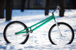

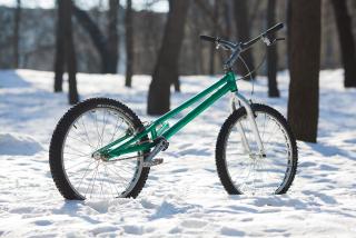

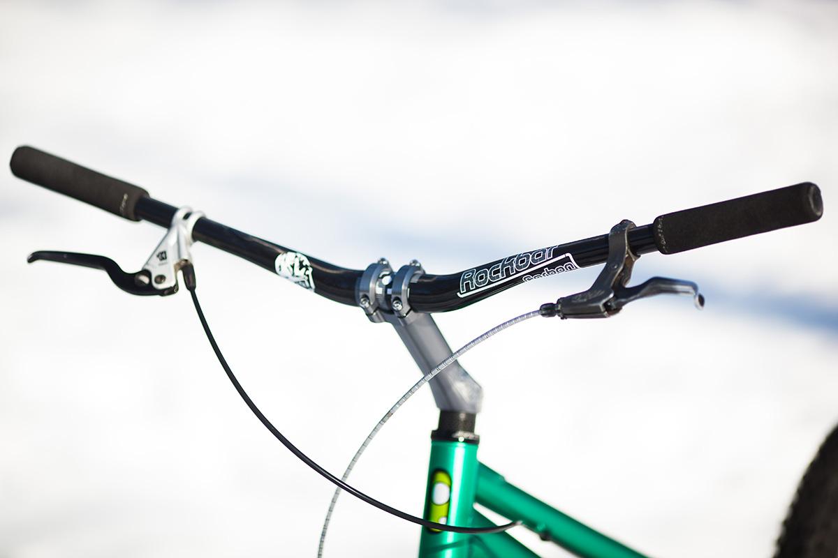

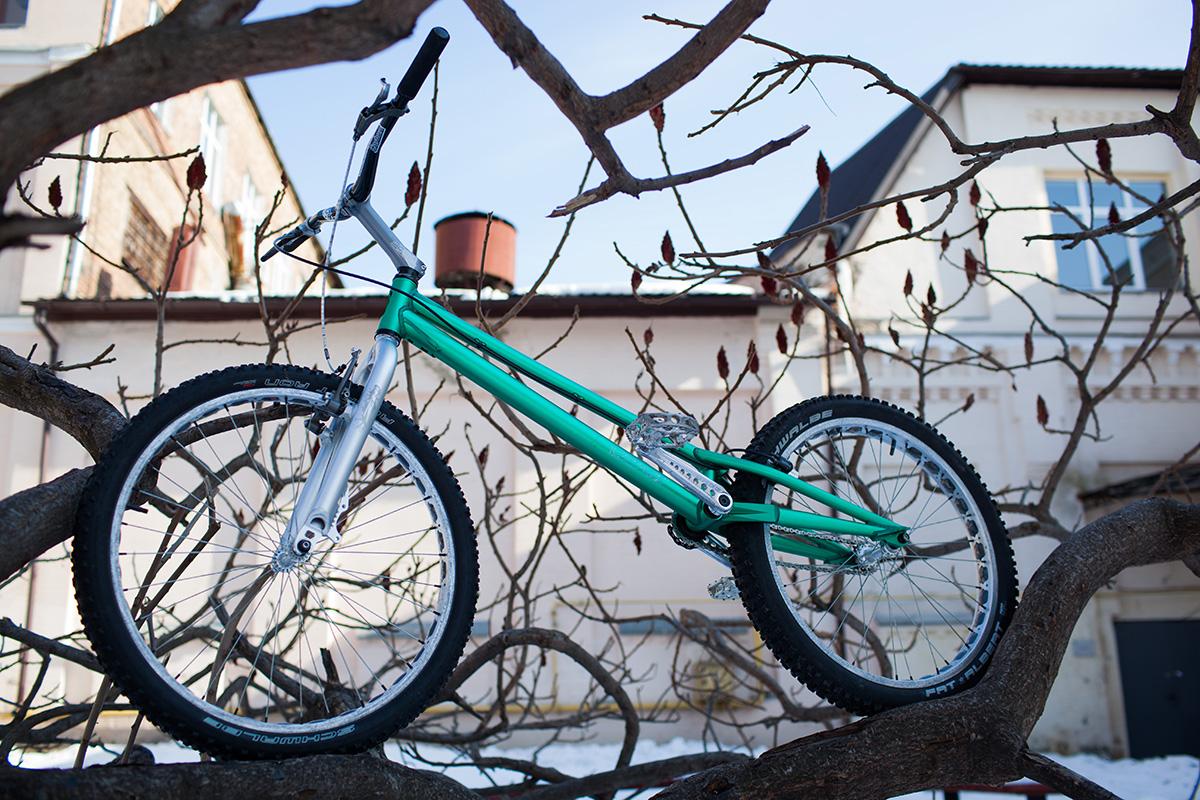

Geo: 1070, +77, 370 weight: 8.100 (should weigh precise later) Frame: Viper 24" Fork: Zhi R 24" vee+disk Headset: Zhi L Stem: Born 150mm 30° Handlebar: Rockbar Carbon 2012 Grips: Trialtech Foam 30mm Rims: Neon 24" Hubs: Zhi R 2012 Front tyre: Schwalbe Rocket Ron 2.1 Rear tyre: Schwalbe Fat Albert Rear 2.4 Nipples: Neon Alu Spokes: cheap noname BB: Trialtech Sport ISIS Cranks: Echo SL Freewheel: Echo TR 108 Halfring: Neon Pedals: Wellgo MG-1 Chain: Bonz Sprocket: Zhi 15t Front brake: Avid FR5, Nokon, Avid SD7, Heatsink Coust CNC Rear brake: Magura HS33 2005, 4 finger lever, Heatsink Coust

i know only 2 or 3 guys here in Ukraine who use brakes vise versa The angle is personal habit
