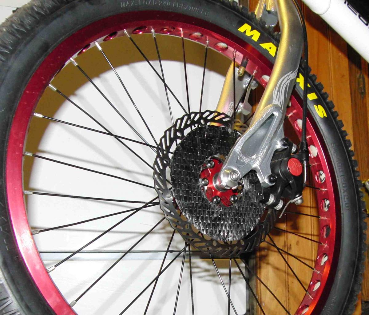

So here's a rotor guard proof of concept. It is a crude first try. I learned a lot about carbon fiber cloth, and came up with lots of "better approaches" toward fabricating these, while I was doing this. It is unidirectional carbon fiber cloth and West System G5 epoxy. My circles didn't translate well from the template to the carbon fiber, and I could do with less space between the outer circ. of the rotor guard and the rotor, but my brakes seem to be mounted too close to the hub so I can't get much closer. The pads come in too close to the inner edge of the working surface of the rotor, to close up that gap completely. The epoxy is still hardening. I feel comfortable that this rotor is less dangerous than a completely exposed rotor. The guard for the rear rotor will have a cleaner look than this first one. Can't wait to test it out! -

I have BB5 brakes & on the rear there's more than .035 clearance on either side of the rotor where the target area passes through the brake caliper. I found "grey carbon fiber/glass hybrid panel / sheet 12" x 12" x.015", that has 3M adhesive backing. It's $20 though. The idea of a metal guard is good, stronger than mylar. More serious solution. Epoxy might come into an eventual guard, paint kevlar cloth disc with epoxy and stick it on the brake rotor, wipe off excess. Press it into wax paper on flat surface with a bit of weight on it to harden flat. Using epoxy would solve the problem of lots of exposed adhesive on the opposite side of a sticker, picking up dirt or whatever. The epoxy would just harden. Heavier than mylar but would still weigh next to nothing. All fun to think about. I'll post a pic after I get around to taking rotors off and rigging something. -

Excellent point. I thought also of brake cleaner or other solvents that might find their way to the brake rotor thus degrading the adhesive. That potential does exist for the wheel to get locked, though an object that might cause the mylar disc to separate, might have locked the wheel if the deflector were not present. So it could both help, and hinder. I am constantly getting sticks in the works. What I'm going to do is, completely mylar tape my rotors with Scotch packing tape, then test for awhile to see what happens. My 10 year old son rides my bike as well, of course I showed him what I had done to myself immediately when it happened, hoping that the shock factor would make him permanently aware of the danger there... -
