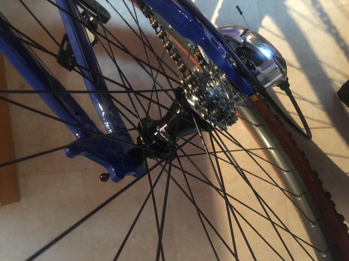

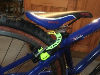

	Hey Cosmic. The cassette is literally a joblot of Shimano HG/IG 6-7-8spd rings with alloy spacers in between them. You can buy a brand new HG cassette of eBay for not a lot. Just remove the 4 long grub screws holding the larger rings together and ditch anything larger that 18T. I put an extra 11T on mine so I have some road speed when I go out with the wife n kids on a bike ride. The gear spacers used on 6-8spd cassettes are all the same size so get the right thickness spacers and don't miss any gear sizes otherwise it won't shift. Then just space it up so the cassette lockring goes on properly and set your rear mech deadstops accordingly, et voila.

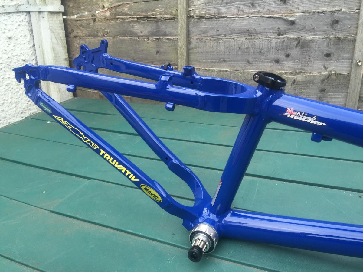

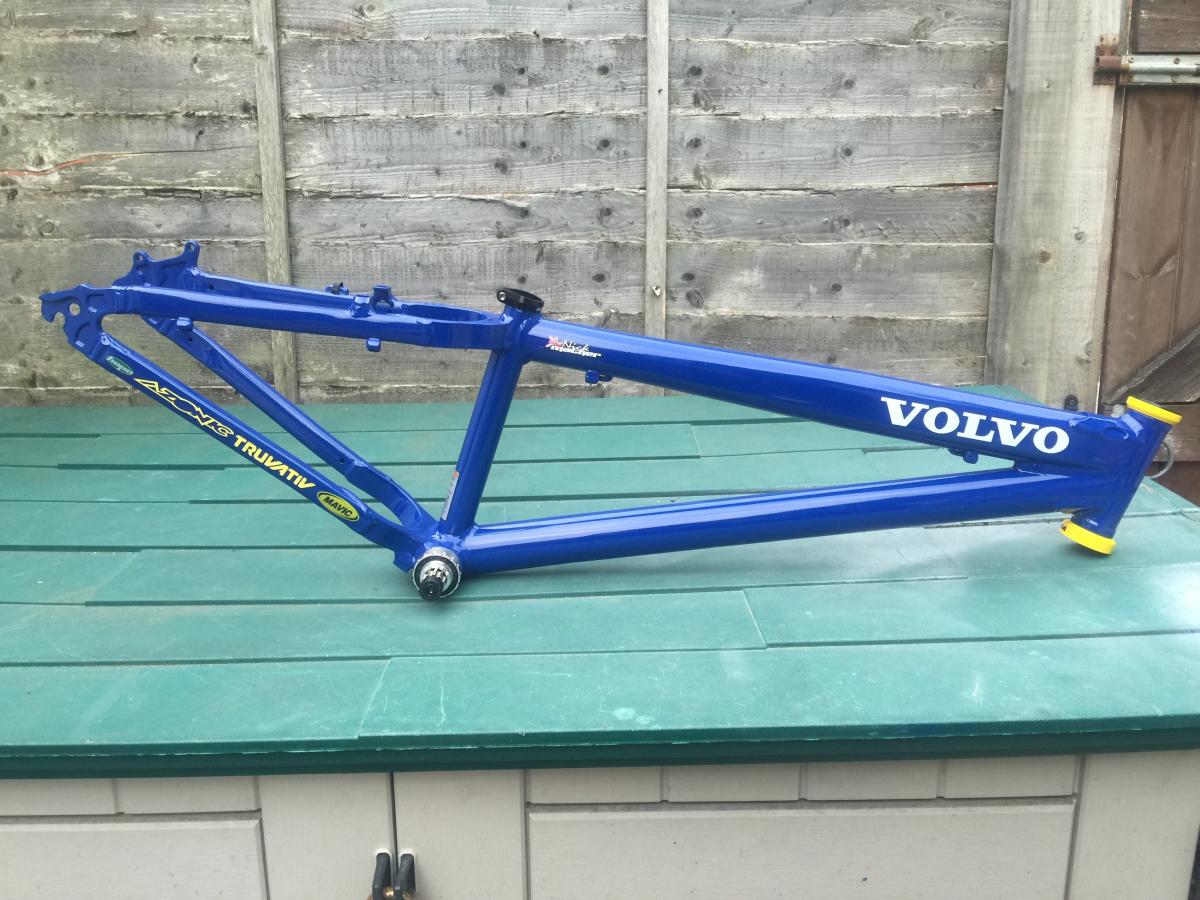

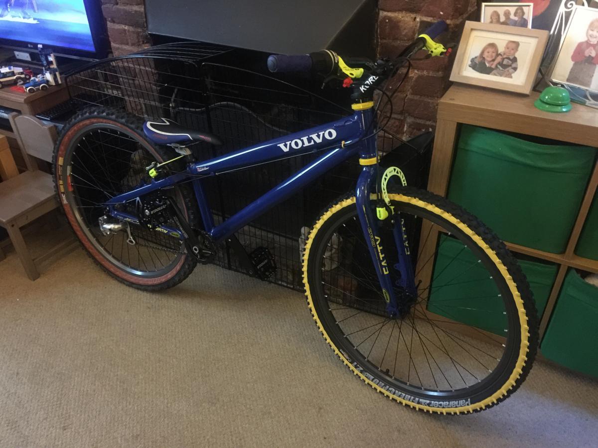

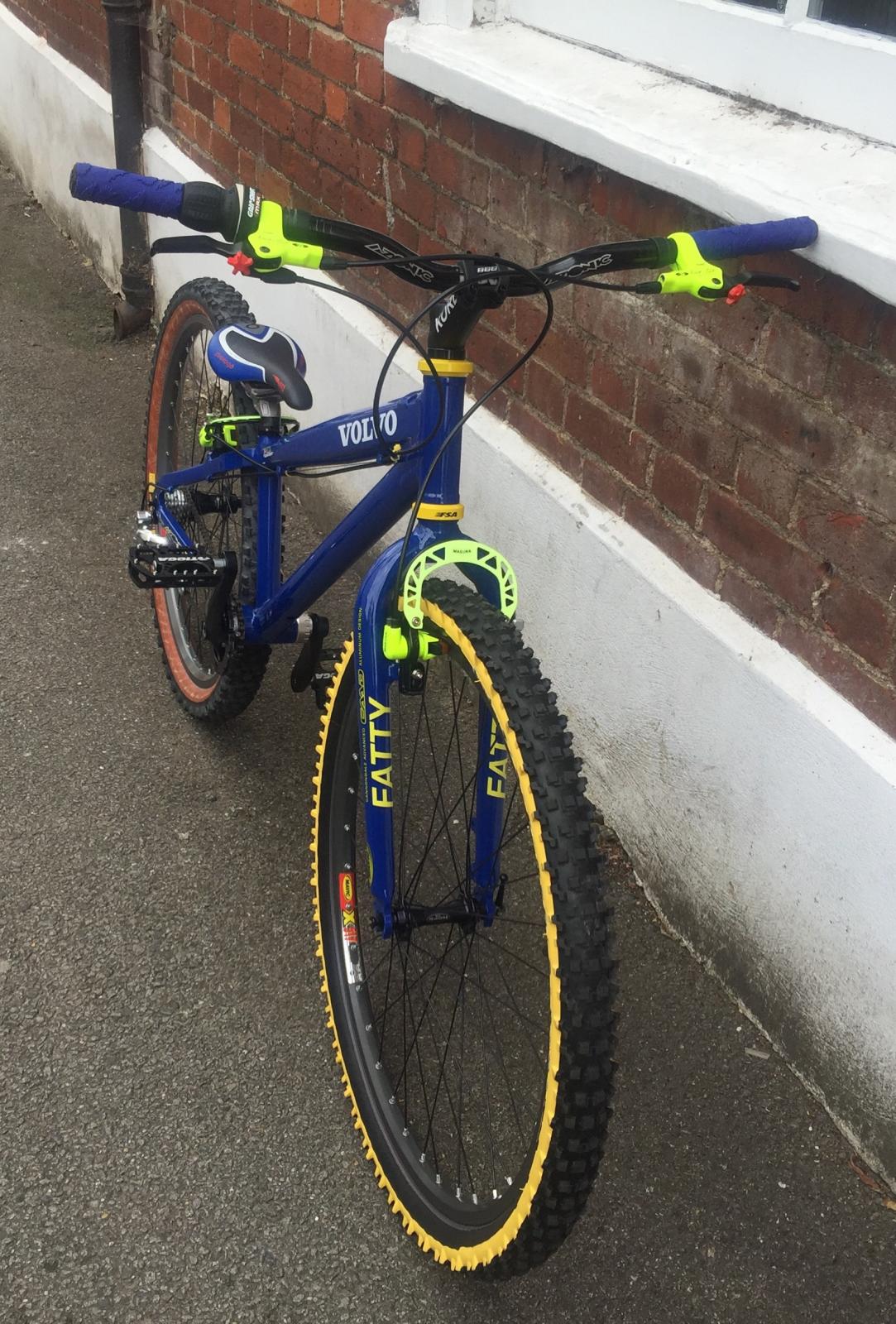

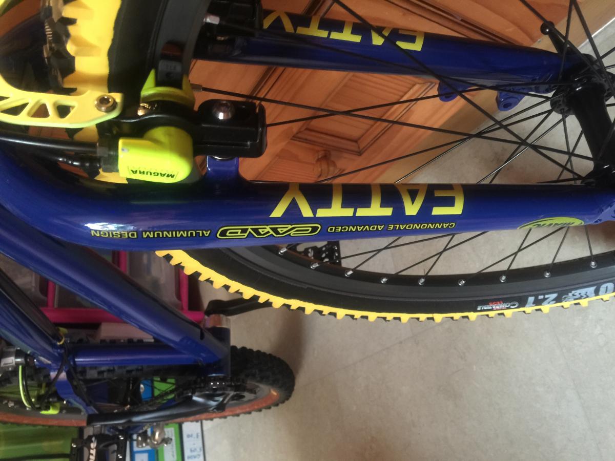

	D'you know what. I did originally want Cannondale decals with the correct associated decals but again in good taste, I didn't want any logos that weren't on the bike. My mate is doing me Cannondale font Base Bikes logos for the seat tube and down tube. Good shout on the Sachs not sram shifter btw. I'd forgotten he used Sachs. So chuffed with the overall finish though. Looks sweet. I can't believe it's been 14yrs since I've ridden. Used to ride at Essex Bike Trial Club in the late 90's with Ian Cooper and the Tongue's. My son is 4 and is bike/motorbike nuts so I wanted to be able to blast around with him. He's been off stabilizers for a year so he goes faster than me now! Lol. I really wanted a retro, nostalgic steed!

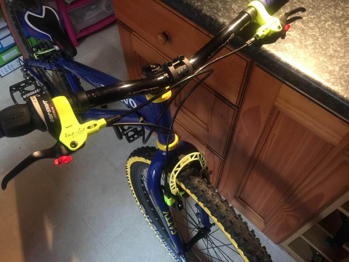

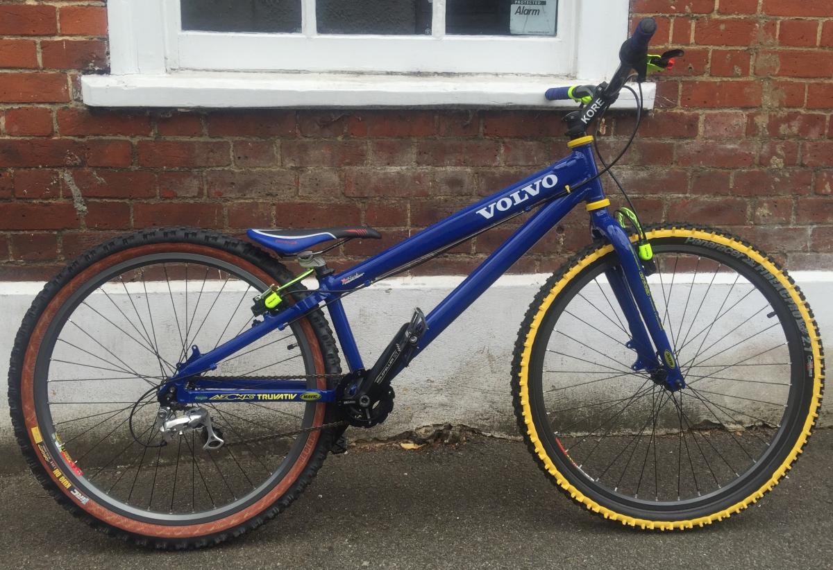

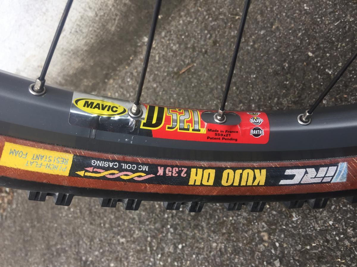

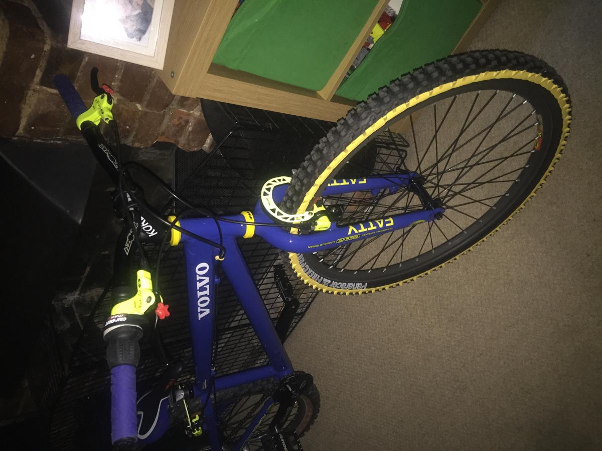

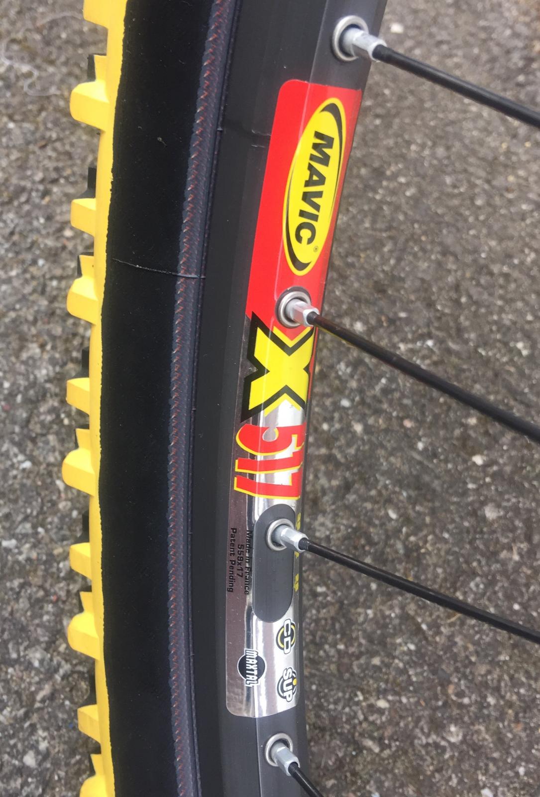

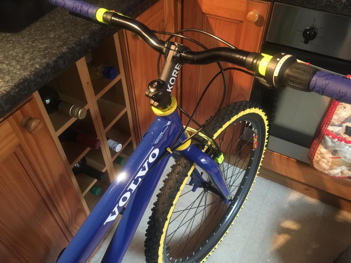

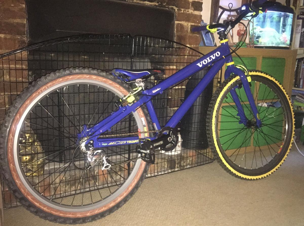

	Ashton tribute. (Just waiting on Base Bikes TA26 cut vinyl in Cannondale font for the down tube) 2002 Base Bikes TA26 Frame (shot blasted, painted & laquered in Peugeot EJG Blue). Vintage Cannondale Fatty R Forks. Vintage FSA Orbit XLII Headset Vintage Magura HS33 Racelines Truvativ Howitzer External BB. Modified Truvativ Holzfeller OCT hollow Cranks. Truvativ Knurled Bashring Middleburn 22T Sprocket Vintage Shimano 105 short cage Mech. Custom Trials Cassette 11-17T. sram Gripshift 7spd shifter. Rebadged BBB 90mm/30deg stem. Vintage Azonic bars. Titec Carbon/Titanium xc Seatpost Prologo Carbon/Titanium Saddle. Ally/Titanium clamp Vintage(new) Mavic D521 on Hope Sport 36hole DT Spokes/Brass nipples. IRC Kujo DH 2.35. Titanium QR Vintage(new) Mavic X517 on Hope Sport 36hole DT Spokes/Ally nipples. Panaracer FireXC Pro 2.1. Titanium QR All Titanium fasteners. Sweet!!

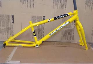

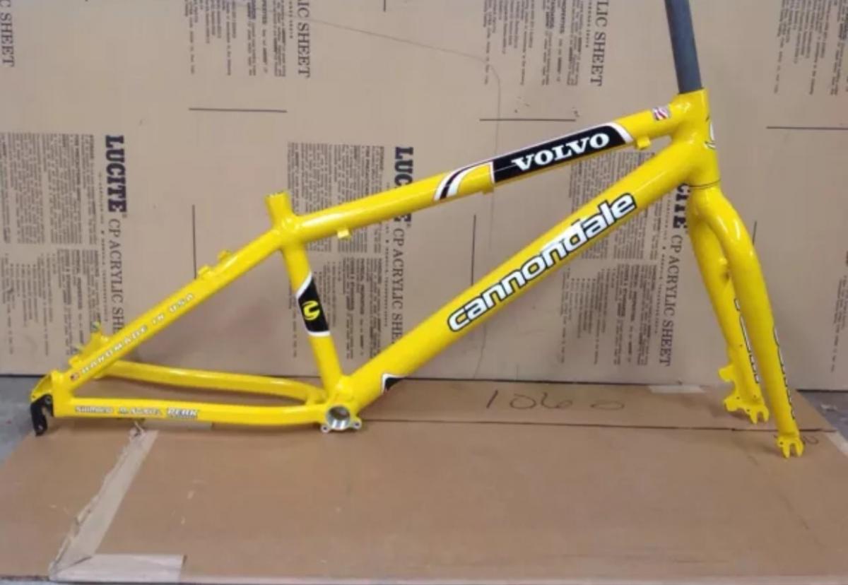

	Just found this in the States! It appears to be an Ashton custom but I never saw it in yellow or with Martyn's custom geometry. Anyone know when this was sold?
