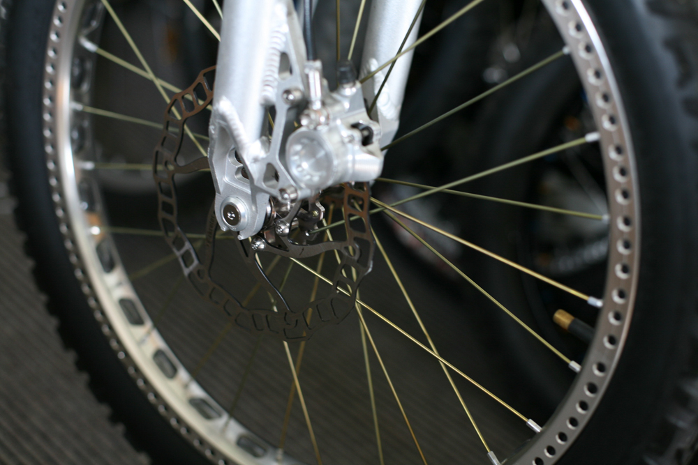

	Rockman Björn frame, rockman forks, bar, stem, rims, cranks, front hub. Reset ti bb, chris king headset and rear hub, hope tech rear brake, mono trial carbon in front, rainbow coloured ti spokes in rear and (soon) in front wheel. ti and alu bolts throughout. This bike is about 180 grams more than my previous bike (haven't built front wheel with ti spokes yet and 145 grams heavier frame) so that should be around 7,2 kgs

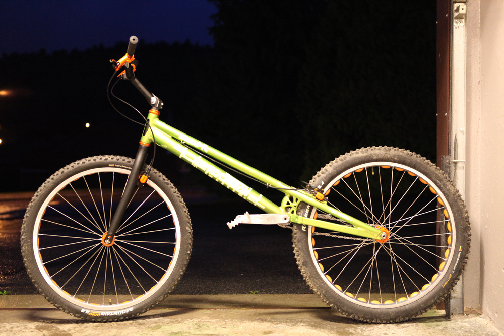

	New ride! Rockman Slate XL frame and parts except for some chris king parts, ti and alu bolts, bladed spokes etc Big thanks to Rockman bikes and Tarty for hooking me up as always! more pics on : http://www.observedtrials.net/vb/showthread.php?t=43971

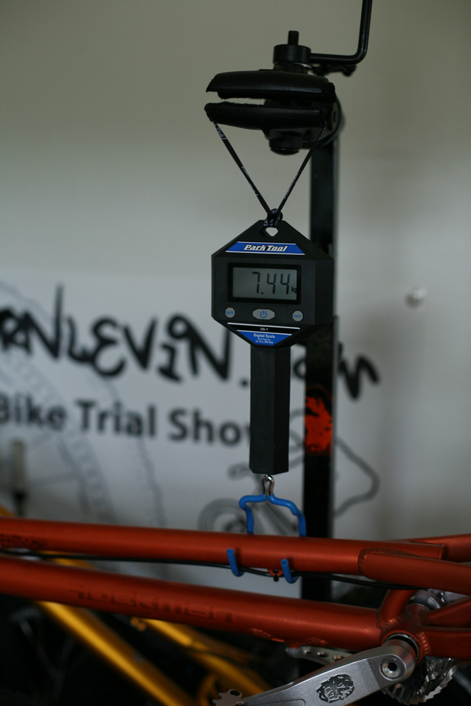

	New ride! Rockman Björn frame and parts except for some chris king parts, ti and alu bolts and spokes and hope brakes. Big thanks to Rockman bikes and Tarty for hooking me up as always! have moore pics but pic uploader is giving me trouble:( http://www.observedtrials.net/vb/showthread.php?p=639735#post639735

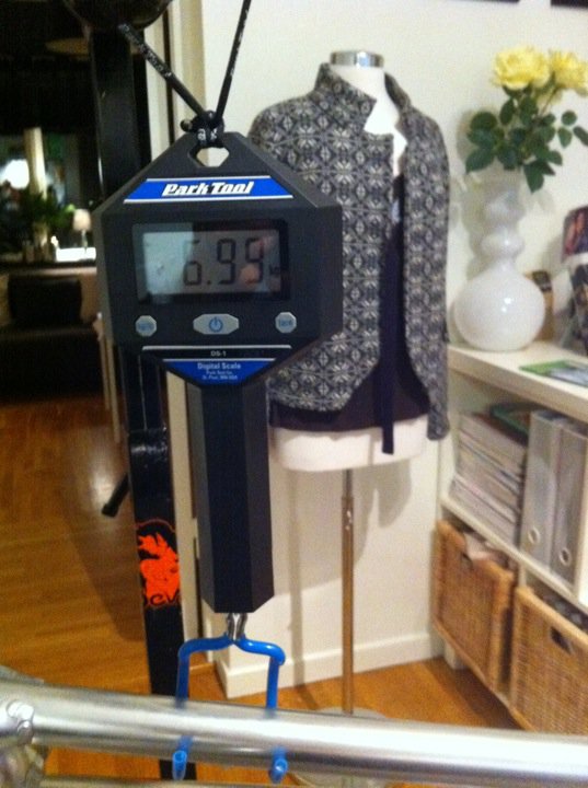

	Would like to think that there is more to say, since i just built myself a bike based on a frame that is +200 grams lighter than the ozonys curve V2, with similar or better components and mine is 6.99 ( i also use the park tools scale ) From what i can see the only thing i got on that is heavier is the rockman 165mm cranks and the rockman 3d 20" stem. On the definitely lighter side is a +200 gram lighter frame, the same rear tire with 60g shaved of, ti spokes witch is about 60 grams lighter than steel, only tt ti half bash so no bashplate +110 gram, lighter rear disc... that´s like 430 grams in the lighter side, vs about 60 grams on the heavier side.. so where is the other 400 grams taken from? So feel free to explain this to me?

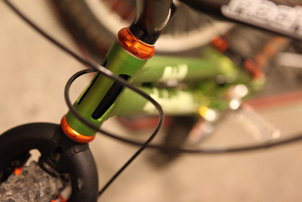

	borrowed the bb from my stock and put the race wheels on:) (frame color is not final, testing out a new anodizing finish and also there is tractor graphics on this frame:P ) looks neat with countersunk 15mm m6 ti bolts and alu washers. ti spokes with alu nipples. rockman hub and rims. ck bmx/disc hub in the rear.

	you will see the spec, finishing up the race wheels any day now and then getting the ti bb in a few days aswell.. but actually there is nothing super special, rockman frame, fork, stem, handlebar, rims, pedals, cranks, hope brakes, king hub in the rear and soon to be ti spokes and bb..
