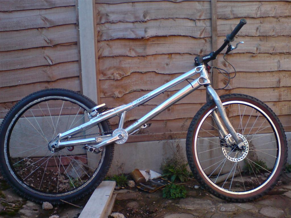

Finally about done rebuilding myself a trials bike again :)
Its good to be back on two one wheel again even though it hurt more than it used to :(
Quick spec: -
Hifi frame (thanks n.wood)
BT forks (thanks bigman)

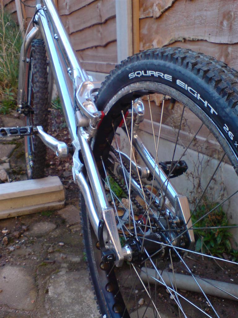

King/tryall rear wheel with 16t king cog & tioga square eight (still testing this - not had a proper ride on them yet)
Hope xc/mavic xc717 with bolt in axle and irc kujo
RS7 with heatsink bash, UN52 BB and DMR V8s
SS tensioner mounted and sprung from the fame - home made from a dmr simple tension seeker
FSA Orbit extreme sealed headset with hope headlock thingy
Kore stem with onza t-rex bars.
Water bled HS33 with heatsink cnc reds, RB lever and echo control booster (dead grind and tar on rim)
Mono trial front (thanks mafu26)
Still very rusty but its alot easier to ride than my old zoo! boa (although its a fraction heavier). Ive not decided on whether I need a taller stem yet - have ridden it with a t-rex stem and I think I prefer the feel of it with the lower kore.
Far from lightweight at about 10.8kg but I wasnt trying to make it light :D
Just got to get some strength back into my arms and learn how to ride again :(
