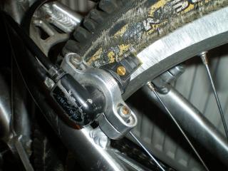

Here's a pic of the bodged pad trick.
I ran this for about two or three weeks while I was waiting for my Echo rim. ( Had been running a D521 on my Echo Pure). I didn't bother me using this for a while as I can't exactly do gaps and such yet. But still, a psycholist says, you are better getting a wider rim. (Y)
