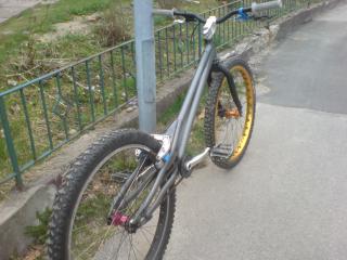

Well so i got my 24seven trial now, getting a bit tired of it actually, would like to ride an inspired instead, i like the bmxy stuff.
My current setup;
24seven frame
FSA headset.
A random bottom bracket (came with the frame, anybody knows the specs? 68mm?)
Hope mono trial brake front.
Hs33 with RB lever rear.
Amoeba stem.
Easton EA70 bar.
Middleburn cranks.
Rear wheel;
Chris King BMX hub
Alex dx32.
Front Wheel;
GU Hub
Gu rim (i think), drilled.
It`s pretty hard getting anything sold in sweden right now so i`m just buying an inspired frame and moving over the parts.
What parts can i keep from my current setup?
I was planning on this;
Inspired fourplay frame (new)
24seven fork
Amoeba stem / EA70 Bar
Front wheel;
Gu Hub
Trialtech 24" rim (new)
Rear wheel;
Hugi 240 Hub (got one spare in the garage)
Trialtech 24" rim.(new)
Inspired seatpost and seat(new)
Hs33 and mono trial brake.
Middleburn cranks (Anybody know a good size for BB? Would be really nice if i could use the current one on the 24seven)
A random chain.
