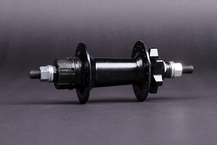

the problem is that i dont know if i can set a trial Rear Sprocket on that rear hub ...
and i dont think a single speed rear hob with that big size is available

those giant hubs are these as standard. you can unscrew the lock ring and fit any shimano cassette spocket to it.
i would use a halo fat foot cog u would need a 23t cog thou.
surely do a 22T cog
http://www.ison-distribution.com/english/product.php?part=CSSUS13
well i think tahts what im looking for .. thank you
