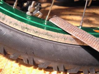

This is for those who don't have a grinder or just wants to do like me.
I use a rasp, it makes wider groves then the grinder and that makes it easier for water and dirt to get away from the contact surface so you get a good grip in wet and muddy conditions.
I use tryalls hard pads made for rough grinded rims and it works great.
The grind that's on the pic is almost a year old and it still works fine, the pads are as old as the grind and they haven't worn much.
edit: a brake booster is also makes a big difference.
