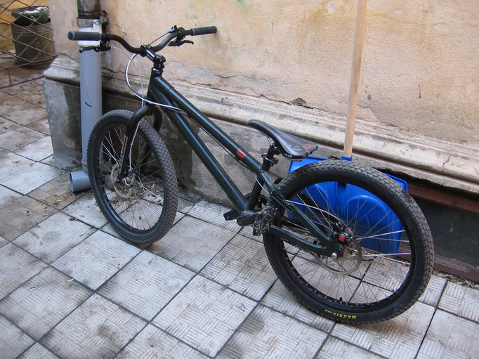

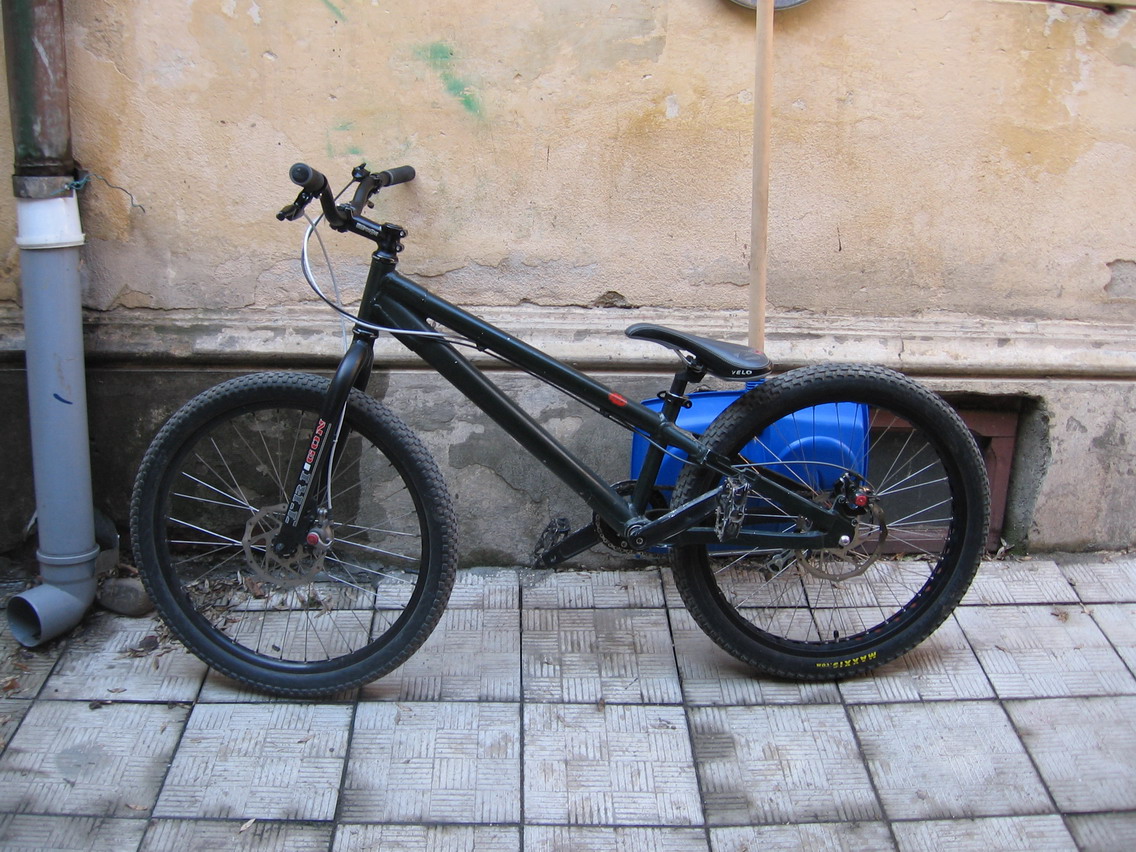

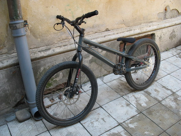

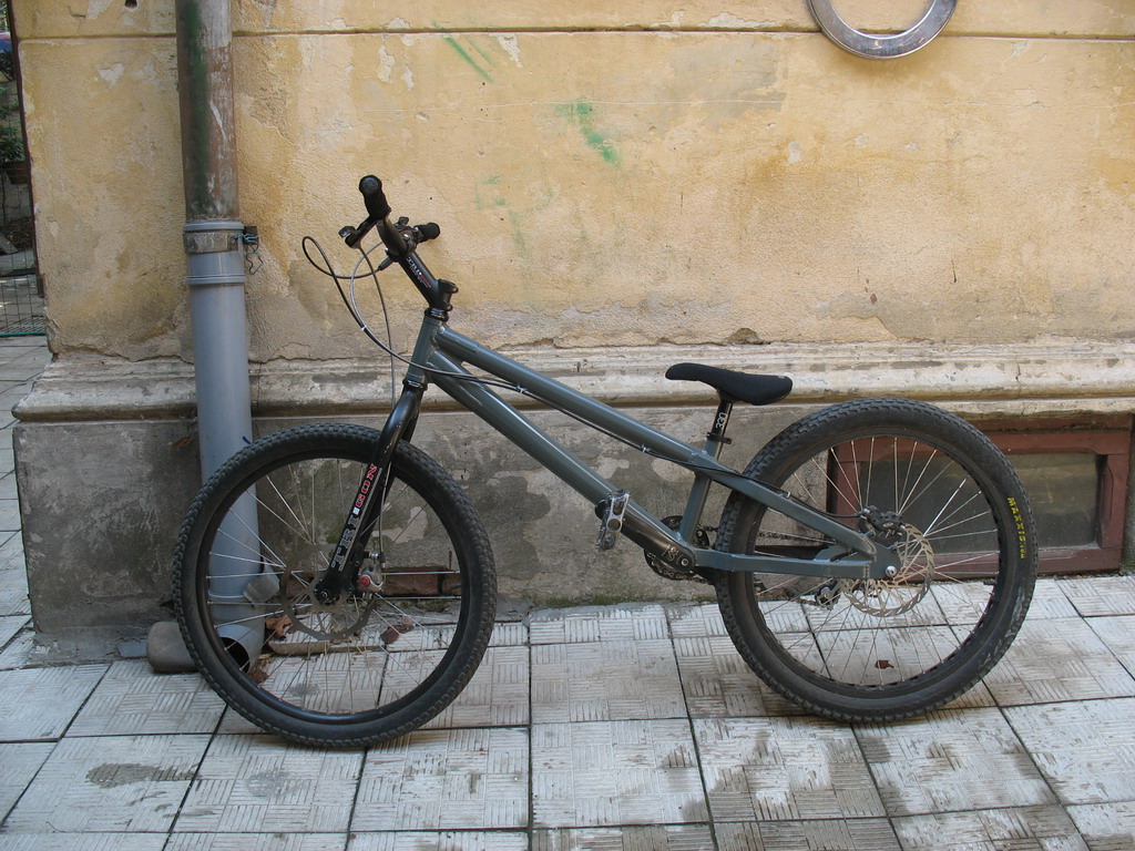

MY BIKE: frame: mielec custom, bt raven 5.5 disc mount, geo: WB 1030, CS 385, BB +35 HA: less than i'd like it.. front wheel: novatec hub + singletrack rim + k-rad tyre rear wheel: hope pro trials + kris holm muni rim (vee tracks painted black) + holy roller tyre brakes: bb7 front, avid code 5 rear (way better than bb7, don't know about hope..) cranks: FSA v-drive x-treme 165mm seat + seatpost : kink pivotal home-made tensioner (read about it here: http://www.trials-forum.co.uk/forum/index....owtopic=127832) chain: KMC z610 (3/32) handlebar: truvativ holzfeller (2"rise) grips: stripped lock-ons with 2 layers of grip tape (best grips i ever owned!! they're comfortable riding gloveless and are grippy as hell ) gear ratio: 24/19 FRIENDS BIKE: pretty much the same parts.. mielec frame sd7 vees kcnc bear bone 2" riserbar sora derr shimano sis shifter : ) alexrims dx32 rear rim gear ratio: 22/18,15,13 about 11kg each hope you liked'em : )

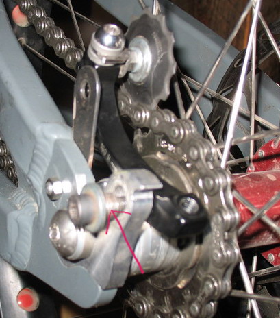

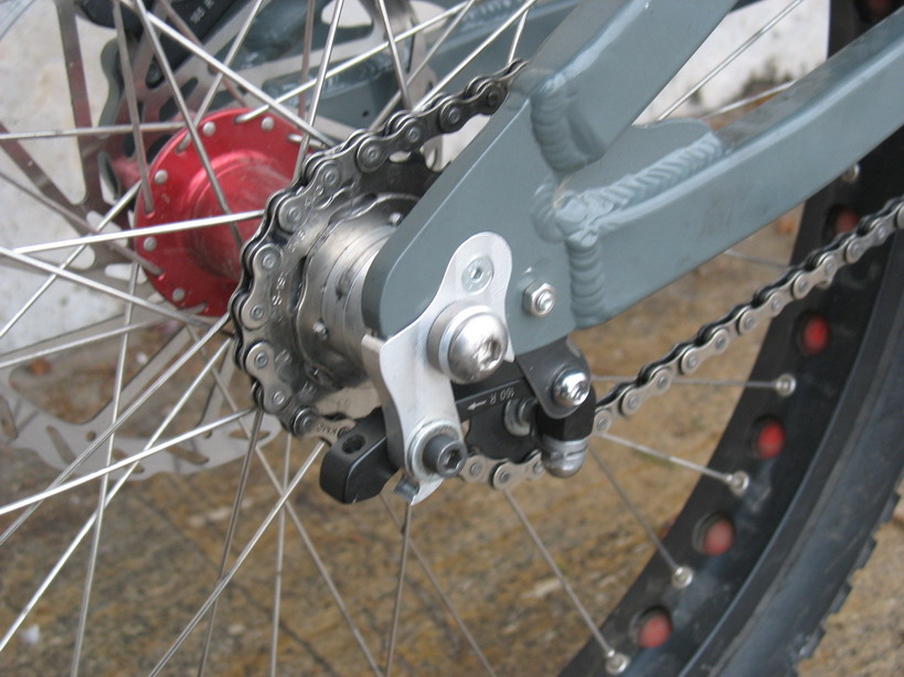

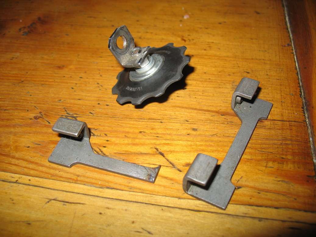

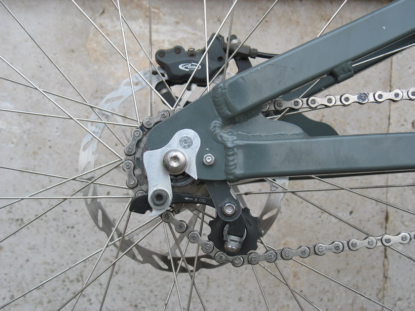

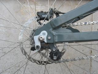

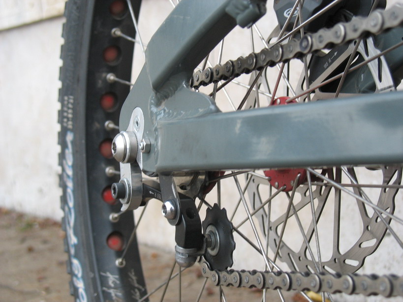

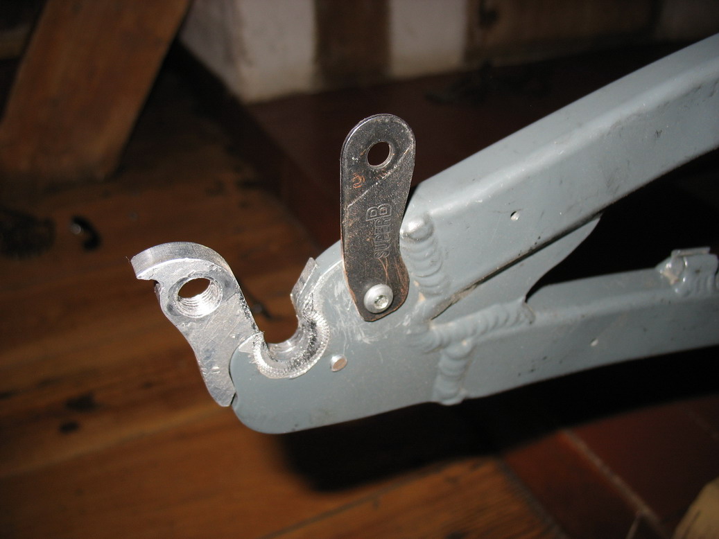

Hi! i recently went sigle speed (and it feels great, although i was quite reluctant about it), and i didn't want to pay as much as a derailleur for a shitty tensioner, so i struggled to come up with an idea to make my own, so here it is.. i used: - a disc brake adapter (rear 160 avid bb7) - a metal plate from a cheap multi-allen-key-tool (or whatever you call one of these: http://www.bikexpert.ro/catalog/images/842.jpg ) (yes, i drilled a small hole in the frame - shitmano jockey wheel - part of a hs33 braze-on mount - spacer made of the lower part of a a v-brake mount (to center the bolt in the hanger hole. threads are stripped, since the pace of the vee mount and derailleur bolt are different) ta-dah: full bike pics: http://www.trials-forum.co.uk/forum/index....howtopic=127833
