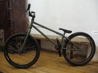

got the trialtech bar and it has pretty much the same geometry as the azonic 2.5' double wall here it is on the bike

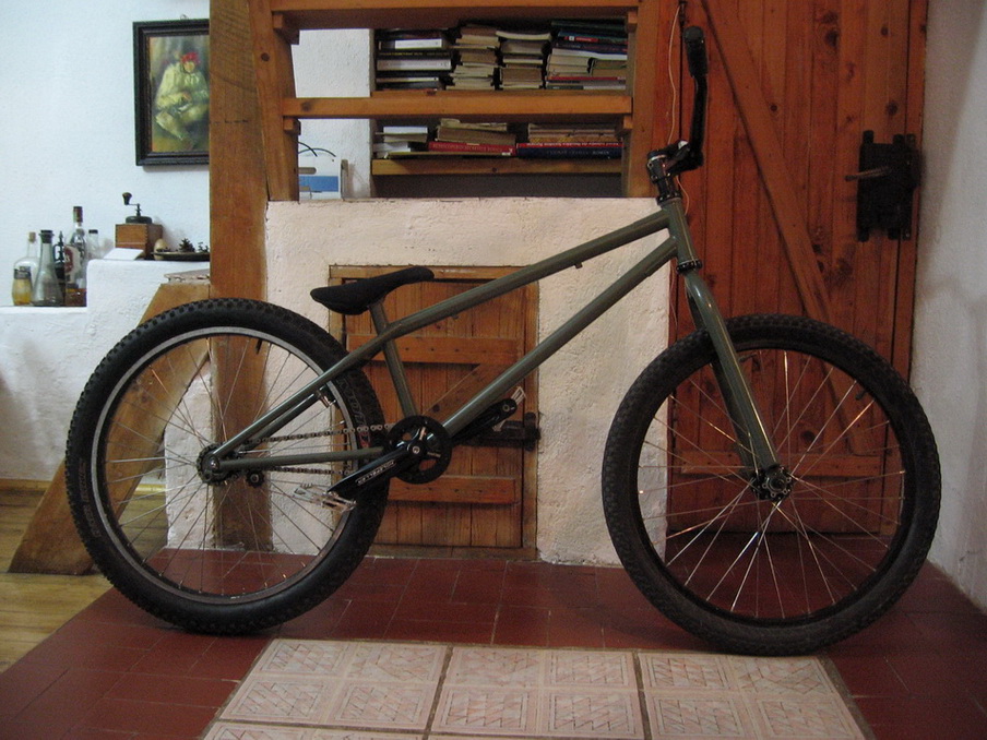

MEH, i'll put some more pics tomorrow, until then, here it is: oh, my, double post! (i need the attachments...) BRAKED: BRAKELESS:

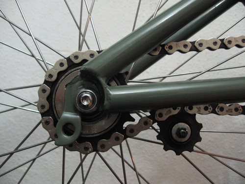

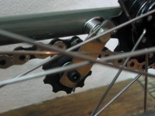

bike is pretty much finished (just needs some wheel truing and such) i'll make some pics tomorrow, since my camera doesn't do so good in artificial light. until then, here's how i resoled the tension problem: first i got a tensioner similar to this one in order to find out it doesn't fit (the fixed arm is too short to accomodate 18T). fortunatelly i can return it. i then put a half link on and thought of ways to tension it. the slack was too big to use a spoke, so i made this: the metal plate can move around the axis, because the bolt that goes into the vee mount that is on the chainstay is tightened by the nut that seats between the mount and the plate it doesn't show in the pics but i have about 4 mm of clearance between the chain and the chainstay seems to work... only went out to test it for a few minutes..

bummer. didn't have much luck with the chain length. it's slack as hell. i would need a double wheel tensioner to accommodate this length. if i put a half-link in, i will probably get away with a single wheel tensioner, but i don't think a spoke tensioner would do the trick... damn it.
