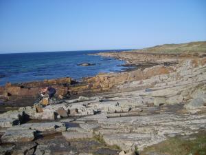

  15. My missus got a few pics of me riding by the sea. Thought I'd put them up to show everyone my little riding spot. It's a place called Hopeman, near Elgin in the north of Scotland, between Aberdeen and Inverness. I'm not doing any big stuff, just messing around.

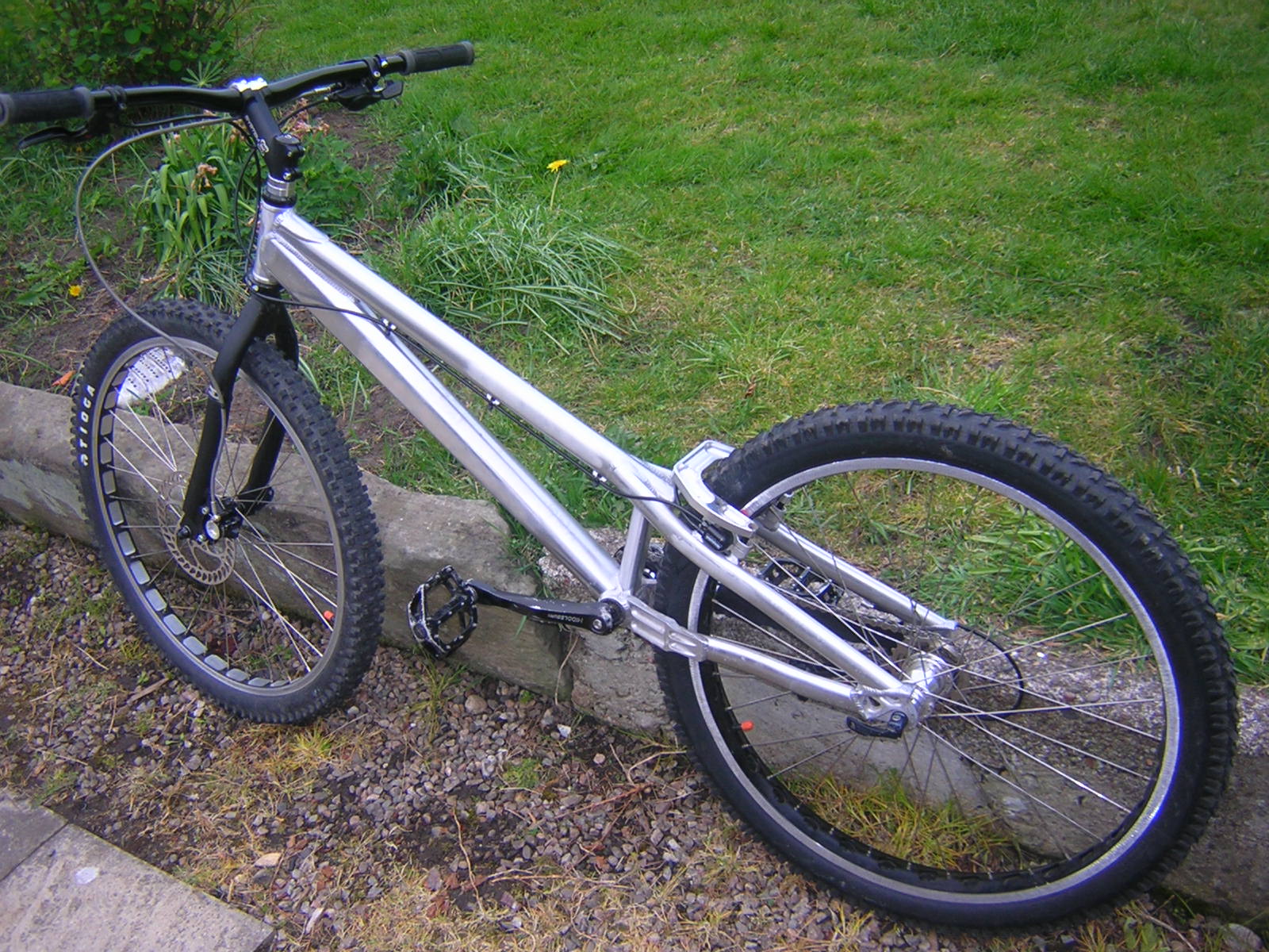

  17. Yeah I think the stem looks s**t too. Only problem is the geo of it works well for me. I do have a nice 0 rise Echo stem which I might fit once my riding improves a bit. Have to see what happens.

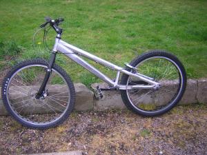

  18. Just thought I'd put up a couple of pics of the noble steed. It's mainly second hand bits but i'm not too fussed at the moment cos I'm just riding it hard as I'm getting used to trials again after about five years off. Frame-Echo Control 04 Forks-Echo 06 Cranks-Middleburns Rear Wheel-Chris King ISO on a Try all drilled rim with a maxxis CC trye Front wheel-Echo hub and rim with a Tioga 2.1 Rear Brake-Magura HS33 Front Brake-Hope Mono Trial Bars-Adamant risers I love the plain look. No stickers and it doesn't look at all pimped. It's well used and abused and looks it too but it does the job and does it well. It may not be to everyones taste but suits me fine. Cheers for looking, Sutty
