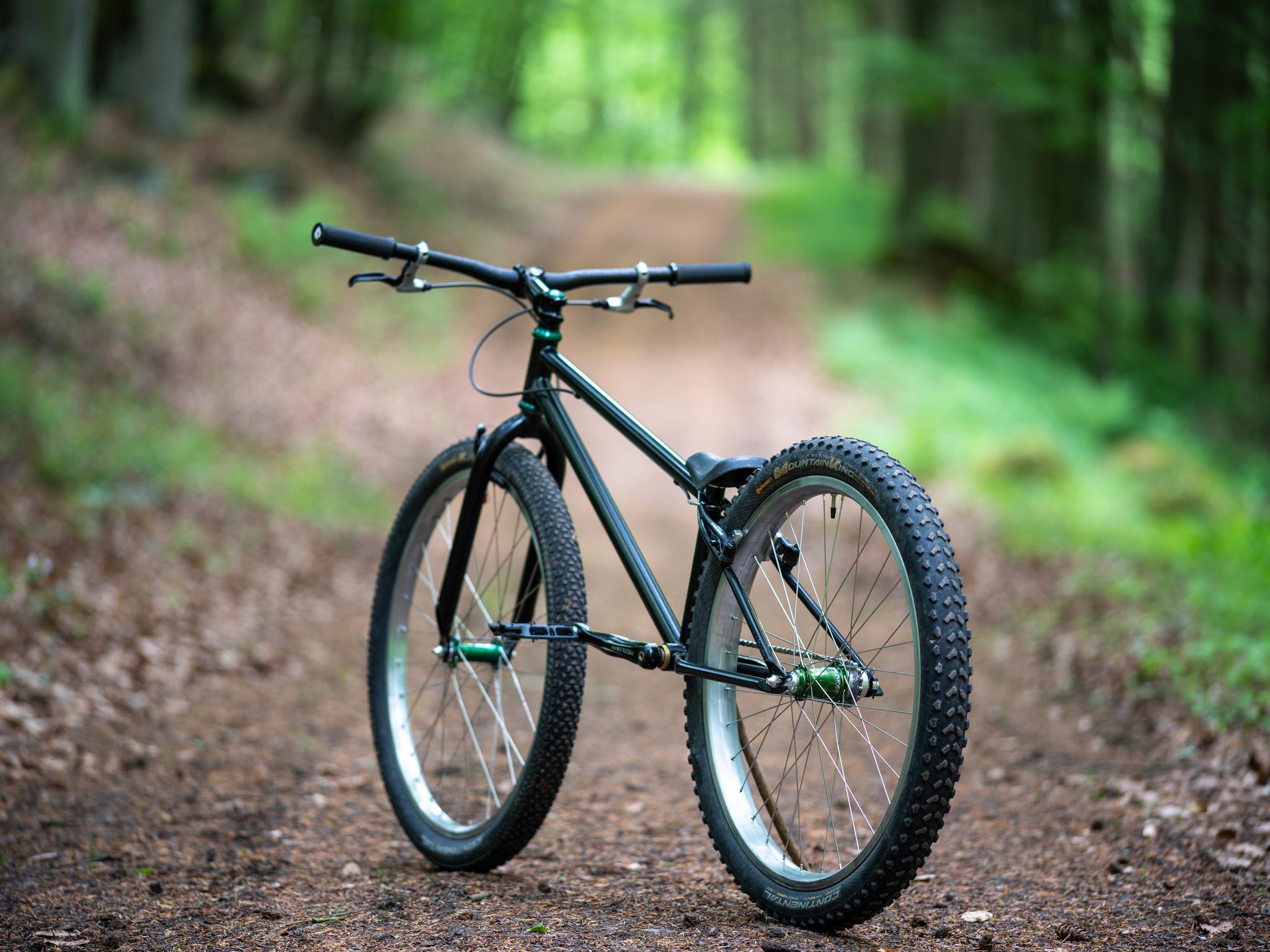

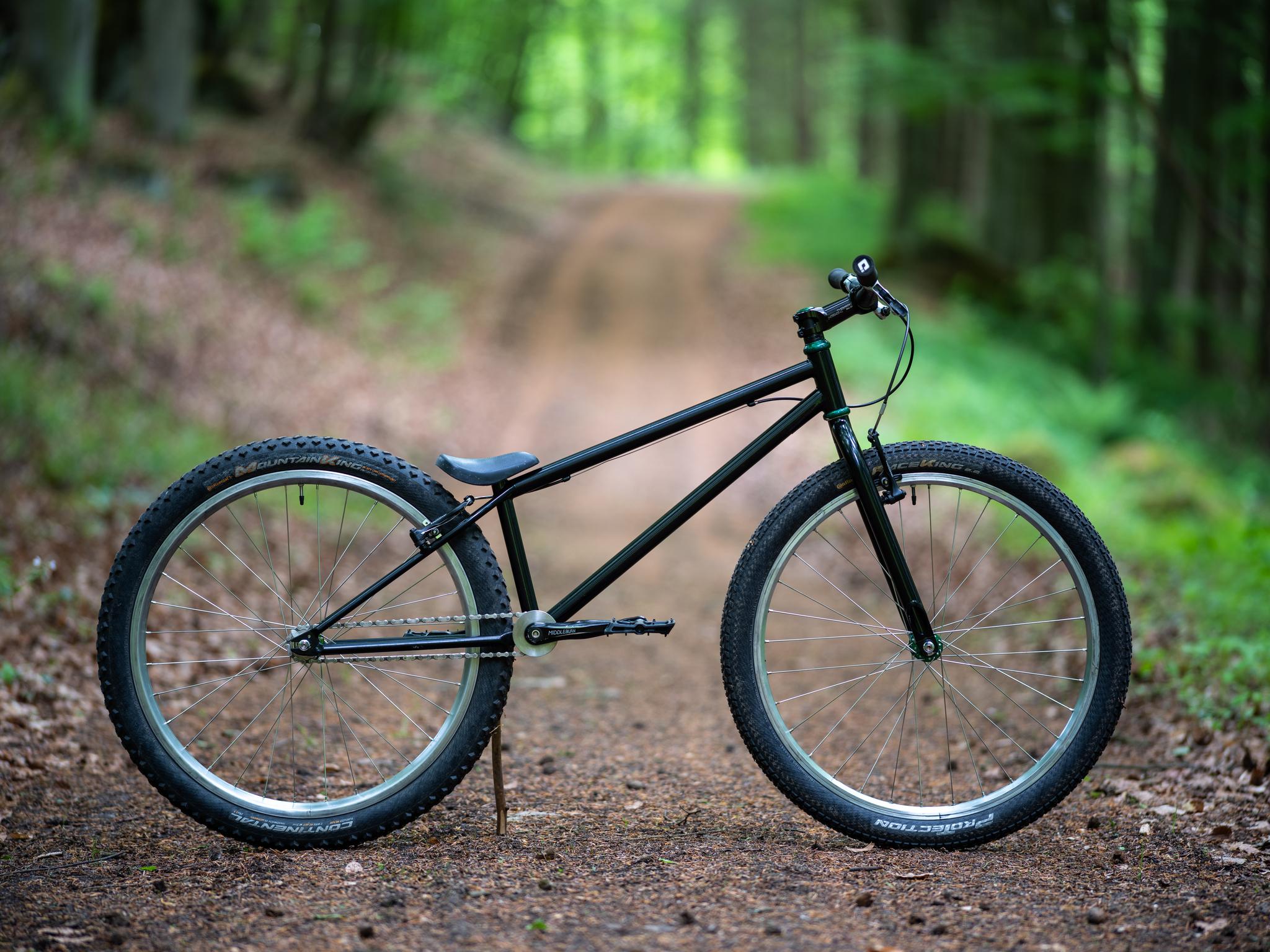

  2. Probably finished for a while. Frame: Franta Mrázek, 1020 wb, 375 cs, +20 bb and 73° ha Fork: Inspired Steel fork, A-C 398mm, pivots for 26" and without disc mount Headset: Chris King NoThreadSet Hubs: Chris King Classic Rims: Trailtech Carthy Signature rear and Dartmoor Fortress front Spokes: 2-1.8-2 DT Swiss and Sapim Crank: Middleburn RS7 with titanium Super Pro Trial bash BB: Race Face Signature DH Pedals: HT PA03A Stem: Thomson Elite X4 100x10 Handlebar: Race Face Atlas ½“ 720mm Saddle: Cionlli Brakes: Shimano Deore brake arms with Avid FR5 levers Tires: Conti Race King 2.2" Protection, Mountain King 2.4" Protection Weight 9.9 kg
  3. hi, in may i finished this bike. i builded two years... frame - franta mrázek (home made, czech republic) steel 15 130 (4130), butted tubing, 1030; 375; +25 fork - identiti tuning custom by franta mrázek headset and hubs - chris king brake - avid fr5, avid ultimate with koolstop brake pads, nokon rims - sun rims rhyno cranks - middleburn rs7 with ti bash stem - thomson elite 100x5 bars - black sheep flatter saddle - selle italia slr xc pedals - dmr v12 mag bb - race face signature dh tyres schwalbe racing ralph 24x2,4 sorry, my english is terrible
