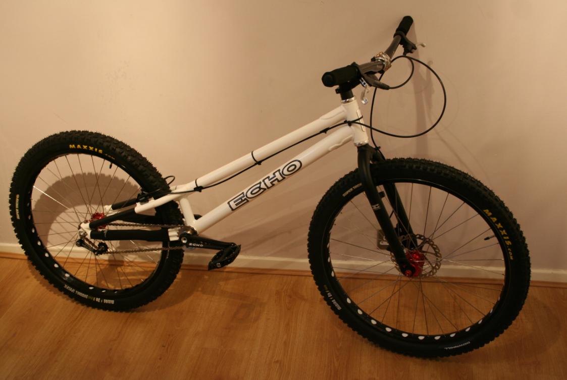

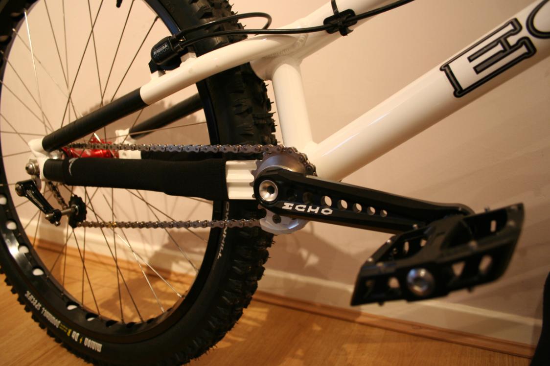

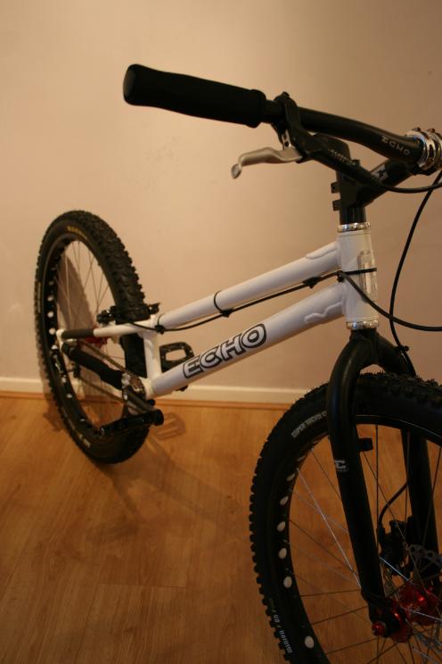

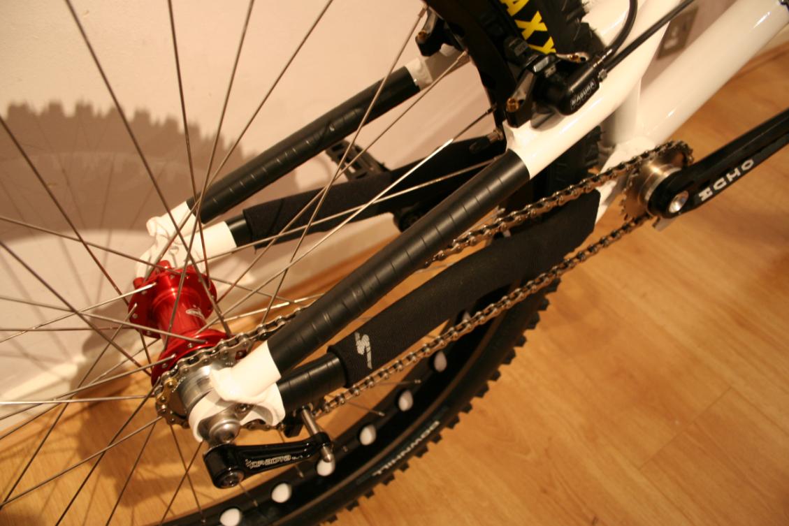

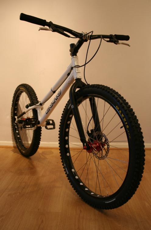

I must admit coming from a MTB background I pumped for the long frame and it certainly is that. I might as well try and keep it looking good for as long as possible hence the tape but its going to get f**ked. If it stays nice, Im either insanely good or I'm just not using it enough, i'm plumping for the latter of those two. I'm yet to cut the steerer tube down, I want to have a little play and make sure i'm happy with the height first. CW

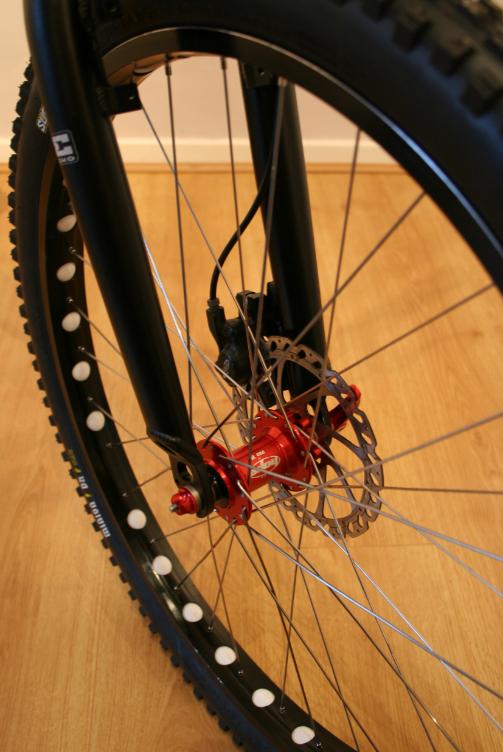

GUYS, I have finally finished my Pure and have posted some photos for you. Specification as follows: Echo Pure - Long [2009] Echo SL Headset Echo Urban forks Echo SL stem Echo risers Ritchey Foam Grips Hope Pro 2 front hub built on Echo TR rim with DT Swiss spokes Hope Pro 2 trials rear hub built on Echo TR rim with DT swiss spokes Maxxis Minnion Tyres [2.35" / 2.50"] Echo SL chainset with Echo sproket [18T] and Echo SL bashring Echo TR bottom bracket Shimano DX rear sprocket [15T] Sram PC-1 chain Magura HS11 rear brake with Echo SL brake clamps Avid Juicy 3 Front brake Revolution pedals Now that the majority of snow has melted up this way I am hoping to get this out for a good wee run in the next few days. Let me know what you think. REGARDS CALLUM
