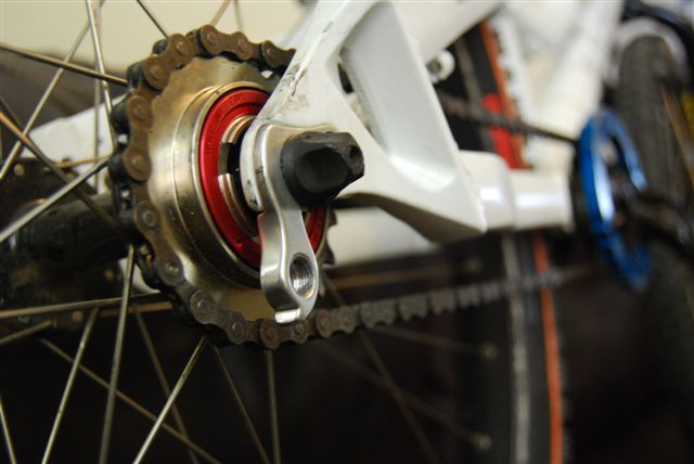

	Thanks I find them incredibly special as well ) No eccentric hub just a 20T->22T ratio that allows having no chain tensioner at all. Cheers, -E

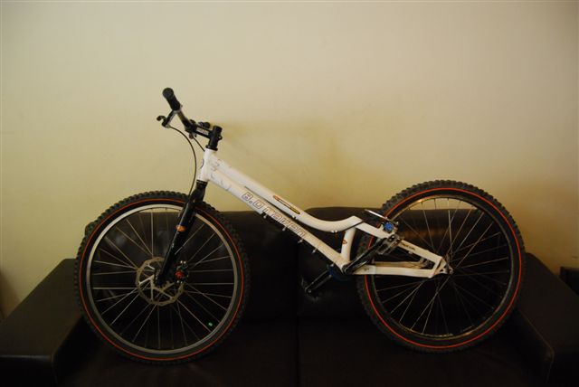

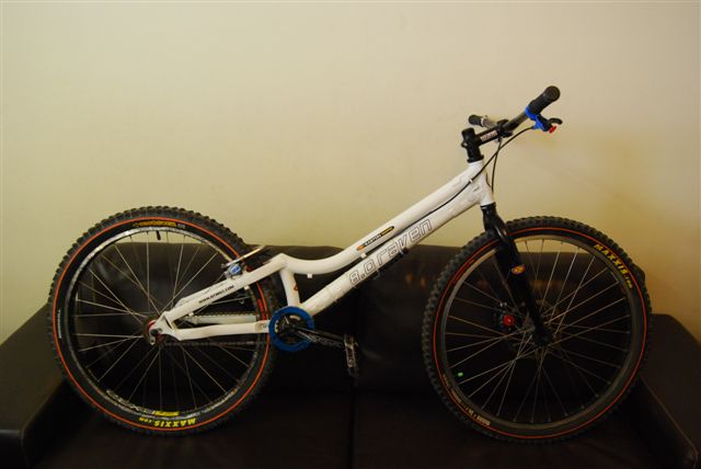

	I've finally completed my Stock 26" BT Raven 8.0 Vertical project: Frame: Stock 26" 135mm BT Raven 8.0 Vertical length: 1072mm, chain stay: 379mm, BB: +20mm Fork: Cannondale Fatty R Handlebars: Adamant Riser Bar 740mm Stem: Kore 110mm 6 deg Rear Rim: Alex DX 32 Front Rim: Rhyno Lite Rear Tire: Maxxis Mobster 2.5 Front Tire: Maxxis Minion 2.35 Rear Brake: Magura HS-33 Front Brake: Avid BB7 185mm Cranks: Truvativ Holzfeller ISIS BB: Truvativ Gigapipe DH Bashguard: Pilo 22T Rear Hub: Surly Rear Freewheel: WhiteIndustries 20T Front Chainring: MiddleBurn 22T Front Hub: Formula Booster: Echo 4 Bolts Pedals: Wellgo A52 Platform

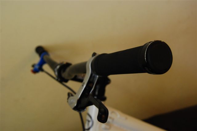

	Actaully I am using an Avid FR-5 (a very basic lever). and by the way that was one of the problems it's orignally setup very and I mean very far away from the handlebars, I've also set the "barrel" "thing" on the lever, so it would stop more at the begining of the pulll rather than later.... Thanks, -E Actaully I am using an Avid FR-5 (a very basic lever). and by the way that was one of the problems it's orignally setup very and I mean very far away from the handlebars, I've also set the "barrel" "thing" on the lever, so it would stop more at the begining of the pulll rather than later.... Thanks, -E
	No I don't think so (see below): A little bit of tuning and then some more tuning and it seems like it's already much better. Thanks, -E Yes, in fact that was one of the problems; the other one was the simple fact that the lever it self was too far away from the handlebars, I've fixed that as well and voila! Already much better. however, I've been told it can take up to a few dozens of kilometers for the system to "get the grip". Thanks, -E Actually that sound is music to my ears; I beleive that it's our sonic TradeMark as Trials riders ) and that is why I wouldn't replace the rear brake to disc. However I will probably stay with a front BB7; I have managed to fix the problem... and it is indeed much better as a front brake. -E Actaully I am using an Avid FR-5 (a very basic lever). and by the way that was one of the problems it's orignally setup very and I mean very far away from the handlebars, I've also set the "barrel" "thing" on the lever, so it would stop more at the begining of the pulll rather than later.... Thanks, -E

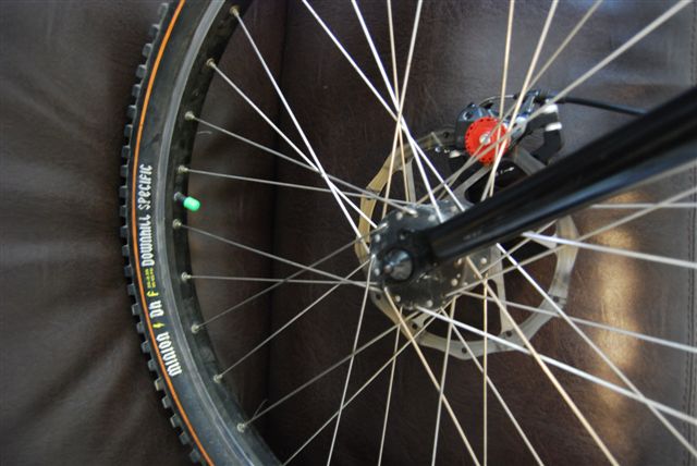

	In fact they are almost brand new: less than 1 months maybe that's the problem? (they don't have the grip yet). I find it hard to beleive it's dirt because I do not do natural and they are almost brand new. Thanks, -Eran Actually I have set the pads using the adjustment dials (counter clockwise if I am not mistaking). but they still feel a bit weak and mushy. Any advice? -Eran
	I had Magura HS33 installed but they didn't feel right so I switched to Avid BB7 Disc Brake - Mechanical 185-203mm '07. The Avid feel much "mushier" so now I am seriously considering changing back to the "Maggies". I would sure like to hear your comments guys. Thanks, -Eran

My Stock 26" 135mm Bt Raven 8.0 Vertical

The geometry is perfect in my opinion; it really resembles the Echo Control: L: 1072mm C: 379mm BB: 20mm -Eran
