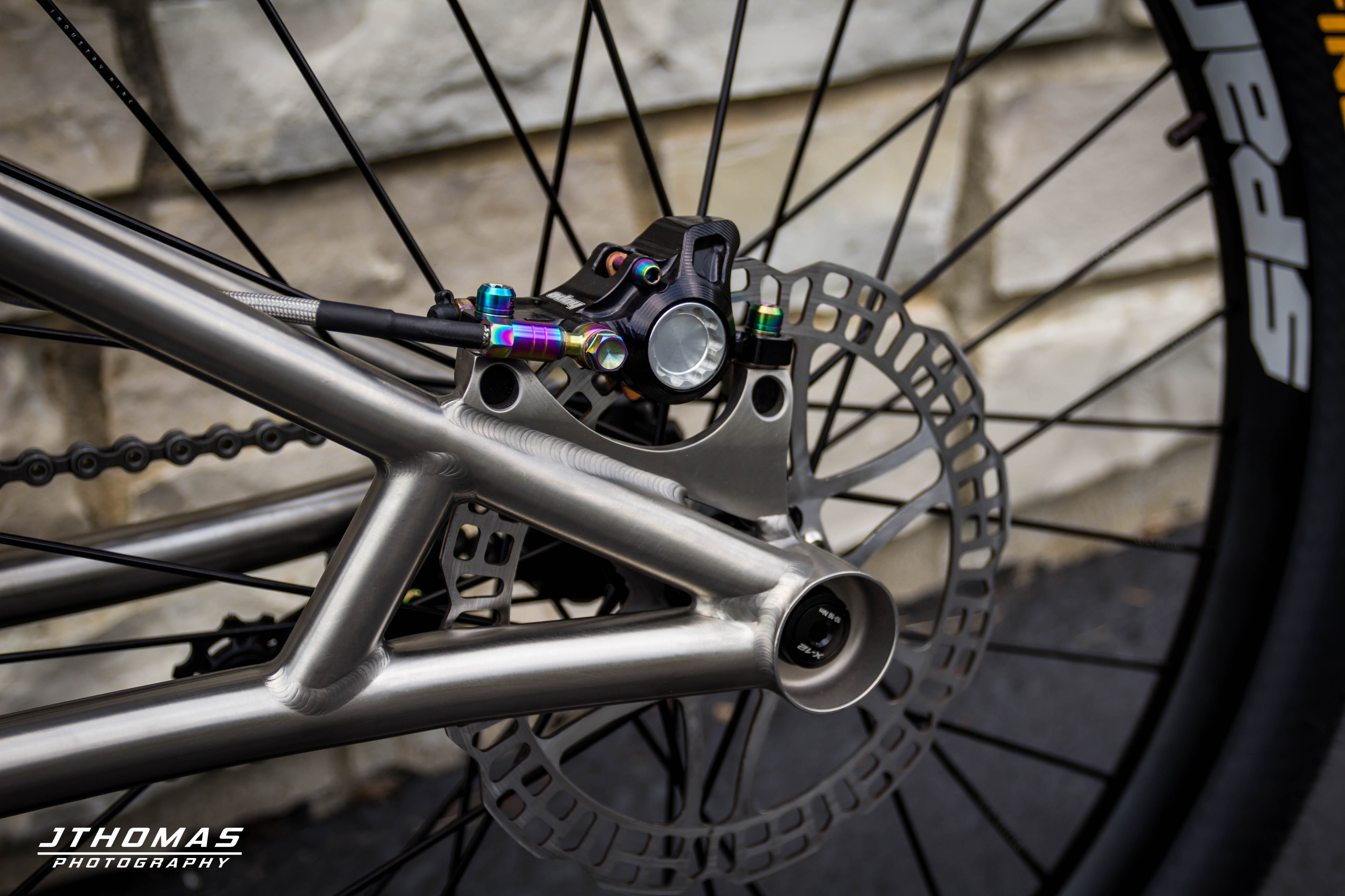

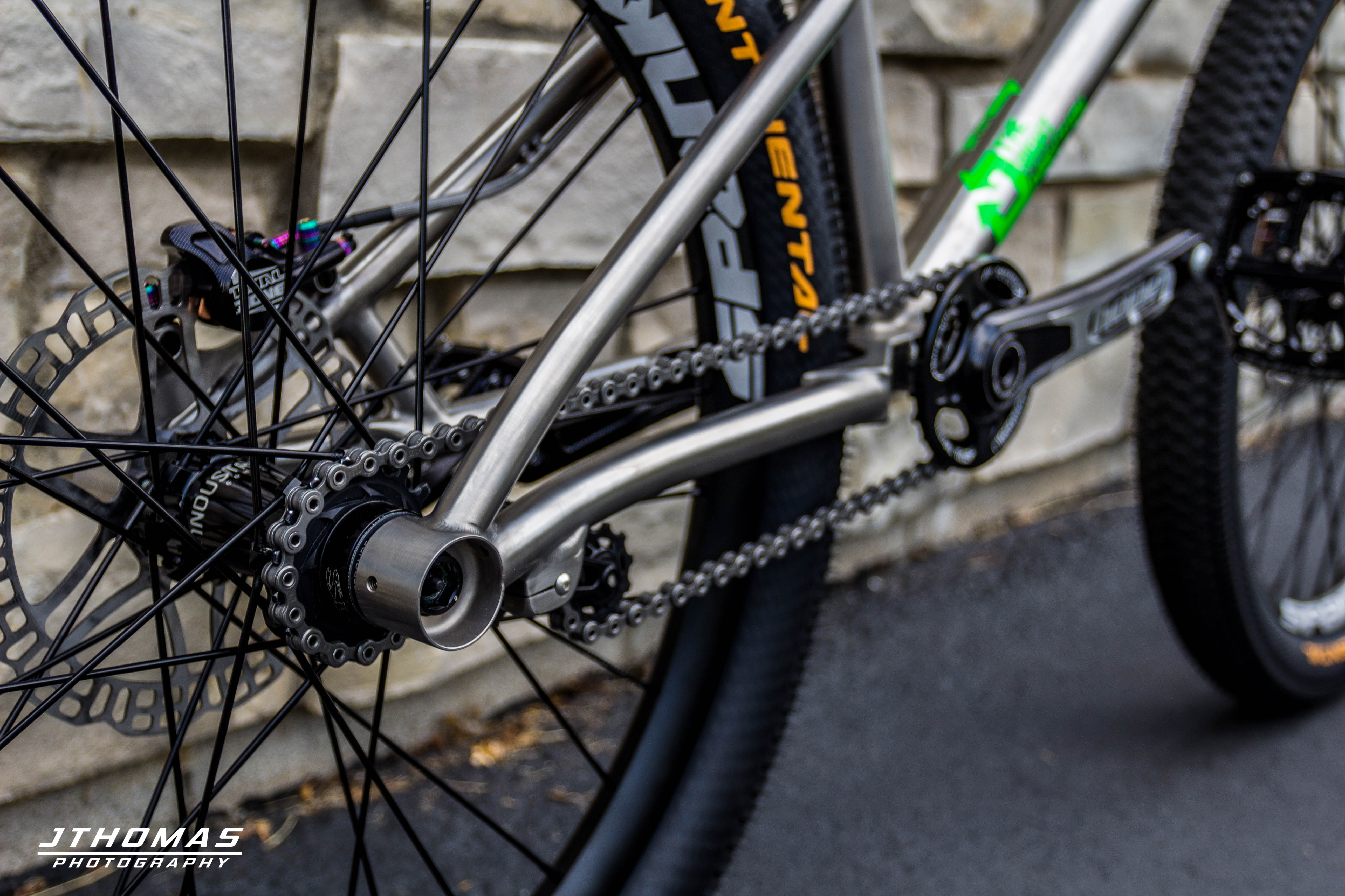

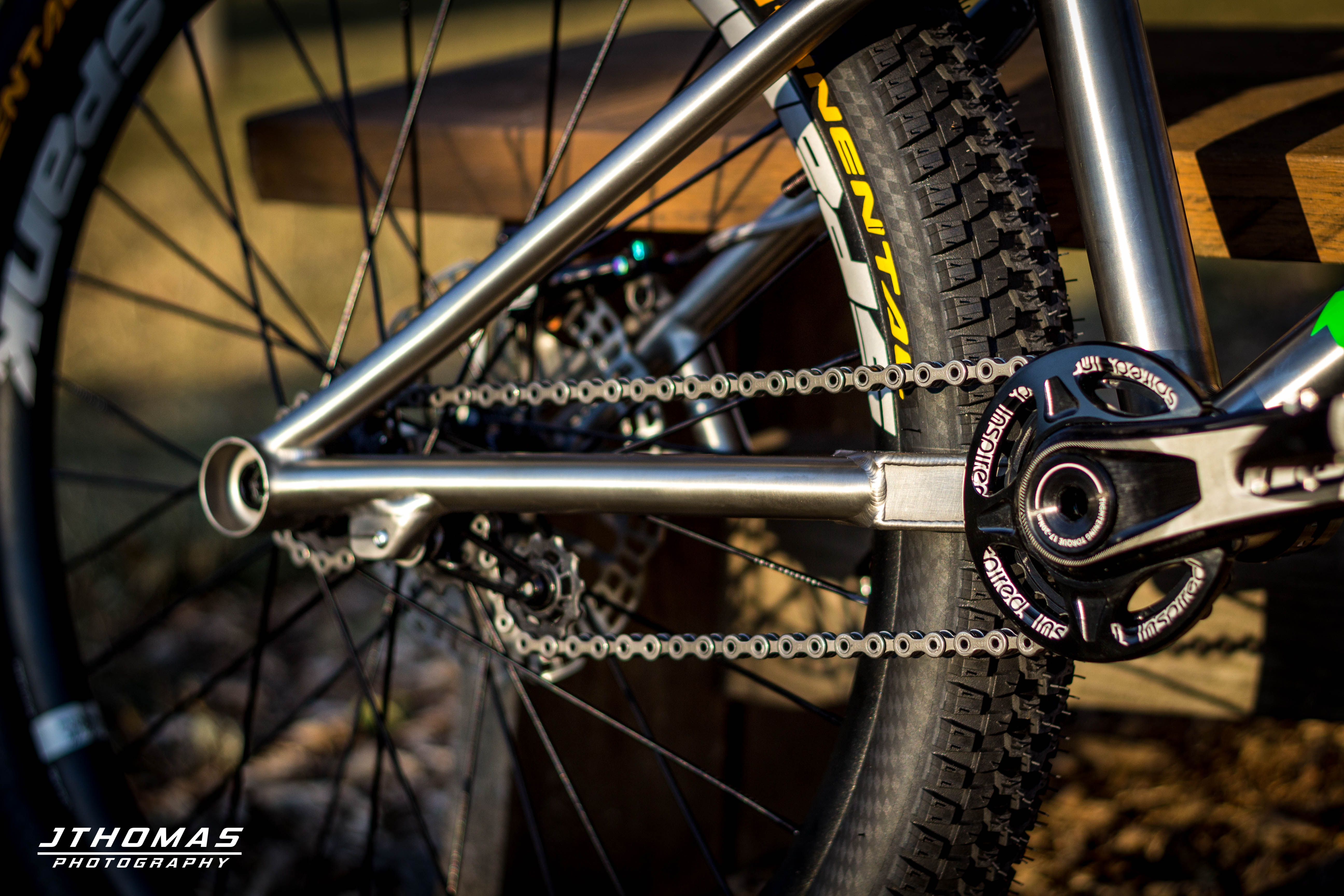

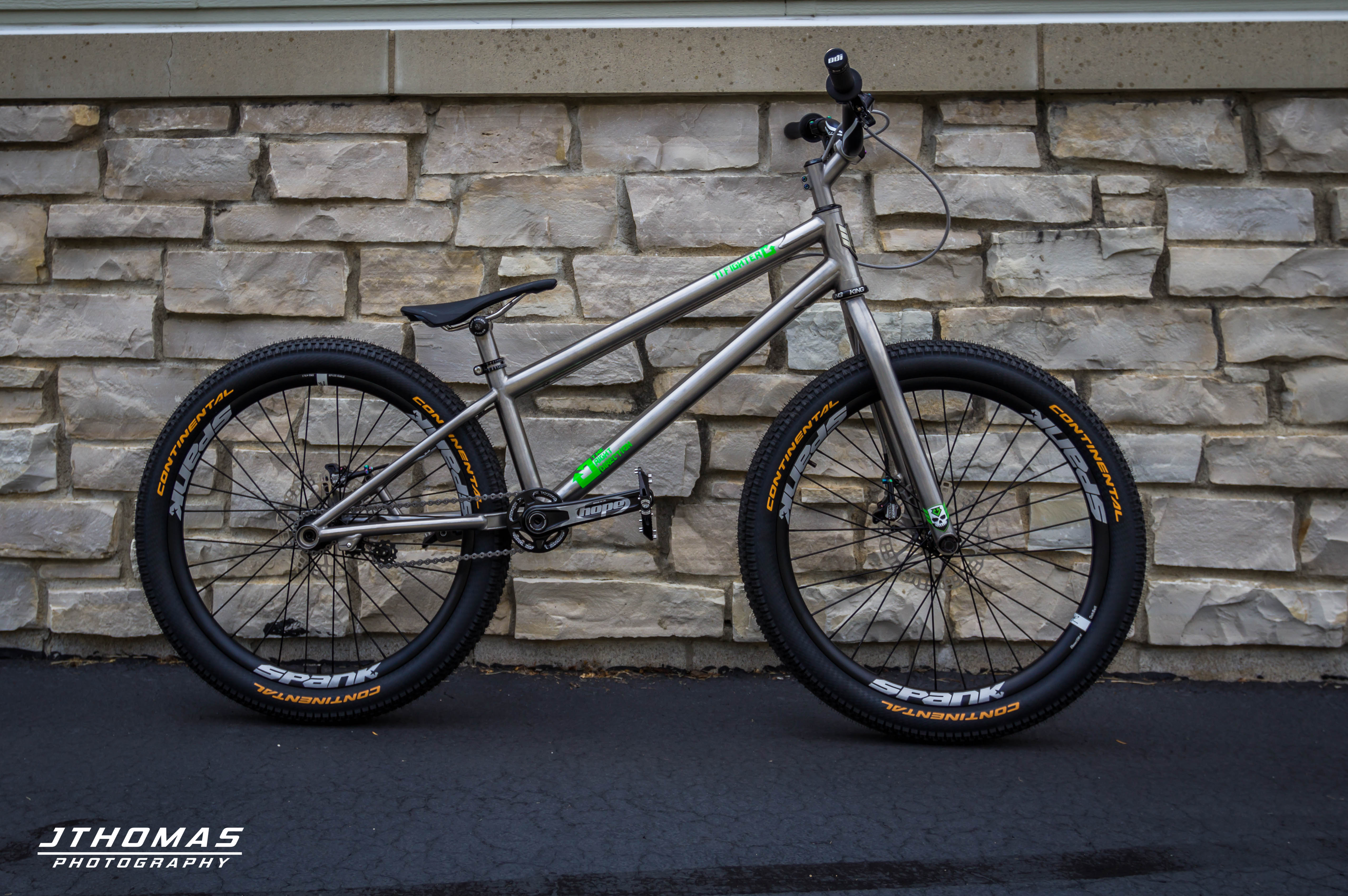

So Far we've made 7 frames in the last 4 years with no failures or issues yet! the newest ones (as pictured) use a custom made Single Speed Synatce mount fabricated by LOCO Machine.
Frame is made by Quiring Cycles and typically run around $2300, if anyone is interested in getting their hands on one of these you can message me here, i can usually get 2 frames made to this spec per season

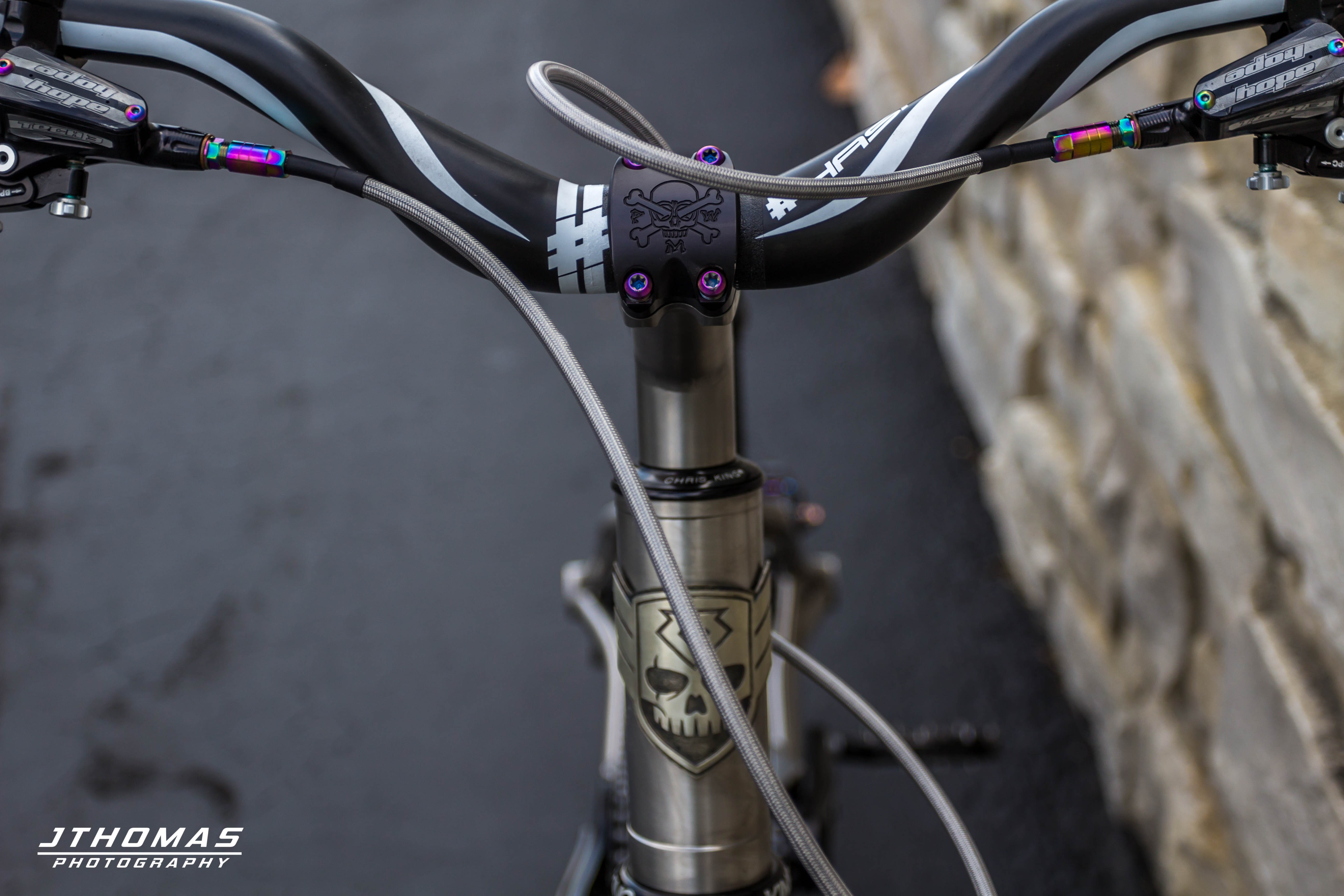

Custom Titanium stem with 30mm of stack built in to the clamp to eliminate need for spacers. Th seat is set up exactly the way I use it for Street and Park. I actually sit on it to get from place to place, thats why its not slammed.

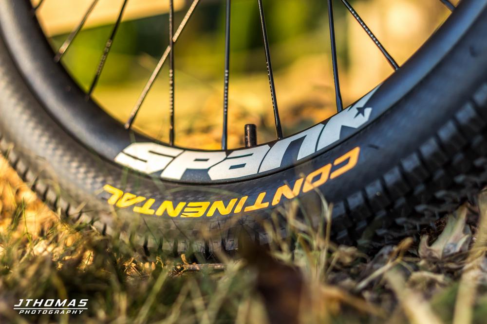

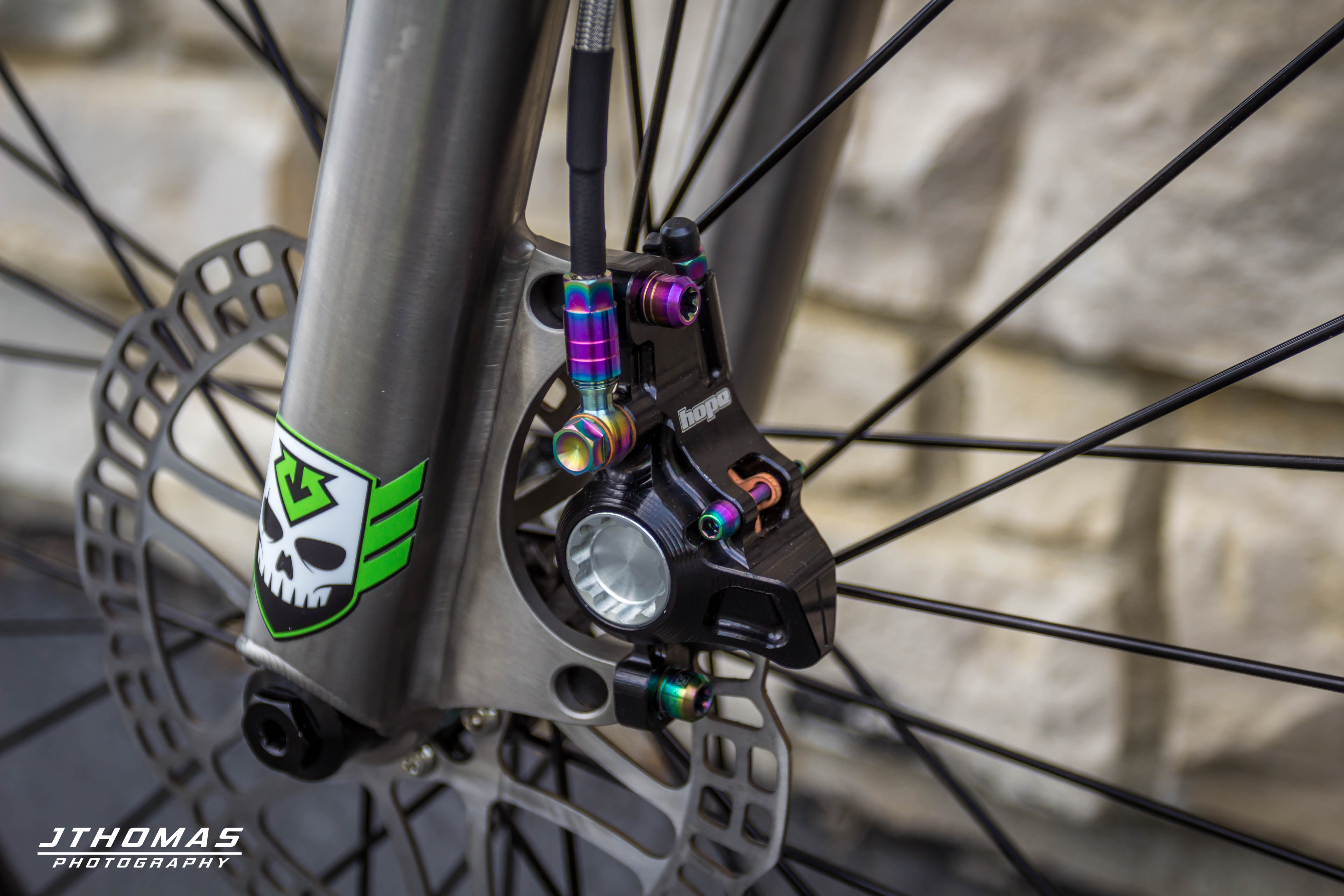

Custom 24" Ti Fighter Street Trials Frame & Fork Build for The Right Direction.org, Same Geo as the current Arcade and weighs in at 21 lbs

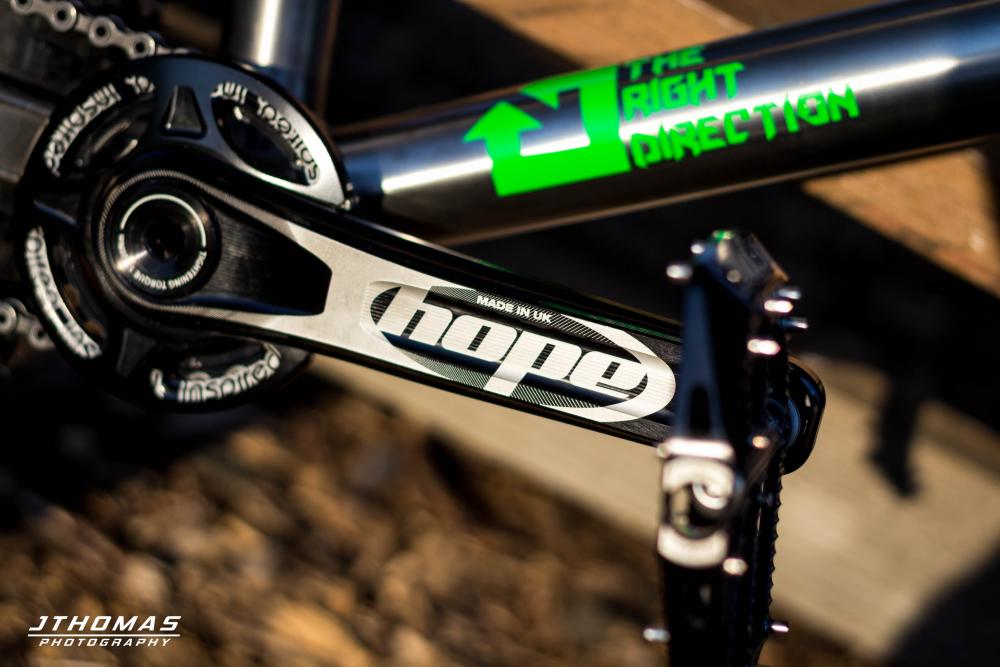

Im sure the cranks would hold up fine, they are using them on DH bikes, my only concern is with the 30mm spindle the inside diameter of the bb bearings is minimized and Ive seen several issues (On race face cranks w 30mm spindles) where the bearing fails after a couple months. as long as their BB bearings hold up you should be fine.

Hope Trial Zone, Tech 3 lever w Jitsie Pads works AMAZING and Im 225 lbs
