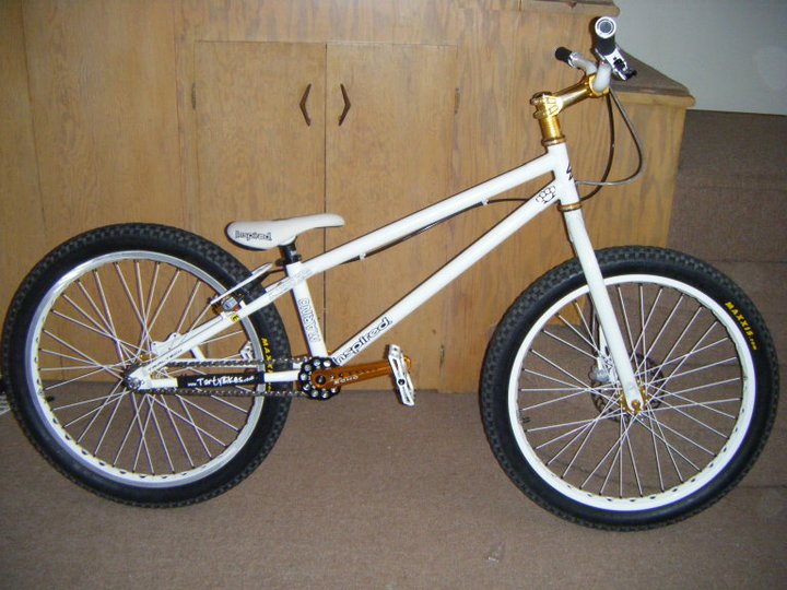

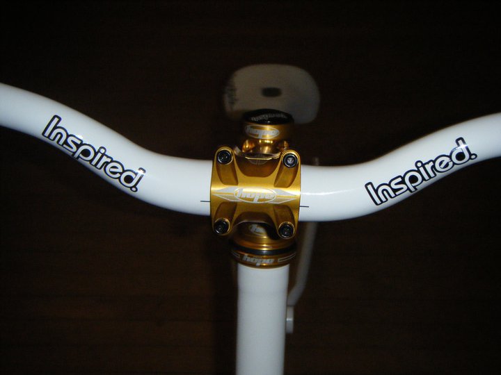

Because there are no gold riser stems and I would rather stick with hope parts I know they make quality parts. Also I am able to switch stems whenever I want I work in a shop I can put mine back on the shelf and pick another one out to try at any time. I just like this one the bike rolls up good, super flickable on rear all and all a great ride for my first trials bike.
It is a marino frame, yes it is inspired geo but I made a few small changes. I have a vinyl plotter i made all my own sticker minus the trial tech sticker it came with my rear cog. I decided to support inspired by using their logo because I used their geometry. thanks man it's a nice bike but it's currently mocking me because we have 3 feet of snow and I wont ride it in the snow

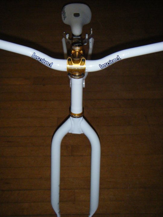

never to late to change to a shorter stem or cut the stearer tube, I figured started big is better and with all the spacers I can find where i like my bar height. measure twice cut once ;P once i get to ride it I will start making changes. thanks for commenting

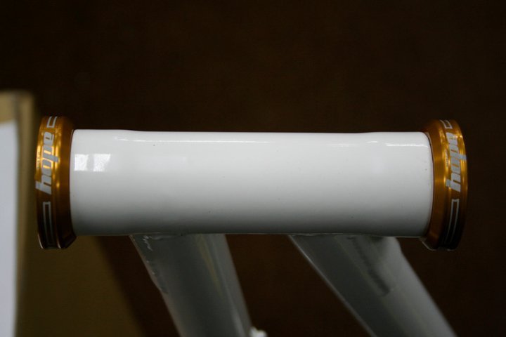

It is a single hope spacer kit only 4 spacers, decided not to cut the fork down, also I ready higher bars are better for streaty trials. I will start with the uncut and eventually, "possibly" cut it down. thanks for commenting the bike rides like a dream, it weighs in at a whopping 21 pounds! nearly as light as some mods so i hear that is. I had originally intended on going black and red, but when i went to order the red hopes from my supplier where I live they had none in stock. So I opted out for gold and white, there was another nice bike in my shop that was white and gold with some other funky colors on it. My friend got me into trials and told me just to get a half @$$ bike, that's not my style I went all in and got myself a dream bike. thanks for commenting

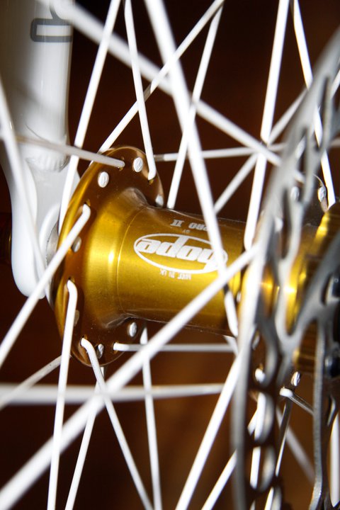

this is the part out of my bike -Marino/Inspired frame -inspired forks -inspired rims -halo spokes -hope pro 2 front hub -hope pro 2 rear hub -inspired seat -inspired seat post -inspired seat clamp -hope head set -hope stem -hope spacers -hope front quick release -magura hs33 rear brake -rockman cnc pads -hope mono mini trials front brake -KMC 710 sl chain -maxxis holly roller tires -trial tech single speed kit -trial tech 14 tooth rear cog -surley 18 front thread on -echo sl drilled cranks -echo urban 18 tooth bash guard -reset titanium bottom bracket -echo sl magura clamps -trial tech brake booster -echo tr snail cams -trial tech m4 snail bolts -inspired pedals -inspired rise bars -inspired lock on grips -hope bar ends I'm sure i missed something, but I though I would show you guys since I said as soon as I was validated I would post so you could all see my bike. enjoy and comment freely.

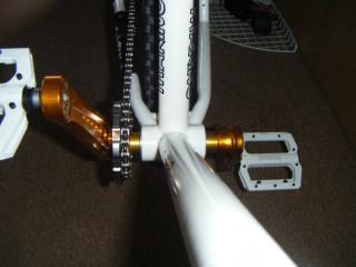

In the case of square taper I've never tried to fit a spacer before. I guess i should have asked if it was isis or square before remedying the issue. Either case after looking at the pictures I don't see how the spacer wont work. the square taper eventually hits a spot where it cant go any further on to the spline. You essentially need to add a stopper to stop it from getting 100% of the way to the spot ( hence spacer) it just need to be large enough to reach the bottom of the spline with force. I will e-mail you a picture of what i mean if this doesn't make seance. Not to worry, No harm done. this is a great forum compared to the last one I left! -
Bottom Bracket Rubbing Against Freewheel
Shop_Guy replied to ireson75's topic in Beginners Trials Chat
yea man that's the spacer you might be able to fine one at a hardware store to save time and shipping. All you want to do is get a few mm of clearance between the front free wheel and the frame. If you do order get more then 1 go for 3 in case, better to have more then less. Once instaledl make sure they stay tight. just so there is no confusion your running isis? the washer just needs to fit over the isis spline and sit against where the crank would normally. If I was validated and could post pictures I would show you exactly what I mean. Best bet hardware store first. try to find something that's not to wide it only has to be a few mm.
