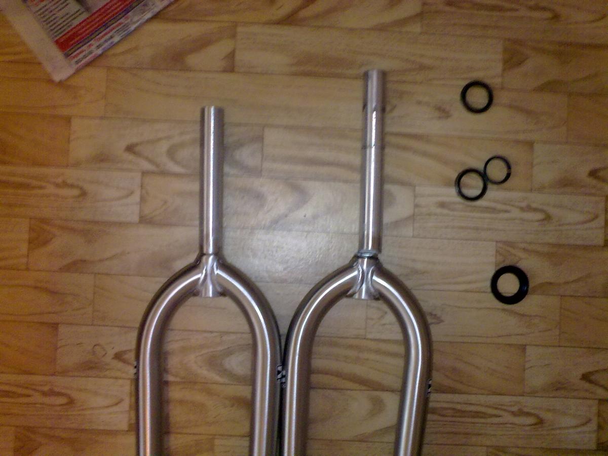

Lol. I just have some fu.. freaking fun with our russian dealer. He send me THIS. And THIS.. I even can't set it up without spacers. Well we come to a deal: I pay extra money for Trialtech fork and when it comes (through carrier company) I send him back THIS. I don't know WTF is it, but he blames ECHO. And one more good thing - I'm no longer need to f*ck with angle of bearings.

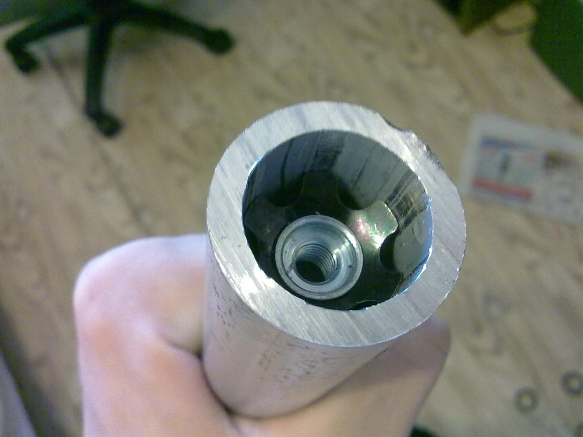

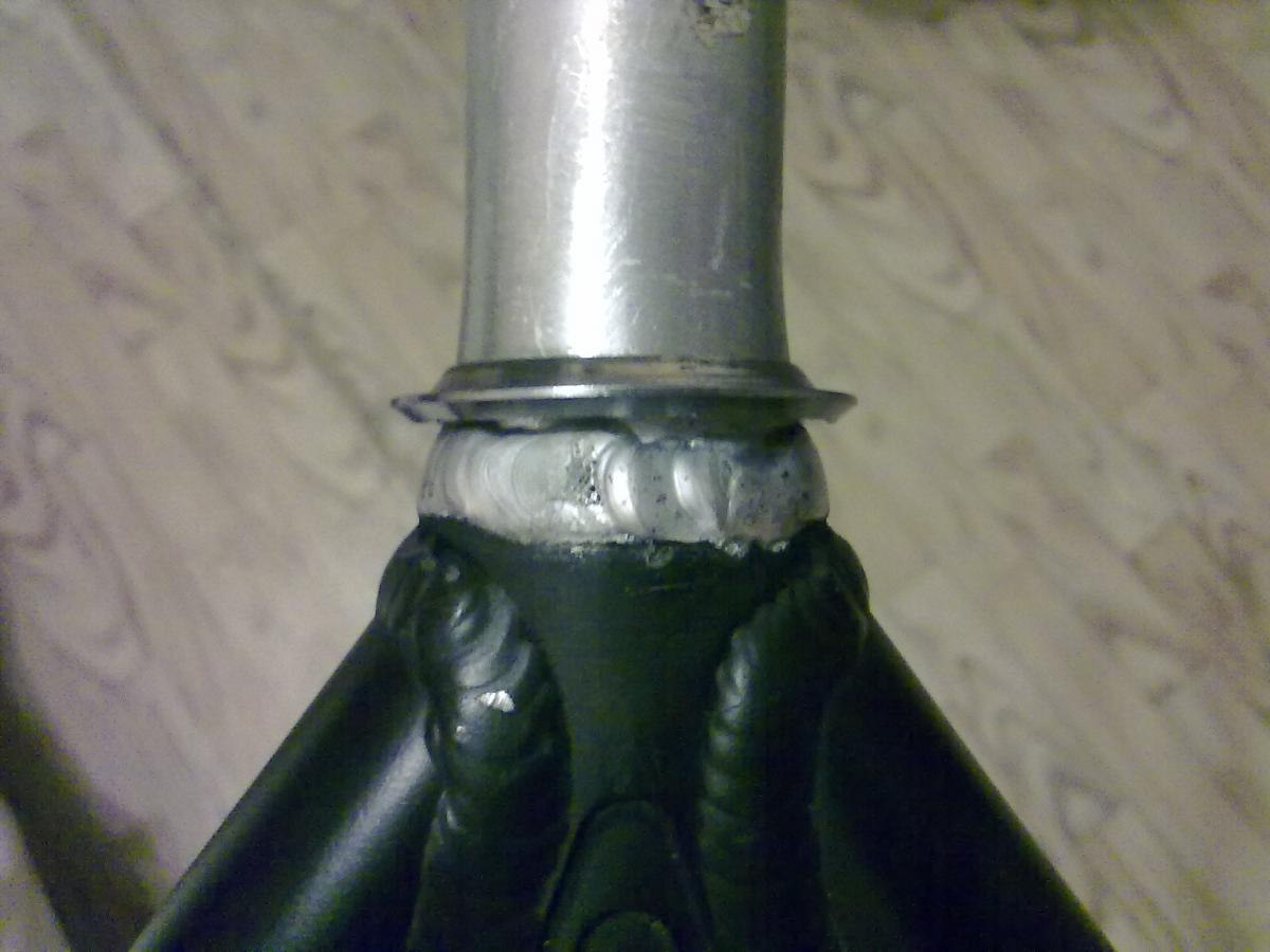

I want to set this fork, that was cracked http://www.trials-fo...ecause-24-fork/ and now it's welded. I want to set it only for 3 days. These 3 days - I will wait for new ECHO Urban 2012 Silver, the same that I broke (lasts me only 7 weeks) few days ago http://www.trials-fo...than-2-months/. I was run destroyed Echo Urban 2012 WITHOUT the crown race as the shop where i bought it advised. And the shop agreed to replace it. And maybe I badly understand what written on tartys about crown race http://www.tartybike.../c40p11730.html But.. f*ck.. someone says that I must use crown race on Urban fork, someone that I should not. I'm confused. As I understand I must get an ECHO headset(45 degrees), but I don't want to spend extra money now. My headset is FSA 36 degrees. Could someone with arguments explain why I shoud use a crown race or not?

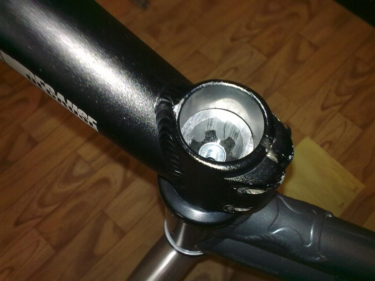

This is my old Because fork and it's 2+ years old, cracked about 2 months ago. I'm just waiting warranty replace of my ECHO Urban 2012 (that lasts me 7 weeks) and can't ride, so I was thinking maybe try this, but.. probably I better wait for new Urban.
Or it's very bad idea?

Everything is fine, I will get the same new fork for free. But, one more time about crown race. My headset is FSA 36 degrees, I have some crown race that was fitted on my broken Because fork. So I just put it on new fork and all fine? And one more question - my friend use same fork with ECHO TR headset PLUS CROWN RACE. He must take crown race off, right? He already have a little dent on his fork in that place. -

>you weren't using a crown race Yes, i ride without it. But is it so important? But I'm not so big in brakeless and every drop I do I land on rear wheel, not on 2. I don't see a reason for this fork to brake in so short amount of time.
