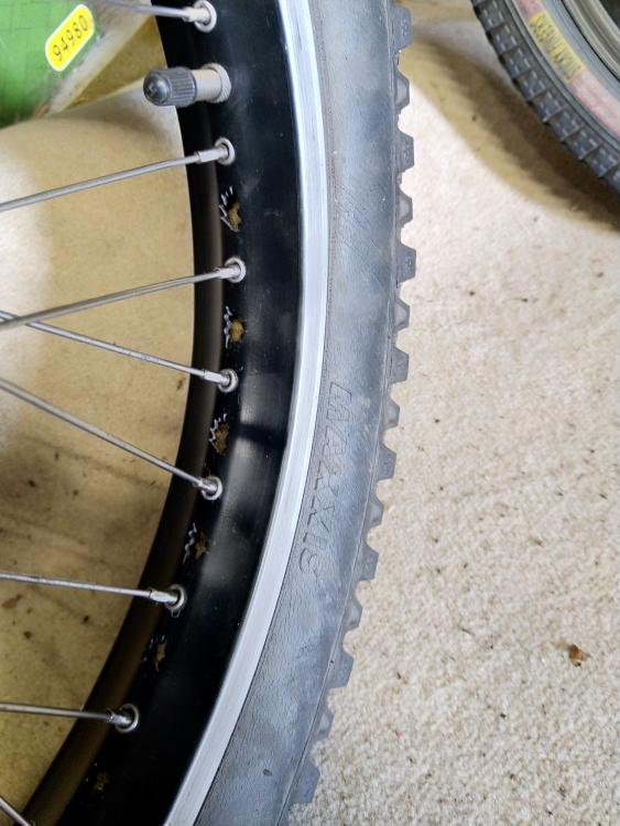

Apologies for the delay... Some not great photos of the onza tyre fitted, only about 5-7mm of clearance between tyre and chain. The creepy-crawlers are a tad wider so it catches....?

Hi all, Fairly new to all this trials stuff, and have a quick question.. I have picked up a few spare bits and bobs.. some.of which are wheels. I have an onza T-Bird, and I tried to fit a spare set of wheels that look a bit better (still Onza)... The rear rim is wider with a creepy crawler on, but it was too wide and caught the chain. So, as the onza sticky finger is a little worn, I put the creepy crawler on the original, narrower rim.. but it still caught the chain. They are both 19(20)x2.5 tyres. Is there something I am missing or will I only be able to use sticky fingers on it? TIA Karl

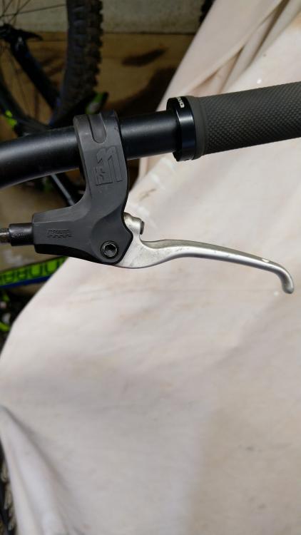

I have realised (as per another thread) I have a magura HS11 rear lever too... It's not ideal, a bit 4 finger, plastic thing with far too much reach... I'm going to have to get hold of a lever.... And new pads....
Damn.... Guess they move a lot less fluid... I thought so on the mods... Got the HS11 lever bled up today, works ok but I need foot long fingers to reach it.... And some new pads...

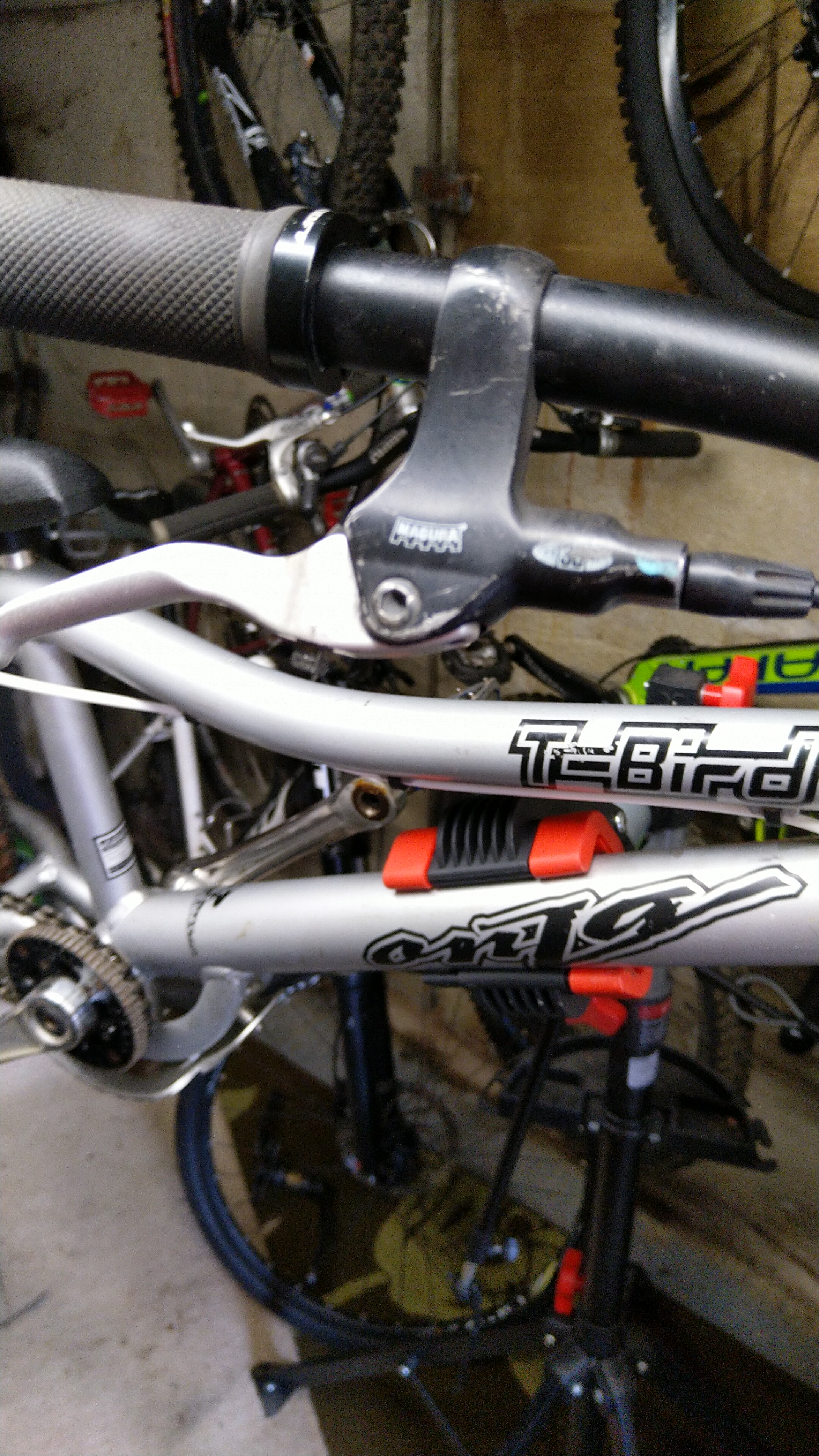

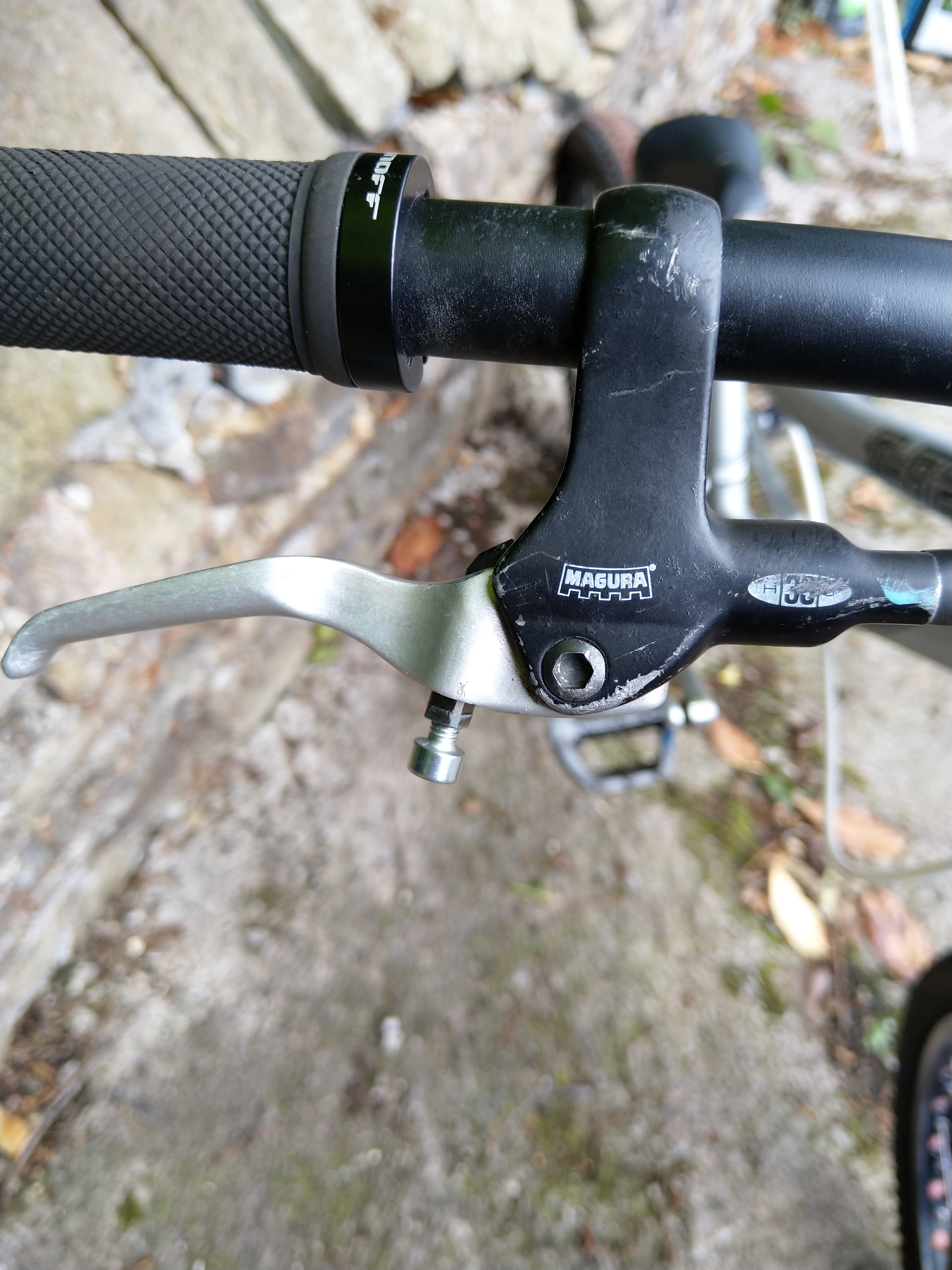

Cheers fellas. I was playing around today with the top lever, I found that I couldn't get that adjuster to adjust... To pulled it all apart and the screw portion has been snapped off. Currently bodged with a longer bolt, but it's working great now. Also just noticed looking at that picture, that's a hs11 lever!! Someone must have snapped the original and replaced it with the cheapest they could find... Hopefully it will work ok, I'm sure I read about them pushing less fluid..?

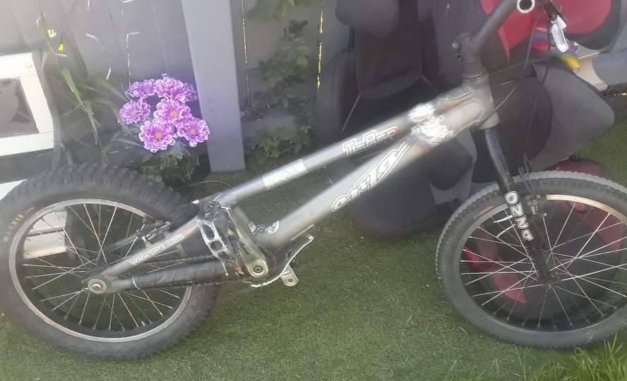

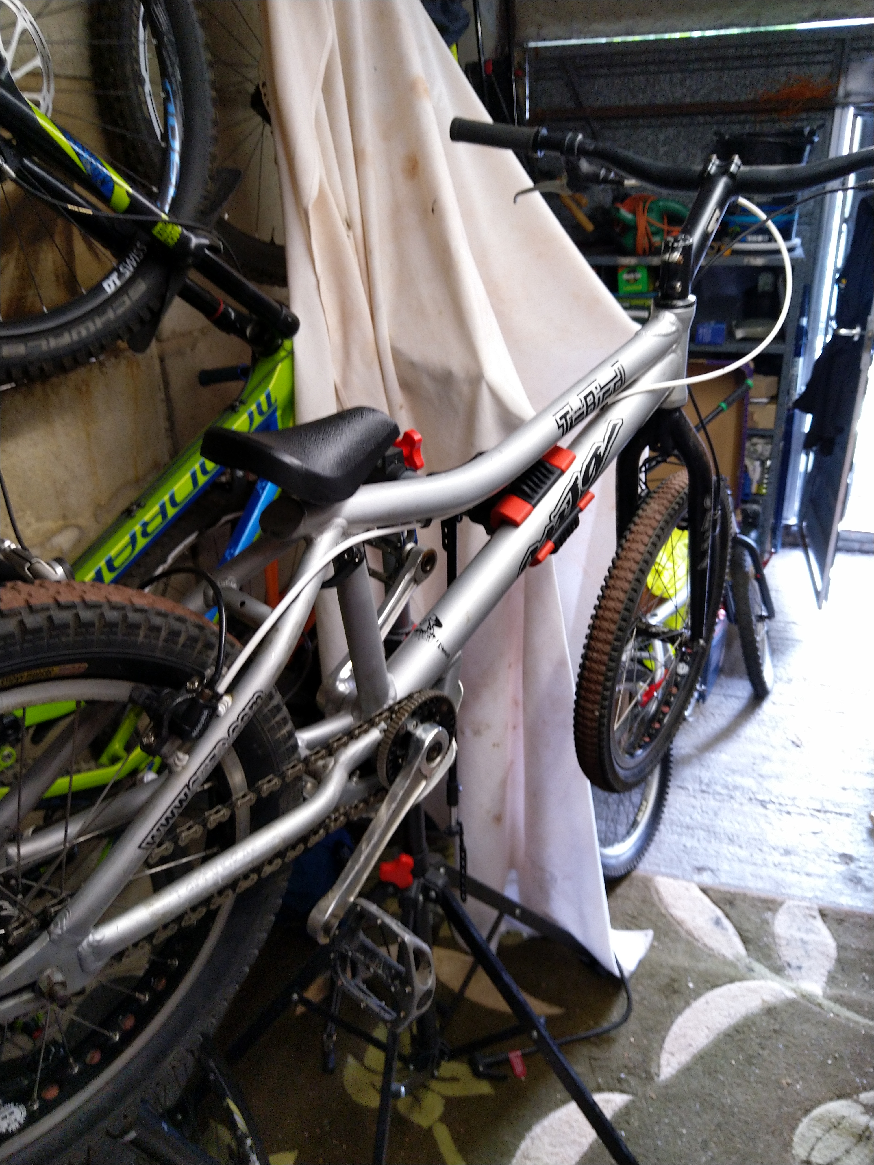

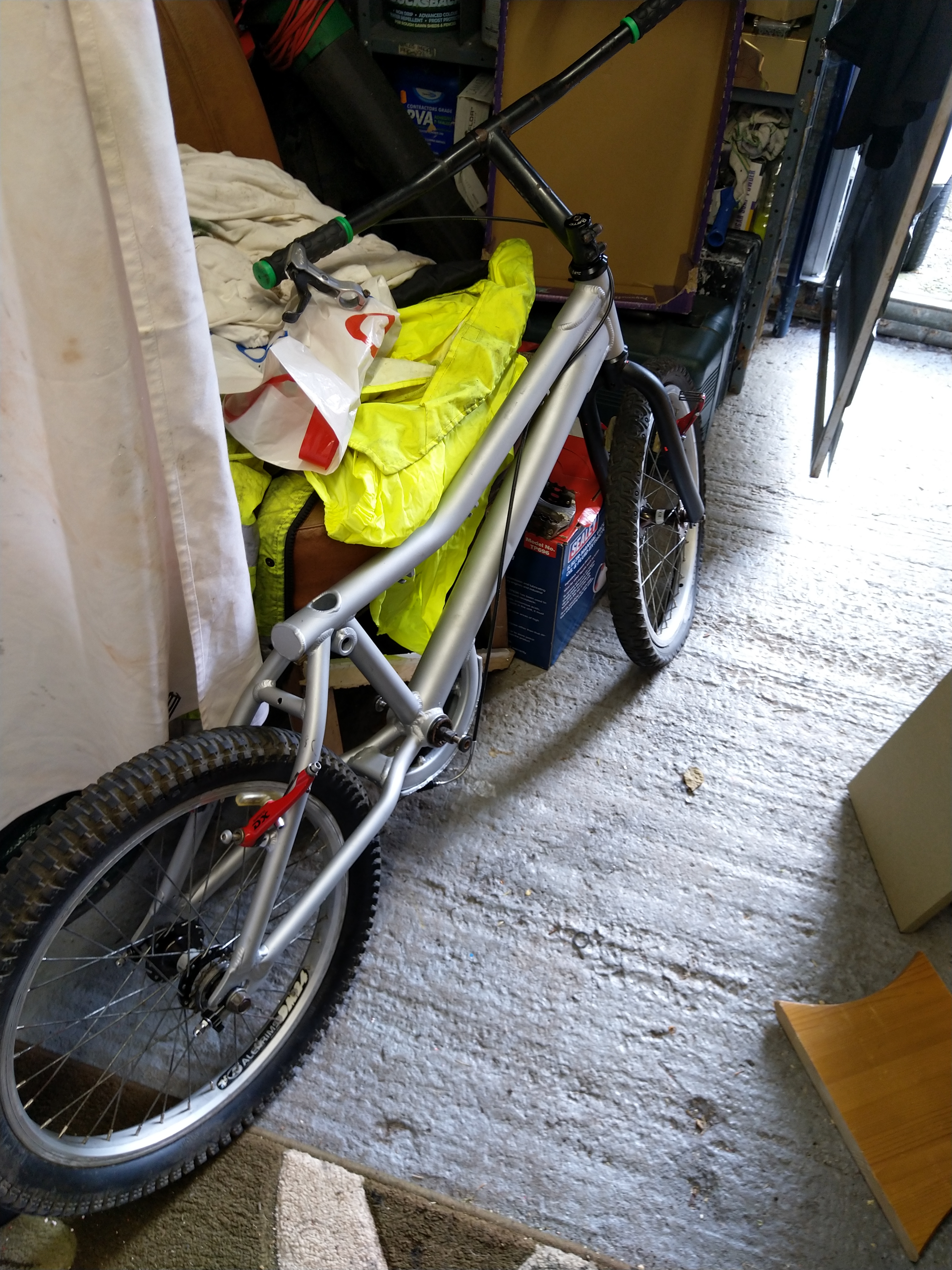

Hi all, I have had a couple of posts on here needing help with various bits, but I thought I'd share my 'budget' trials bike project, which has taken a few twists and turns! I picked up a project bike for £30 and got it running with some nice cranks from @isitafox However the back wheel kept slipping forwards, so I picked up some chain tugs. Went to fit them to find that the axle was way too far back in the drop outs to fit. Link out of the chain, Bob on. Axle sat nicely in the middle of the drop out, chain tensioned perfectly. Now the V brake just wasn't going to line up. Not enough adjustment to get it to reach the rim properly... 20" wheel when it should be a 19" wheel..... So after scouring the internet I found another T-Bird for £30, with everything except brakes, no worries already got them... Whipped the wheel off to find it's a 10mm axle not 14 like my frame... No worries I will just swap the frame... The T-Bird is a 4 bolt magura set up.... So I decided to look for some HS 33's... This is when I found the snapped T-Pro... Picked that up for £50. It was completely bodged up, stripping it down there was all-sorts of wrong nuts and bolts jammed into places. The frame had been welded (not even straight! Will get some pics, I was never going to use it.. might make a nice lamp or something one day...) during welding, they had welded through the rear hose... So I replaced that today (though I am struggling to get the hose all the way to the end of the barb fitting!?) The T-Pro has a decent looking rear wheel, the widest of the 3 with a good creepy crawler on, tried to fit that but the tyre catches the chain annoyingly... I maybe able to rectify this when my fixed rear sprocket arrives, if it moves the chain line over a bit... Anyway, once I get the rear brake bled up, the T-Bird with HS33'S should be good to go and I should be able to get out and practice! I think I will need some new pads soon as these have never been set up correctly and are worn on all-sorts of angles... I have ridden bikes for years, park, street, DH but more recently 'enduro' (MTB...) But really fancied the idea of trials to further skills and improve balance. Looks bloody hard though! I will put up a few pics of the various bikes I have got now, including that impressive weld! I will hopefully be able to sell a few bits off as there is some good stuff here that I don't think I will need.
Hi all, Just entering into my first foray or hs33 ownership. I bought a snapped T-Pro for parts, mainly the brakes, but I would really like to get the rear wheel to work, but I think it's too wide (chain catches the tyre) anyway... I have just (hopefully successfully) replaced the rear hose and noticed I have two different levers... The slave cylinders themselves look identical, but the levers are as below... Anyone know which is better and if I should source another of either to get them to match, or will they both work as well as eachother? Cheers!
