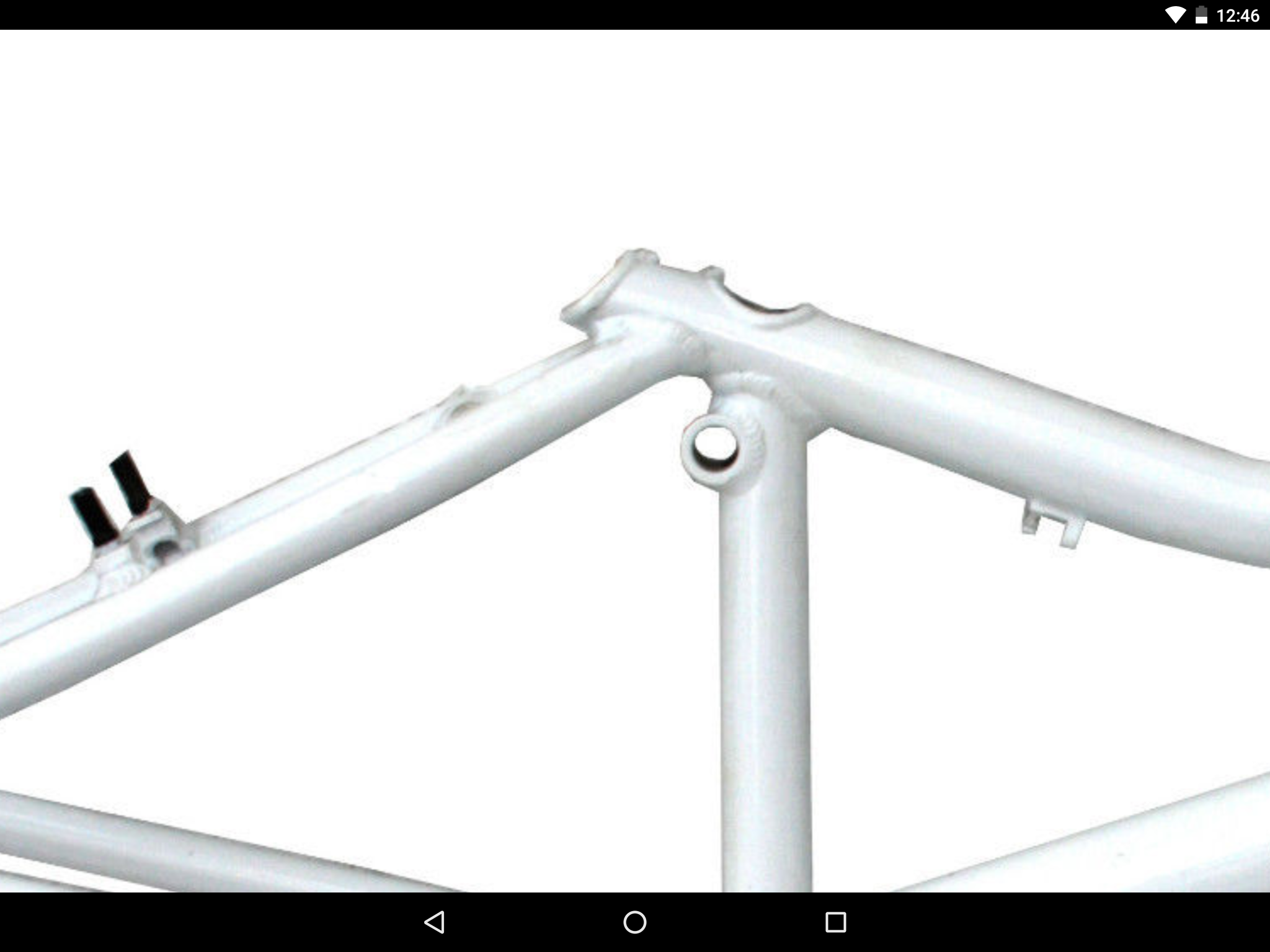

  8. Just been playing 'pedal up' on my phone, pretty cool!

  11. Sounds good, will head there when I get the bike sorted (I think we are allowed now!?) Cheers swoofty, I was thinking of something very similar. Get a hole saw the same dia as the integrated seat clamp and notch the seat post, then stick a bar in with some penny washers or something to lock it in place... Maybe if I feel I need a seat..
