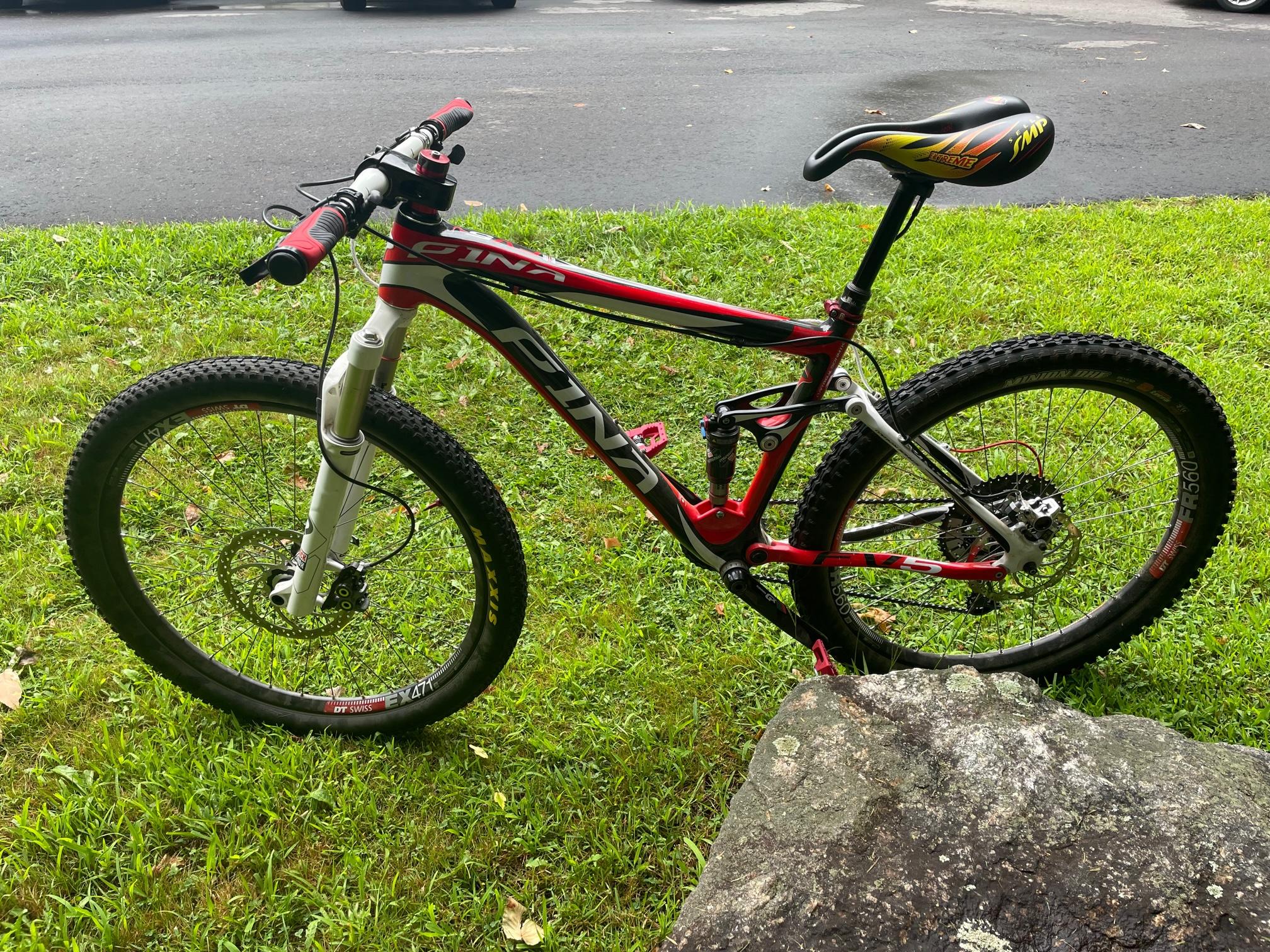

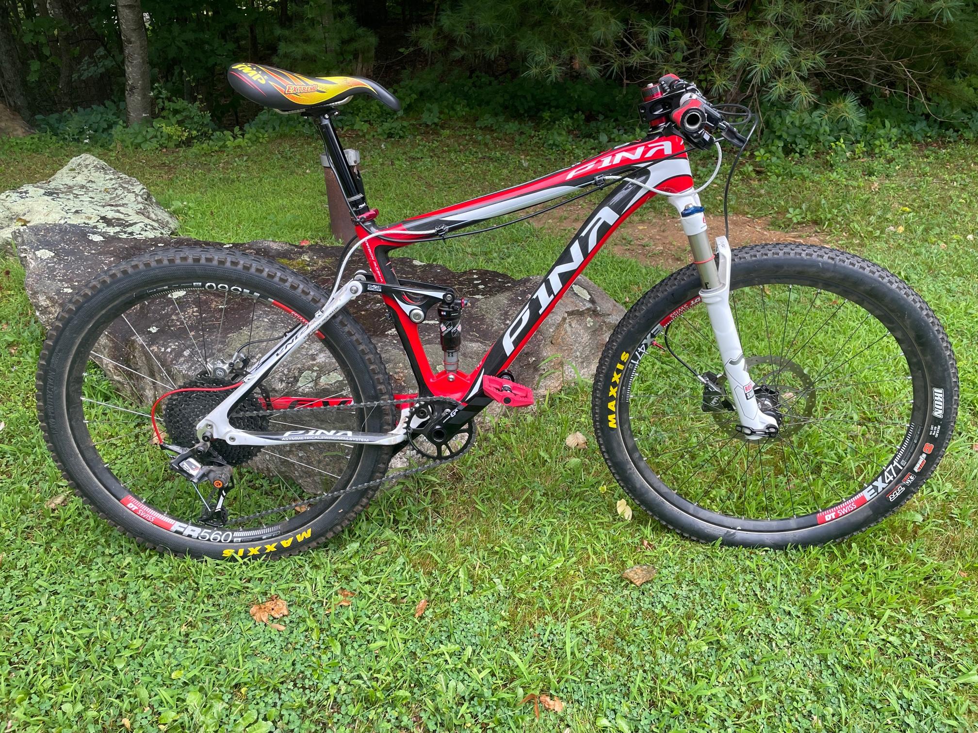

Thought I would inquire about this possibility as well, just to have a rough idea of what type of frame I should be looking for. For a baseline, this is my 26" full suspension frame. My first mountain bike build, and it shows in the mistakes I made. And it was built it for comfort and function- to get me started in mountain biking, with secondary focus on esthetics, hence some perhaps odd choices for certain components. Frame is a medium; I am 5'10" so sitting right at the boundary of medium and large, however, with the 26" wheel the bike is too small for me, I really feel like the proverbial bear riding the circus bike. I don't ride it much these days, because the next mountain bike I build is a 29" wheel large frame hard tail which fits me like a glove. I would suspect this is a bad candidate for a "trial" conversion, given the full suspension frame, I suspect it could be made to be more "trials friendly" but swapping a rigid fork, converting to a single speed sprocket and a smaller chain ring, and swapping for trials specific stem, handlebars and one of those rudimentary "seatposts". But it would still be a rear suspended frame, heavy as hell (it is carbon fiber, but it was overbuilt, so it is pretty heavy for a CX bike). What I am most interested in is geometry though. Not having any actual frame specs, just by gauging by eye- if I was to buy a small framed MTB as suggested, do I need to be looking for something with significantly altered geometry? Thanks!
