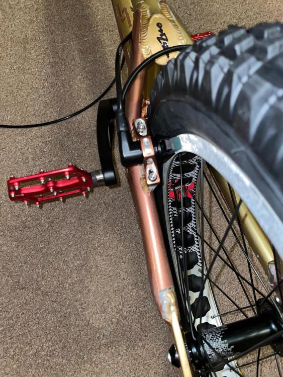

  9. DAY 12 CHAIN New Park Tool chain breaker came so chain went in. I have to say, those snail cams got turned all the way to the maximum radius in order to have a firm enough chain (from what I saw in videos of people gauging the tension by squeezing the chain- I will know for sure once I start riding and there is no chain slip). Also, did something probably a little controversial for chain tensionig. I have the snail cams on the inside face of the dropouts on both sides. But given that the Trailtech rear hub I bought has a somehow unique design (10mm bolt on the drive side, acting bot as clamping bolt and axle), I could place a chain tug on the outside for extra secure axle lock in position. On the non drive side the hub uses a typical (I think 6 mm) bolt that threads into the axle itself, so the chain tug 10mm hole is too large for that bolt and it would be free to move around if given a chance, so I did not bother with a chain tug on that side. Finally, once chain was taut, I adjusted the slave cylinders to line up with the new rim position.

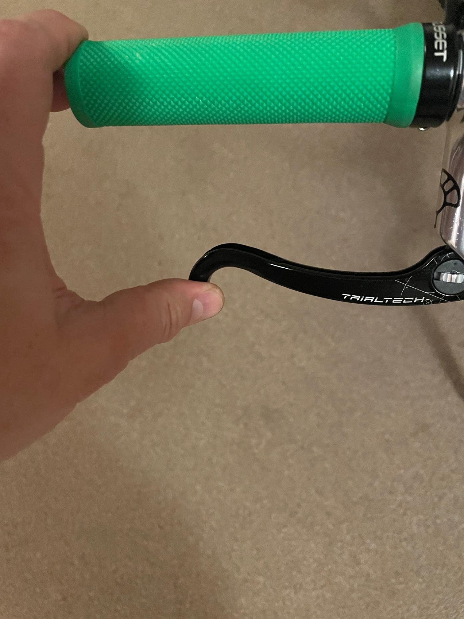

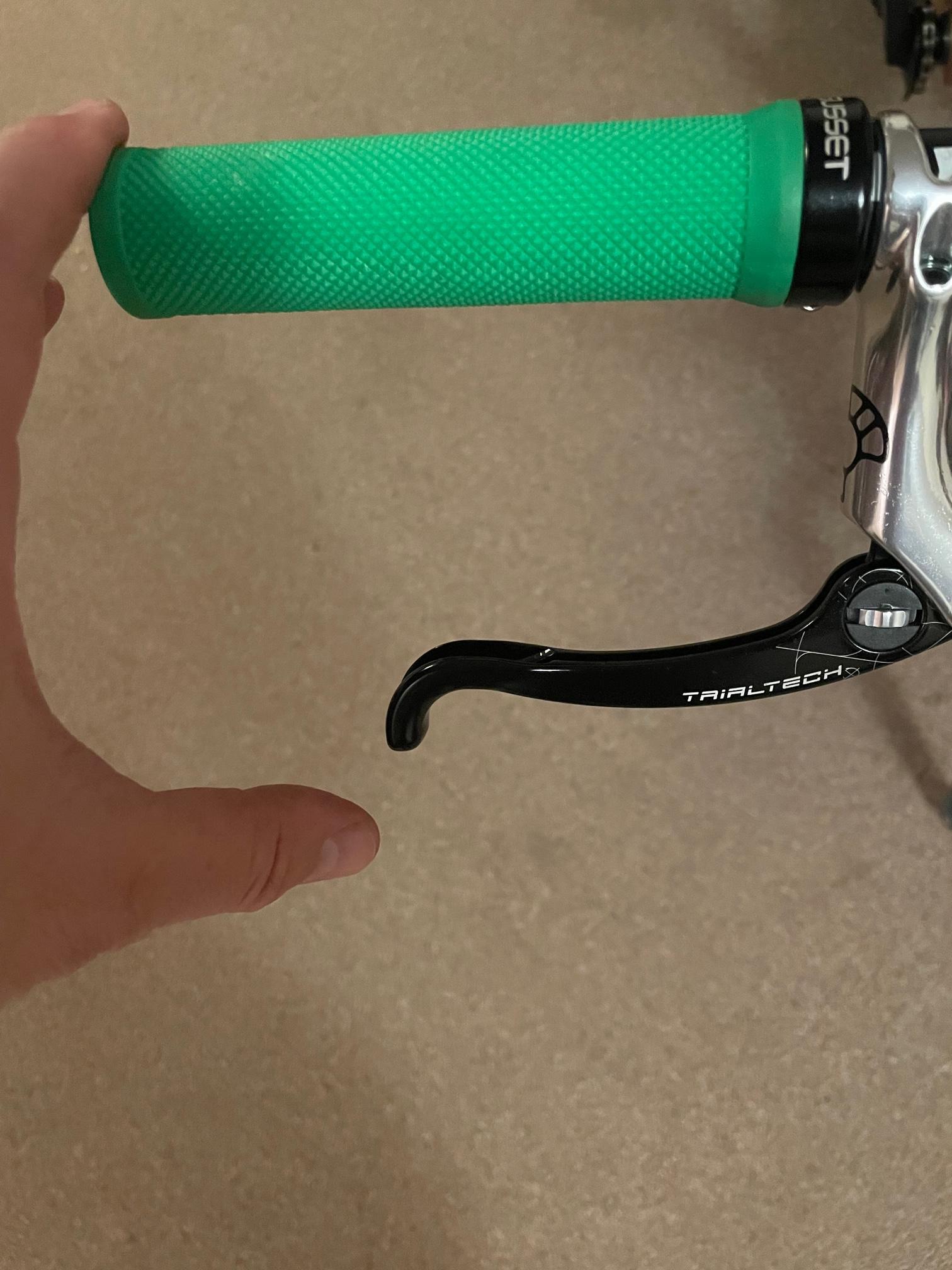

  10. Thanks Mark, the trick with the cut spoke is awesome, will definitely use it next time I have to insert one of those fittings! And my statement about the adjuster was a little misleading, it's not that it makes the brake firmer- in fact the lever travel stay the same. But by moving the lever away from the handlebars it just makes it easier to "modulate" applied force, especially harder force for firm braking (it could be just me, but if the lever gets a little close to the handlebar, it gives me a sense of too much force applied so I tend to back off). I would say that the lever travel is about 1/4-1/3 of an inch from rest position to end of travel under decent pull. There are probably still a few small air bubbles in, so I will in fact perform the top-up bleed you described.

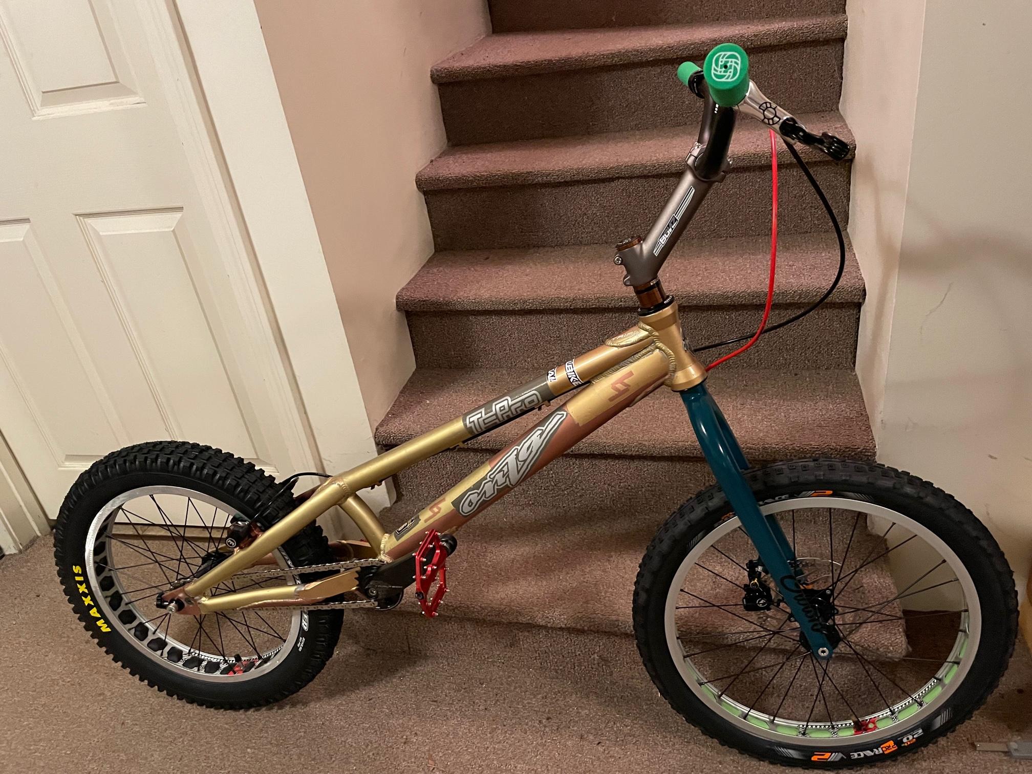

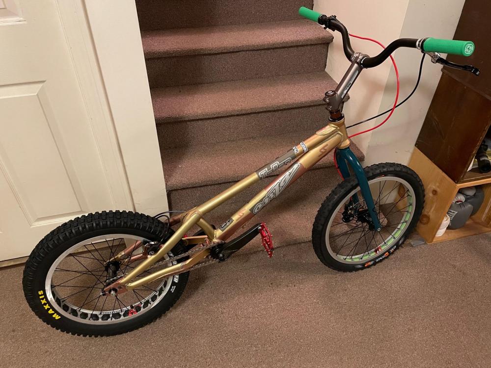

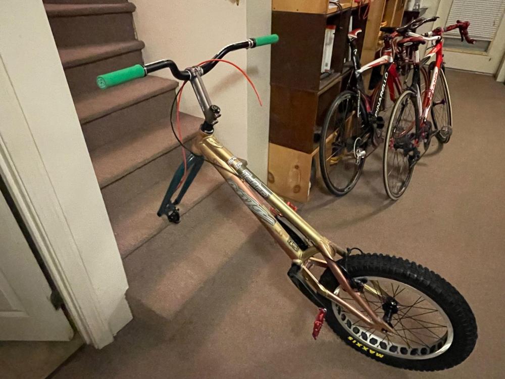

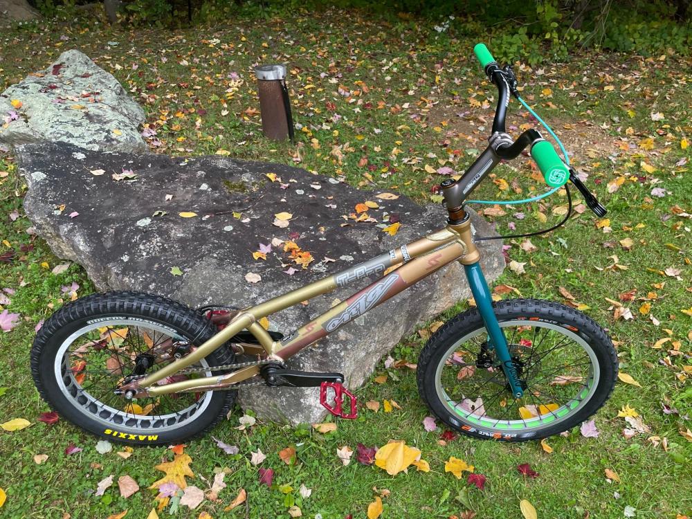

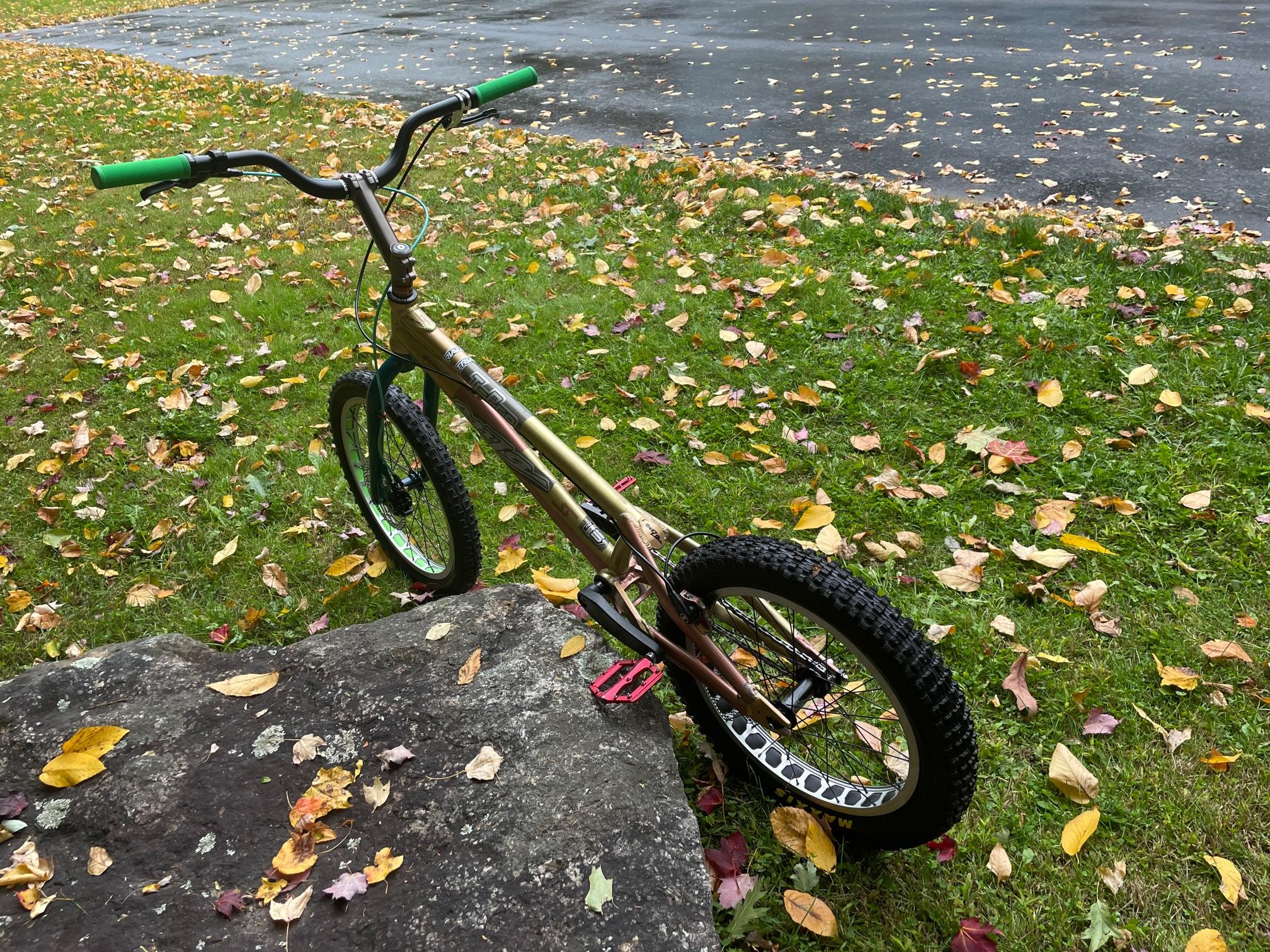

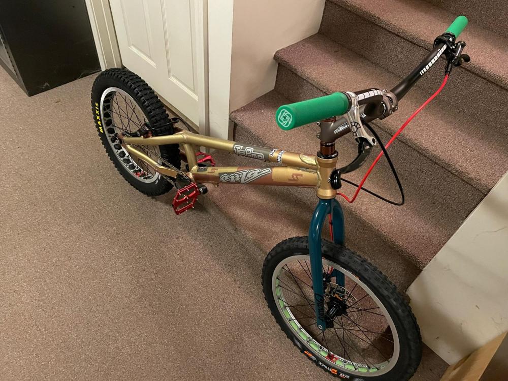

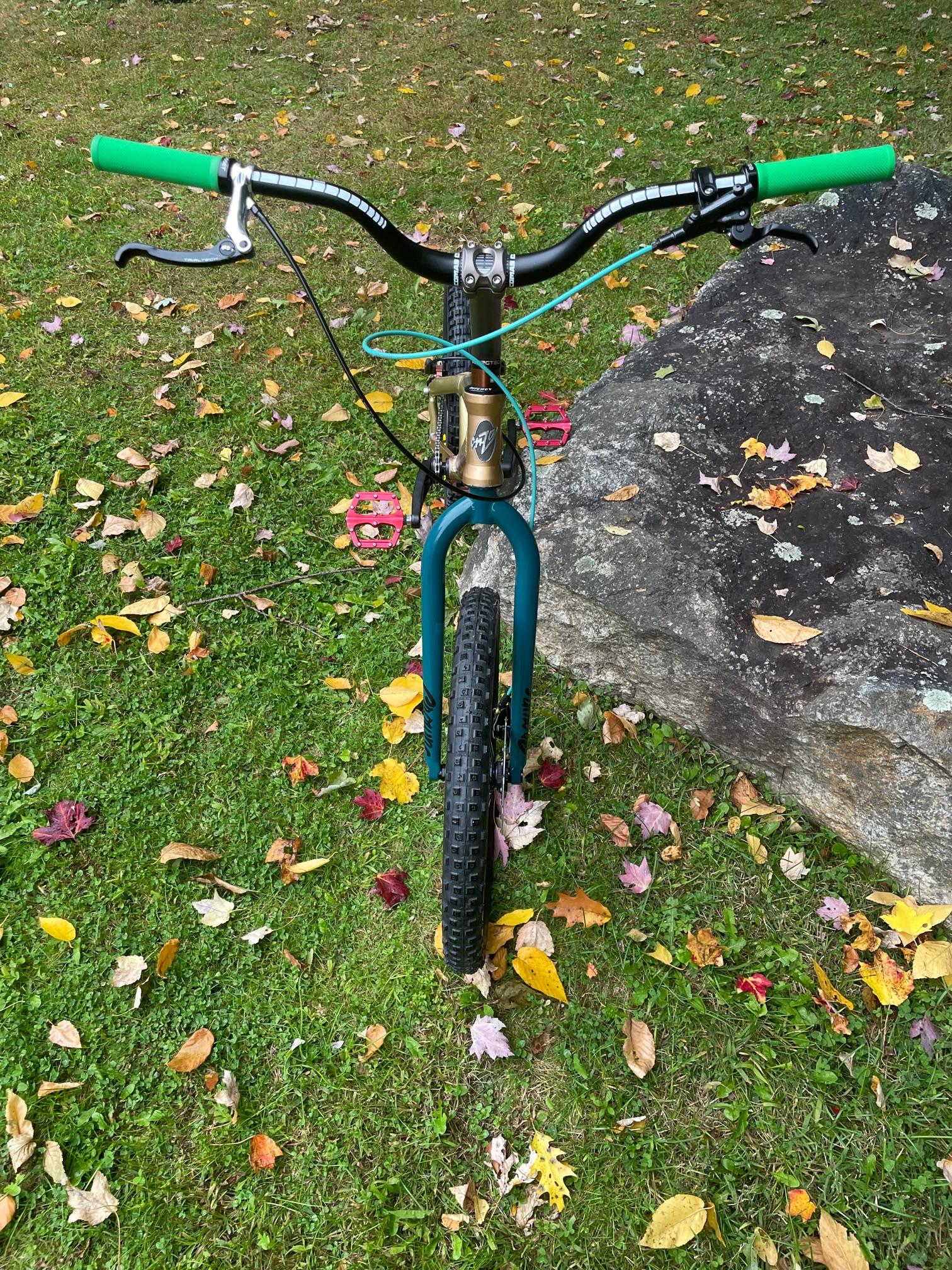

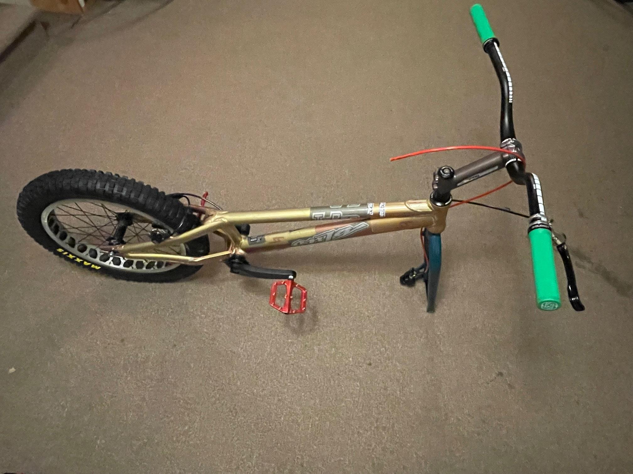

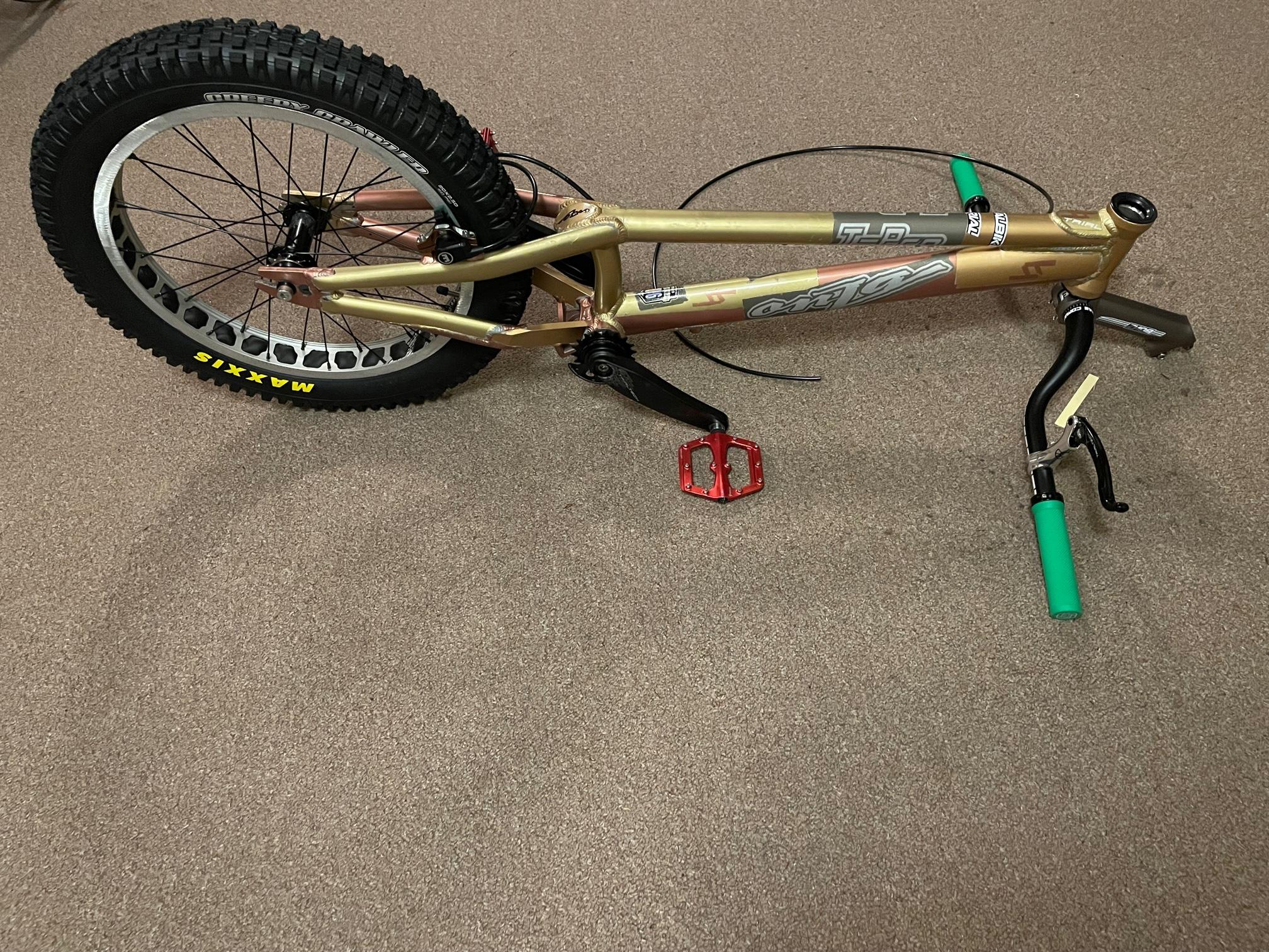

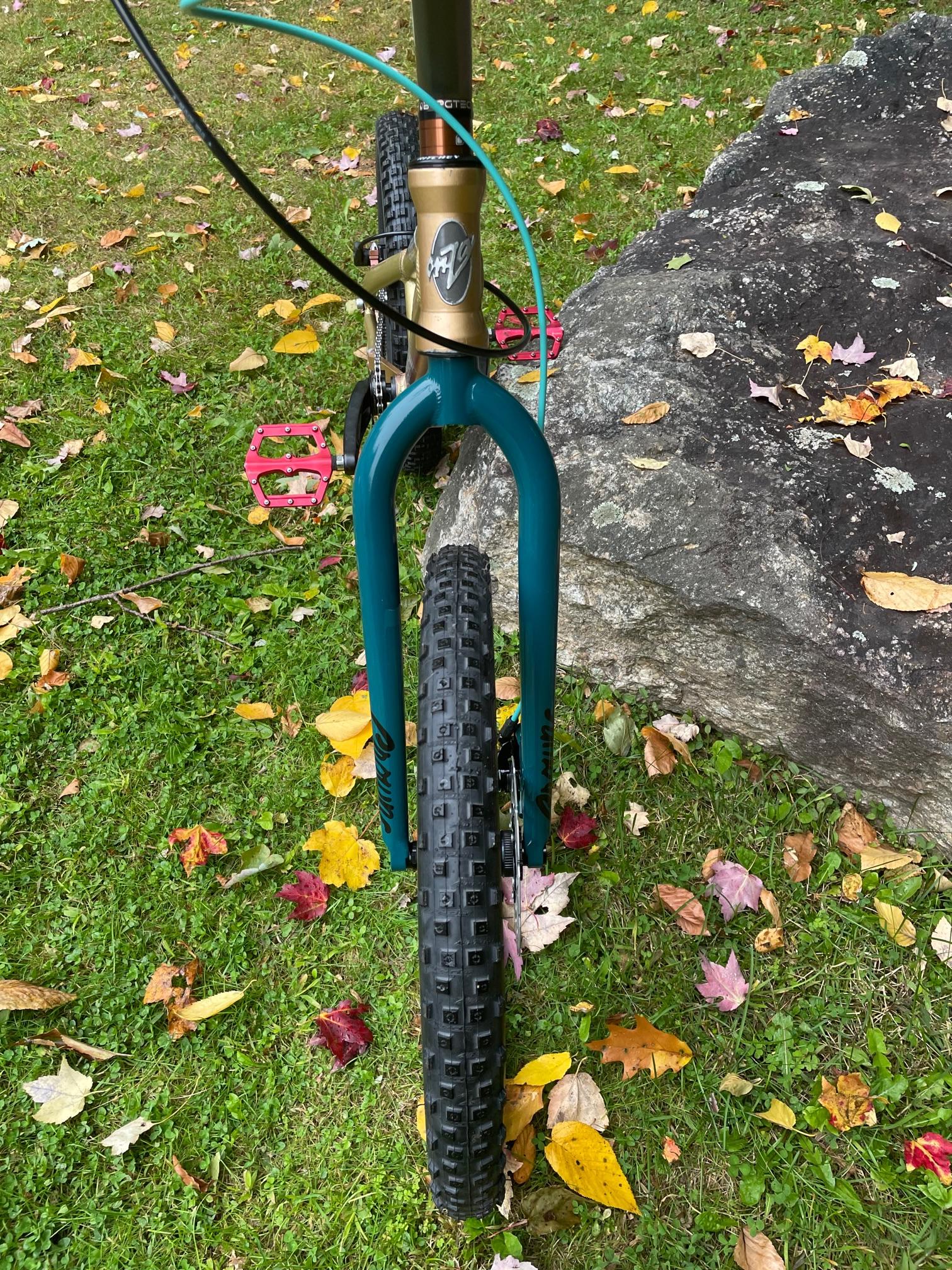

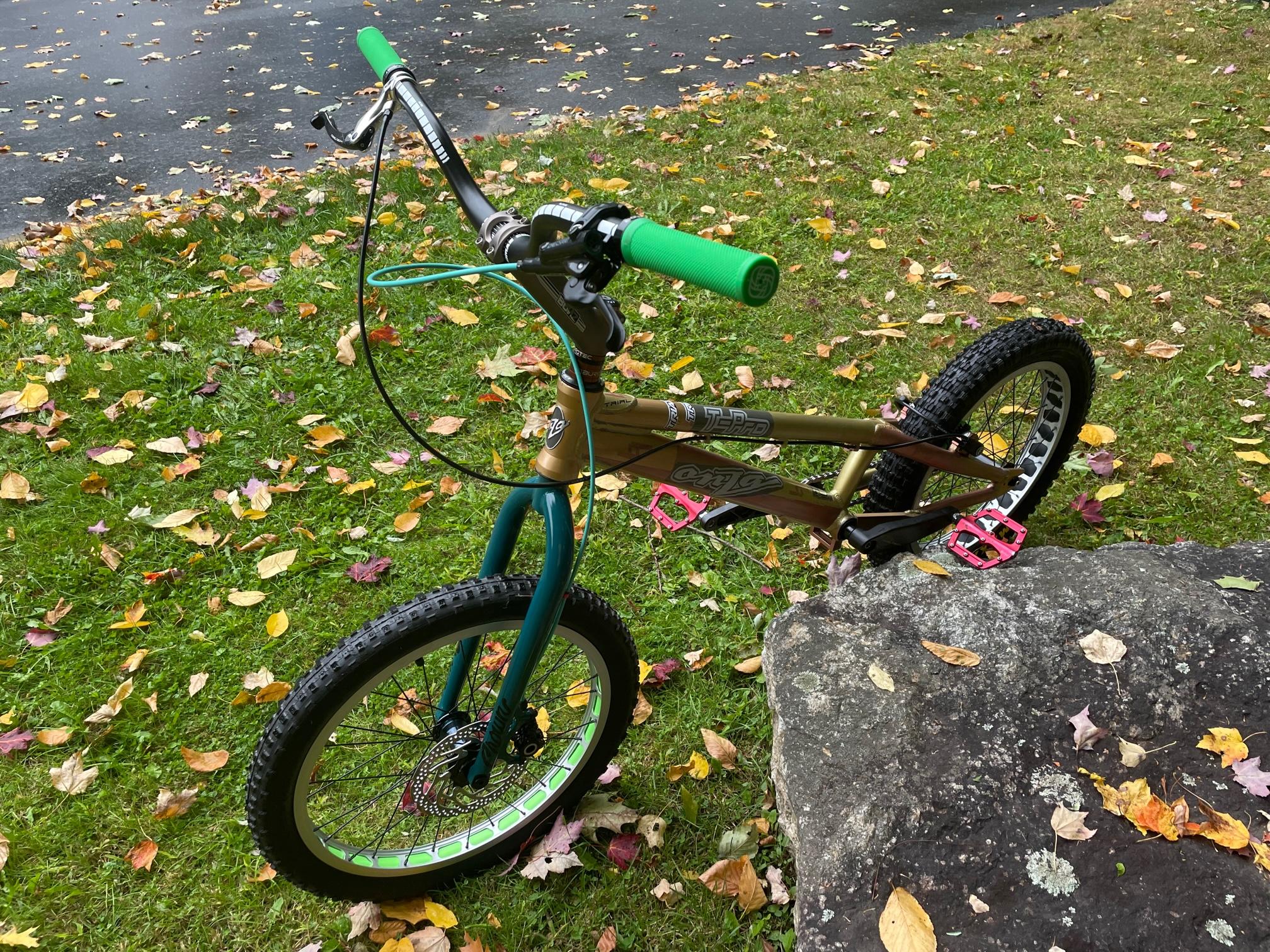

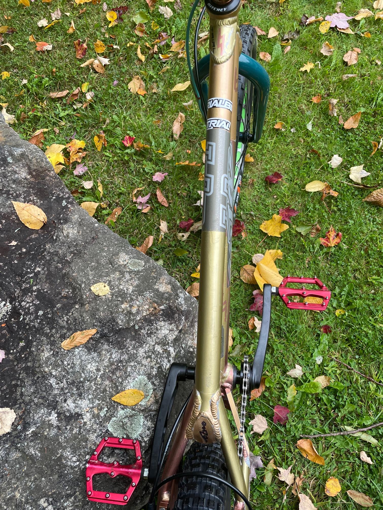

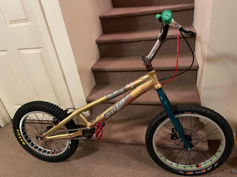

  11. Due to hectic schedule did not take many pics along the building process for the entire week, but took final pictures of the bike as it stands to day with rear wheel on, rear brake fully functional, fork and handlebars on. The pics with the fork on the star steps show a decent rendition of the geometry if the bike had a 24" wheel on (only 1" too high, axle is 13" off the ground as opposed to the correct 12")

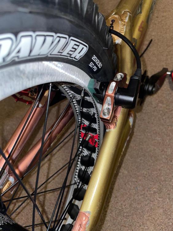

  13. FRONT BRAKE I had an extra Magura MT2 caliper from one of my older bike builds collecting dust, so I installed it on the fork, getting ready to put the front brake together. I even found to my surprise, the caliper fitting end of a Jagwire Quick Fit hose, the length was plenty, so installed it on the caliper and fork. Unfortunately I do not have a banjo screw, so I cannot finish the caliper end of the brake until I get one of those. Needed a brake lever so I just ordered a Shimano Deore left lever off ebay for a decent price. I have everything needed for the lever end (barb, olive, threaded nut) so once lever gets here, front brake will be ready to assemble and bleed.
  14. REAR BRAKE Once fitting was in, I bled the brake. I forgot to mention in an earlier post, but once fork was installed, I starting getting ready for bleeding, even before putting the brake together. Identified caliper bleeding screw, removed it, and installed a hose with a Magura threaded fitting that I had from bleeding Magura brakes for my other bikes. Big mistake as once screw was removed, I found out that the guy that sold me the caliper and hose actually left the original royal blood in there, and with both ends open now, it all poured out. Made me feel like an idiot. So had to bleed from the scratch. Syringe on the caliper end hose, receptacle on the lever side, push new royal blood in until lever hose starts filing. Swap roles, with syringe into lever hose, receptacle into caliper hose, push some royal blood in once pumping lever a couple of times. Take hoses out, install bleeding port screws. Not sure this is the correct bleeding procedure, but I have to say- as much as I was disappointed with the Trailech lever design, it is one of the firmed hydraulic brakes I have bled, especially once you turn the reach knob a few turns out. It is solid.

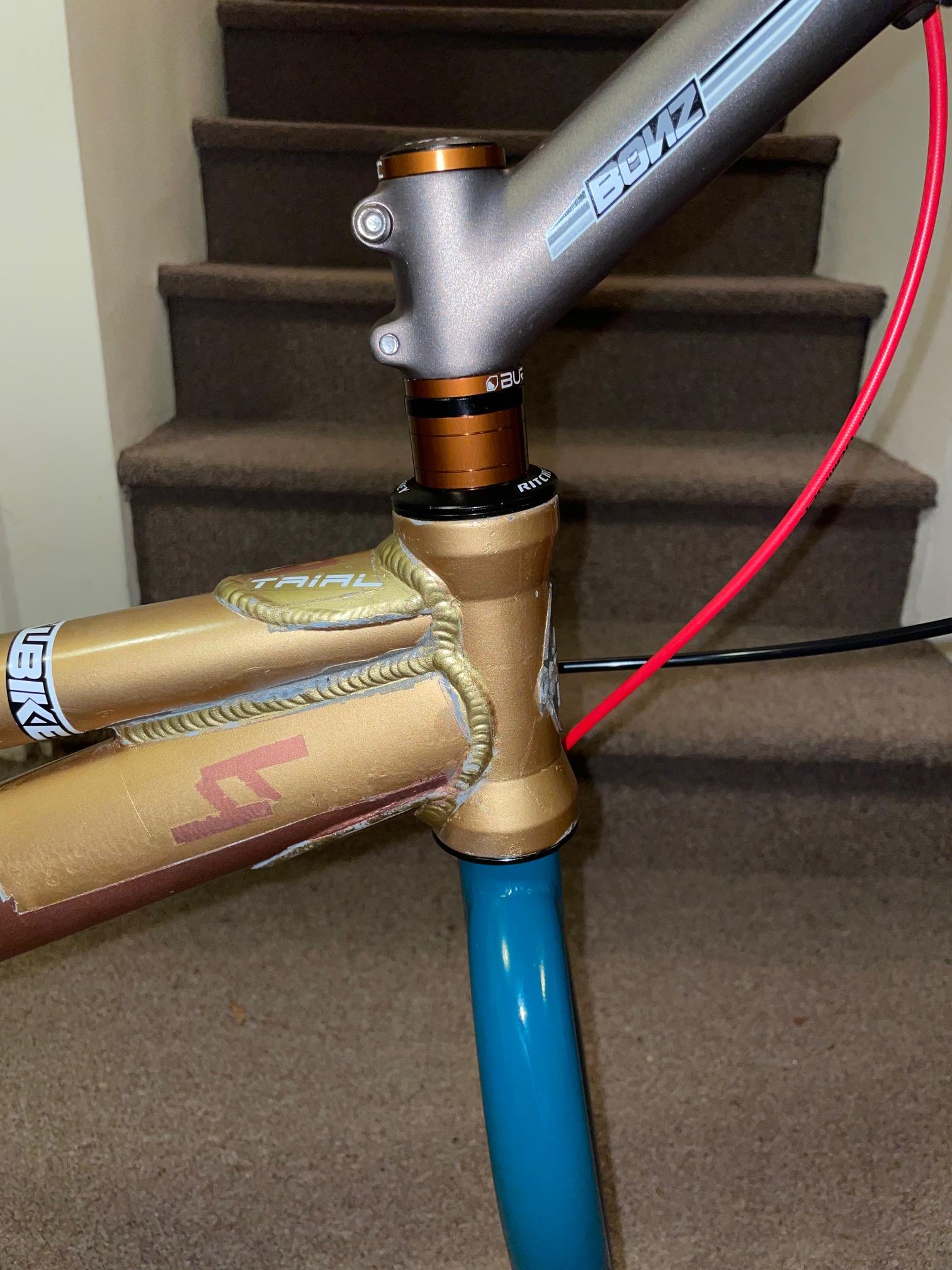

  17. DAY 9 On Wednesday the fork came. However, I had no spacers around, it was too late to go to a nearby bike shop (they were closed on Thu too) and was afraid to cut it at the minimum length (with no spacers) so it had to wait for a couple of days before going in. Ordered from ebay a few bronze painted spacers that I think will blend with the frame. Should be here tomorrow.

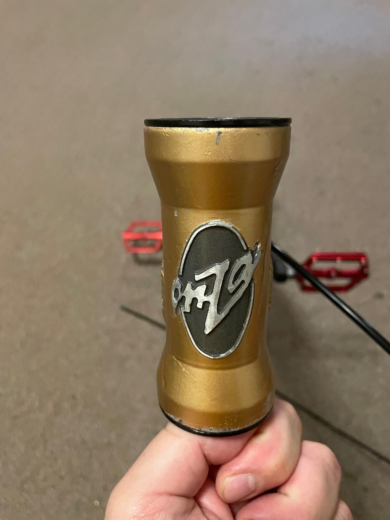

  20. DAY 7 Ritchey headset came today, I already had the headset press out in waiting. Once I checked a few cup dimensions by digital caliper, it went right in. My worries were unfounded, both cups sit flush. But there is a reason for it, and I had an inkling it might fit based on drawings found on Ritchey website- the entire height of the cups is 10 mm, out of which about 2 mm is the lip (sitting outside the head tube), and the beveled part (the one in contact with the head tube chamfer) is another 2-3 mm, so the straight part had to be less then 6 mm. The head set is built around retainer/cages bearing, not the cartridge bearings that a majority of headsets I know of use. The retainer bearings are very slim, almost half the height of a cartridge bearing, hence allowing for a slim cup as well. It is the only ZS44/28.6|ZS44/30 headset Ritchey makes anyways so it was an easy choice. I would be happy with a retainer bearing headset, except I have never used one before, so not sure how it will weather. One of the reasons I installed it as such is precisely to find that out. If the bearings do not last, it is easy to take cups out and install a different headset altogether. And if I do not like the way it feels while turning the handlebars (gritty, etc), what I will probably do is take the upper cup out and install a cartridge upper headset like the FSA Orbit Z, as the head tube is deep enough on top to allow for a regular cartridge bearing cup. For now it stays in as it is for testing. Fork has to be coming any day now so the initial testing (without a front wheel) should be happening soon.

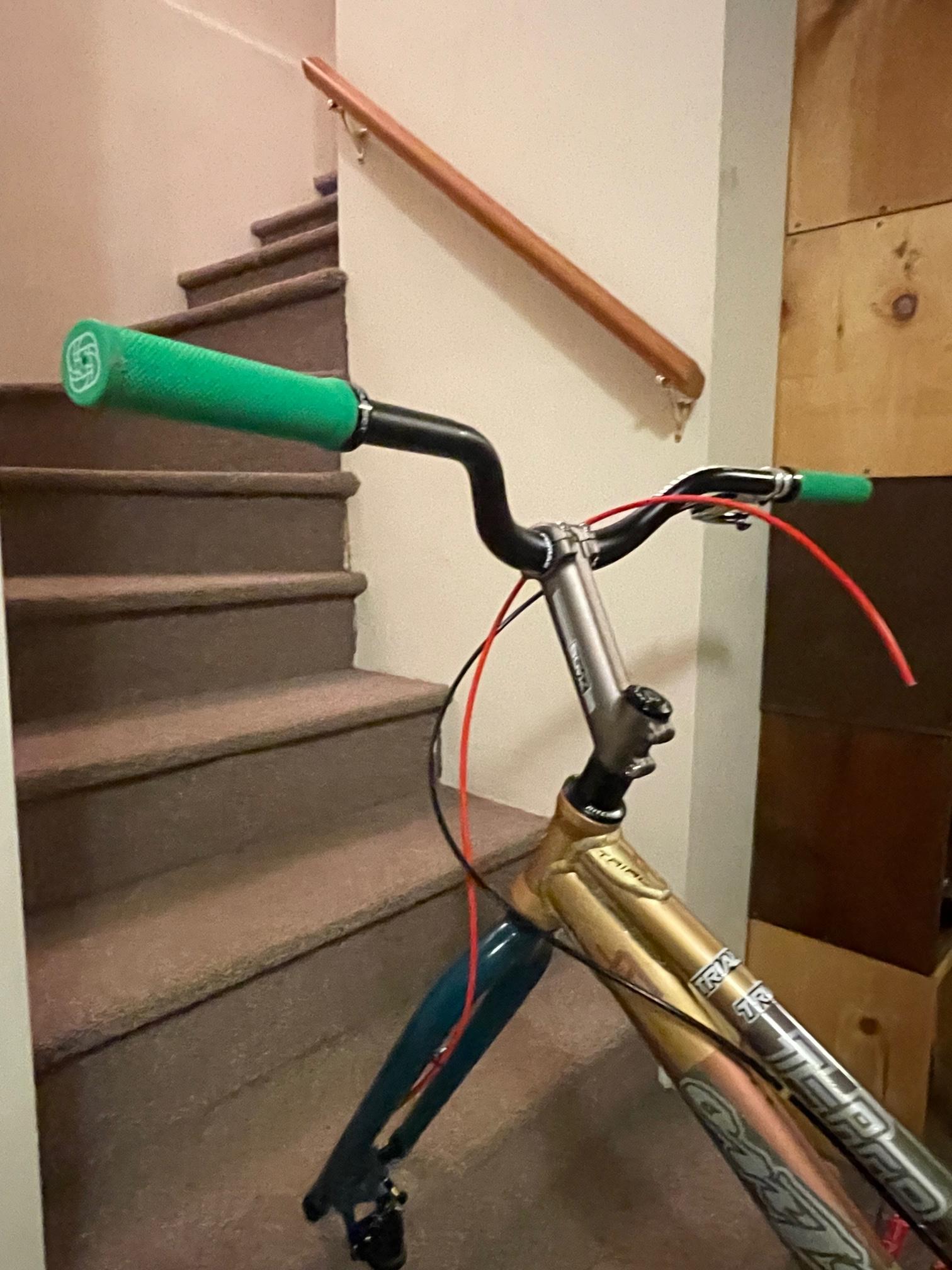

  21. Ritchey headset came. When I bought it I did not realize it is of a caged/retainer design (so the Ritchey version of the FSA No.10) but I guess it's the compromise you need to make if you want that lower cup all the way in, as the retained bearing being small profile allows for a short cup. Had to check for fit immediately so in it went! Fits perfectly! Here's the lower cup, the iffy one.
  22. I was just watching a brake review on youtube and the guy said when he installs lever on the handlebar he undertightens bolts a bit so that in a crash, the levers will rotate on the handlebar as opposed to snapping. Sounds like a good advice, will try doing that from now on.

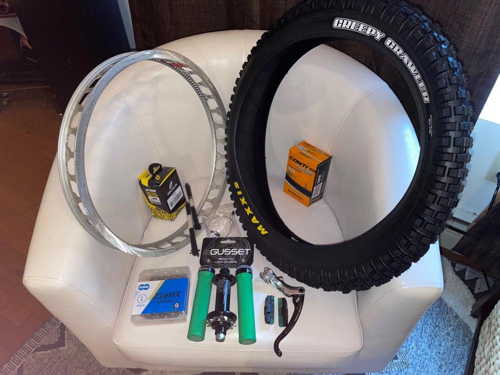

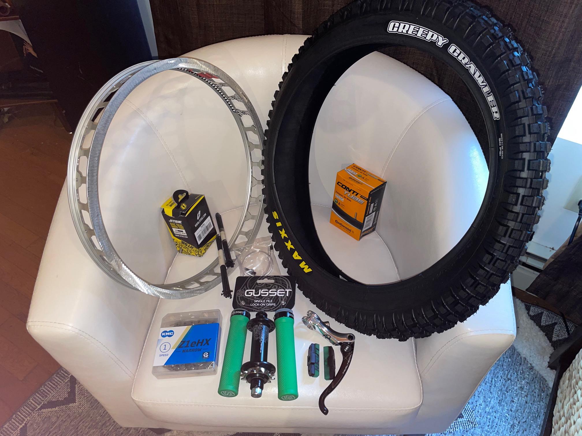

  24. Ordered a bunch of stuff from Tarty. Besides the rim, hub, spokes and sprocket already mentioned: chain (3/32), grips, rim tape, inner tubes, 19" tire (Maxxis Creepy Crawler), brake lever, aftermarket Hs33 pads (at Tarty's recommendation -Coustellier 8mm- as they mentioned over the phone that for only 6 pounds they can grind the rim for me but stock Magura pads are not a good idea with that). Once all this stuff comes and it's on, provided the headset won't give me much grief, the only thing needed for the bike to be complete is a front wheel.

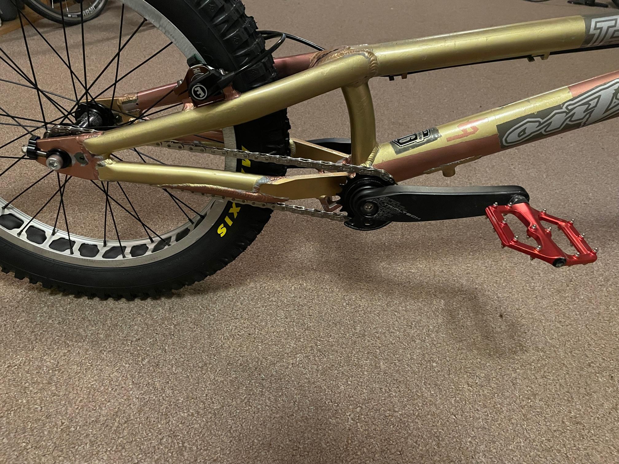

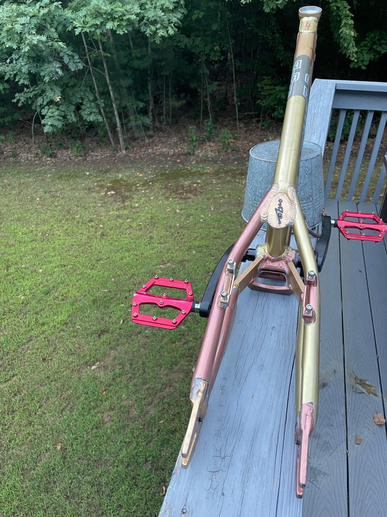

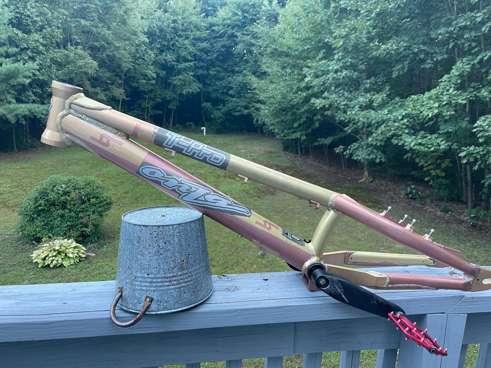

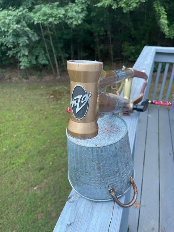

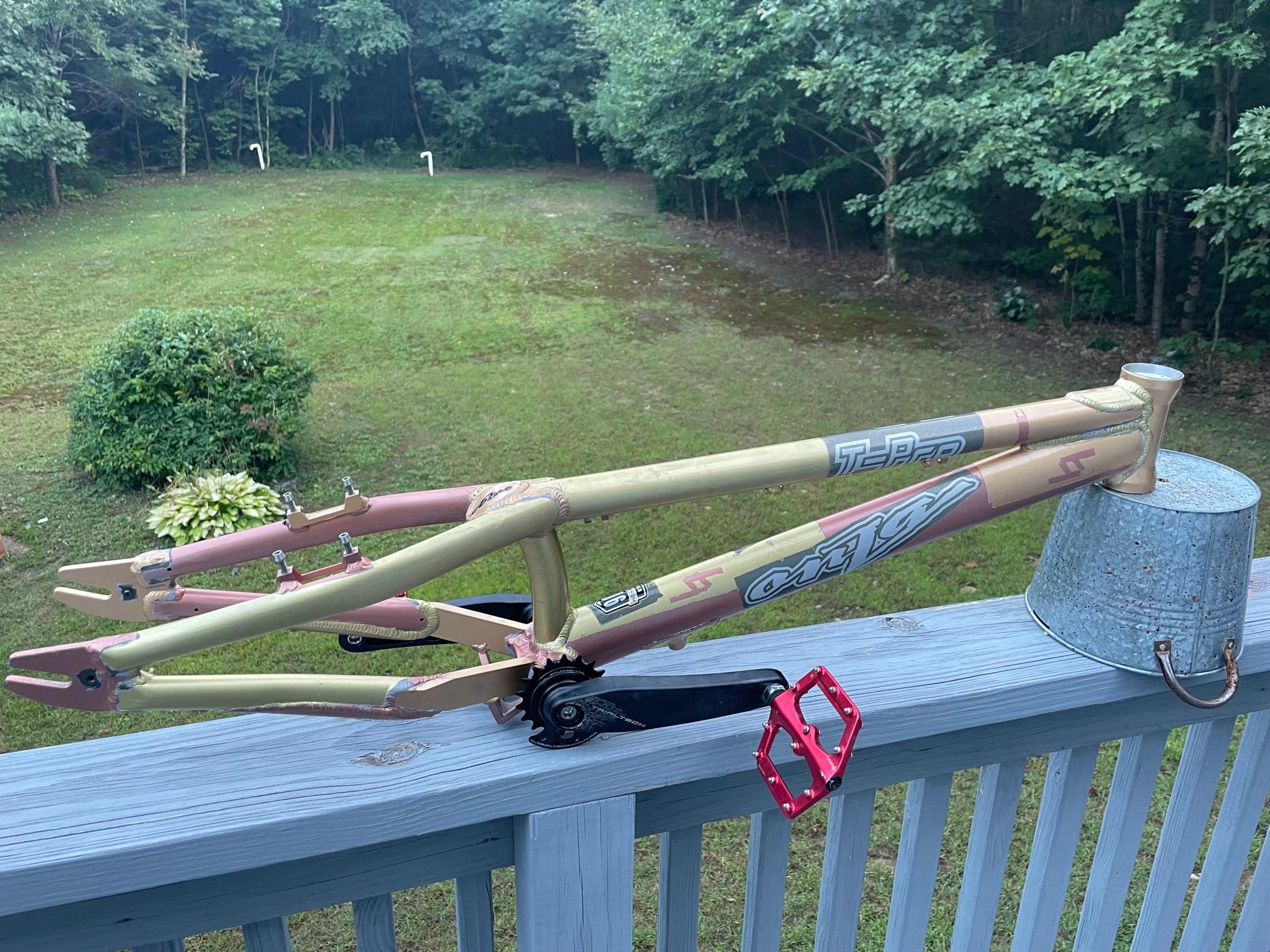

  25. DAY 6 Primer came- frame fully painted. Does not look anywhere near professionally painted but it was my first time painting a frame (first time painting any metal implement really) and the scope of the endeavor was multifaceted. One, wanted to personalize the bike-check. Two, wanted to learn how to paint a frame. Partly checked- the most important thing I learned is that I need how to learn to have patience until things dry fully. I was impatient at times- clear coat over paint too soon, peel masking tape too soon, etc and it shows. Three, needed to test the three metallic paints I used (copper, brass, bronze). Check, but with surprising results. I expected to like the copper the most, I don't. But the bronze really grew on me. Unfortunately it got the least use on the frame. I have a Campagnolo Athema groupset I pulled from my road bike (replaced with Record) and I bought a steel road frame to build using that groupset. I will need to paint the frame, and I was thinking of using a combination of the same colors as in the Onza. Seeing the results, I will have to reconsider the whole paint scheme.
