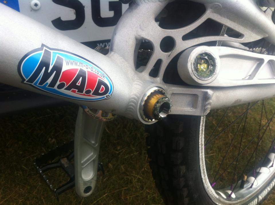

I personally would buy an Alloy pre-load adjuster when available, use x1 spacer each side of the bottom bracket cups and use alloy BB30 axle spacers to adjust chainline/excess.
The more thread contact holding your bottom bracket cups into the frame the safer
http://www.wiggle.co.uk/race-face-next-sl-cinch-crank-arm-bearing-pre-loader/

BB spacing
in Trials Chat
Posted
Rotor make alloy spacers in 2 sizes 5.5mm and 8.5mm, see here - http://velotechservices.co.uk/shop/vprod4.asp?cat=7386000657&PageOrder=0&PagNo=1&ipp=9999
I would use a combo of them for the spacing of your cranks and chain ring/line, and have the bb threaded fully into the frame or 1 spacer each side if it was me. Looking at the picture of your left hand (non-driveside) bb cup, you really can't have much thread contact holding that in?
For the alloy pre-load ring contact http://www.silverfish-uk.com/
