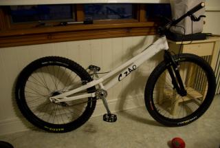

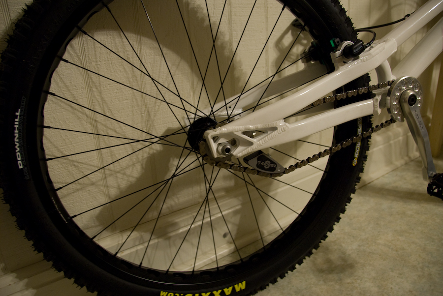

So here it is... after a few bumps in the road getting parts It's finally done, here is a part list and 2 pics I snapped.
Czar short frame
Echo Urban fork
King NoThreadset headset
Middleburn cranks with the Heatsink bashring with 18T cog
Truvativ Gigapipe DH BB
Wellgo MG-1 Pedals
Echo Hifi 130x15 stem
Trialtech bars
Racer's edge foam grips
HS-33 front and back
Coust pads
Trialtech rims laced to King ISO hubs
King Cog 15T
KMC Cool Chain
74 Kings tensioner
Maxxis Larsen TT front tire
Maxxis Minion 2.5 rear tire
Maxxis Welterweight tubes
hey that looks awesome! if i ever get round to getting another trials bike that is definatly a choice i'd go for, whats the geo??
Here is the Geo from Tarty, they measured using the same fork so this should be spot on.
Wheelbase: 1075mm
Chainstay Length: 385mm
BB Rise: 35mm
Head Angle: 71.5 degrees
Centre of BB shell to top centre of head tube: 655mm (25.75")
Thanks for the compliments guys! It was a good bit of working getting all of the exact parts I wanted in the states.
