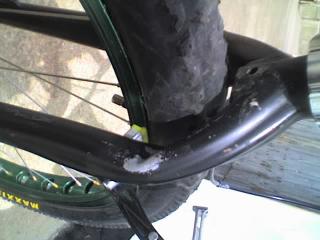

Get a steel fork then - even if it does break, it'll tend to give you some warning through creaking/flex rather than the first thing you know about the fork being broken being when you're picking yourself off the ground... I got an Onza Tuf Guy to replace my snapped Urban - geometry feels exactly the same, weight isn't noticeable either.

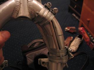

errrm yea, they didnt last long ('tuff' guys)
Edit:
oh yea!! and another pair of urbans... btw i didnt run a front brake on these (as i didnt have one) hense why they lasted a bit longer (one month)
Edited by adrian@eastcoasttrials
Your picture of the Tuf Guy actually proved my point - everything breaks, but steel forks tend to bend rather than snap, so they're less likely to kill you in the process :)... I've broken/cracked a lot of steel forks and apart from a couple of steerer failures back in the 1" steerer tube days they've all creaked, flexed and bent rater than snapping without warning like the urbans I broke recently.
