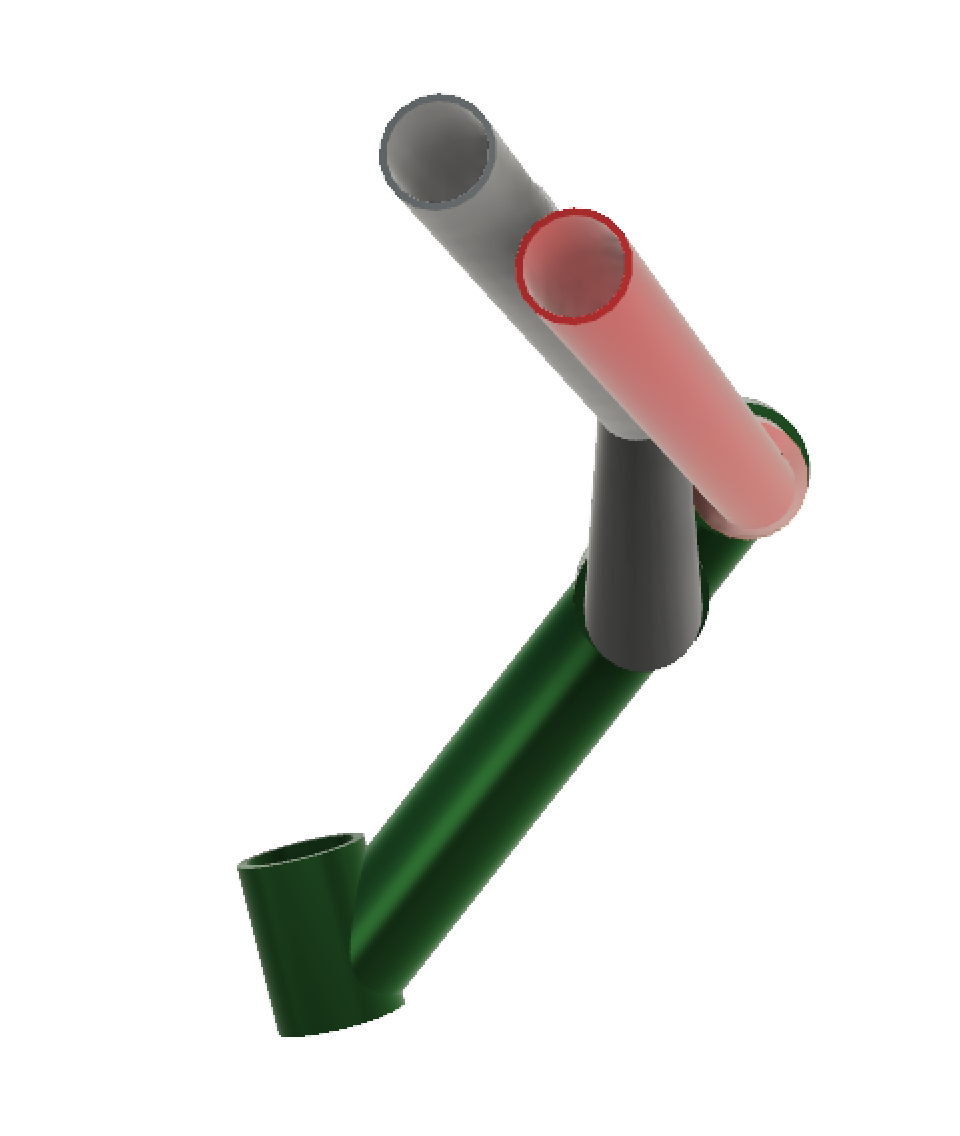

Check out some drawings (you can see and download the Fusion 360 3D model here). Notice that "upsweep" and "backsweep" angles are a single angle in 3D space.
Here is an overview of my 3D model, it's a dual-height stem: 135 mm & 175 mm, respectively, angle is 35° . The bars are roughly modelled after H1 and H2 mentioned earlier. In this drawing the riser bar and the flat bar have the same angle to make the comparison more obvious:
5a9acc357ac75_2018-03-04-002344StemBarHomeview.thumb.png.fca69f75220c9b1963b637603a545317.png

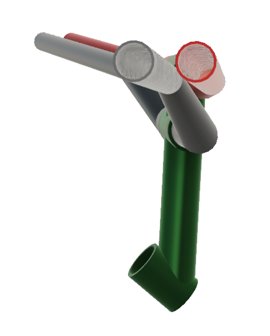

Now let's check out some views. First, this is what the set-up would look like when the bike is on two wheels. In this example I've position both bars so the grips are parallel. You can see the riser bar places the grips slightly higher:
5a9acd1ecc038_2018-03-03-234445BarStemtwowheels.thumb.png.8a34bf126e89eff953c481123290d6f1.png

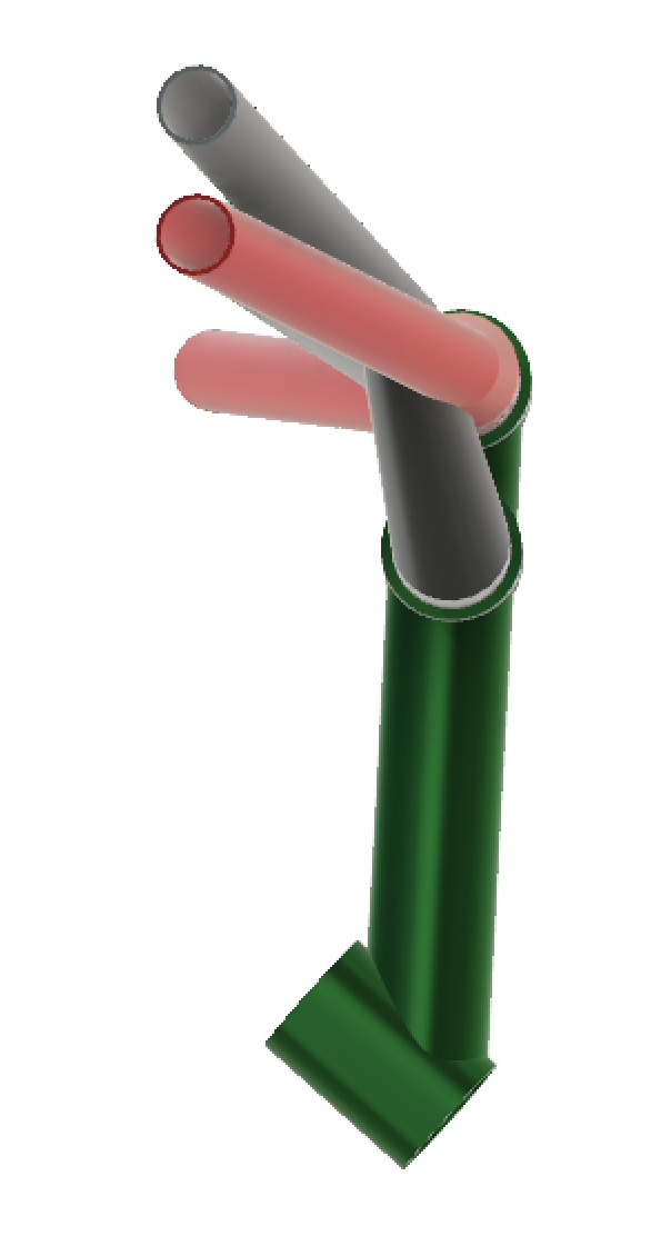

Now here's what the above assembly looks like when the bike is on the rear wheel. Her you can see how the riser bars are much closer to the rider, which means the front wheel must be further from the rider:
5a9acdc50a33f_2018-03-03-234338BarStemRearwheel.thumb.png.9bfdb93b01db44eb43b1b1b972ba7226.png

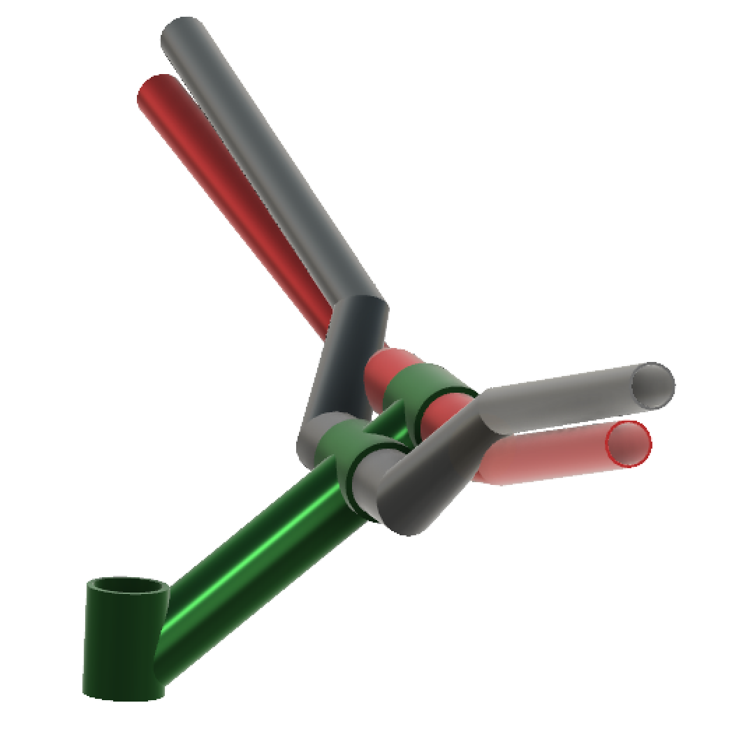

Because riders want the front wheel closer to their body to make rear wheel moves easier, they compensate by rotating their riser bars forward, as shown below. Unfortunately, this causes overpronation of the hand, when the hand's natural position is one of slight supination. Here's a video showing what those fancy words mean. It also casuse uneven pressure distribution over the palm of the hand, specifically putting more pressure on the area of the palm at the base of the pinky, while the area at the base of the ring finger does less work. This can cause hand and wrist pain and flappers.
5a9ace18b2d6d_2018-03-03-234552BarStemcompensating.thumb.png.bb2a5e2a8152f1eed06ab5dc7f8ed2b6.png
