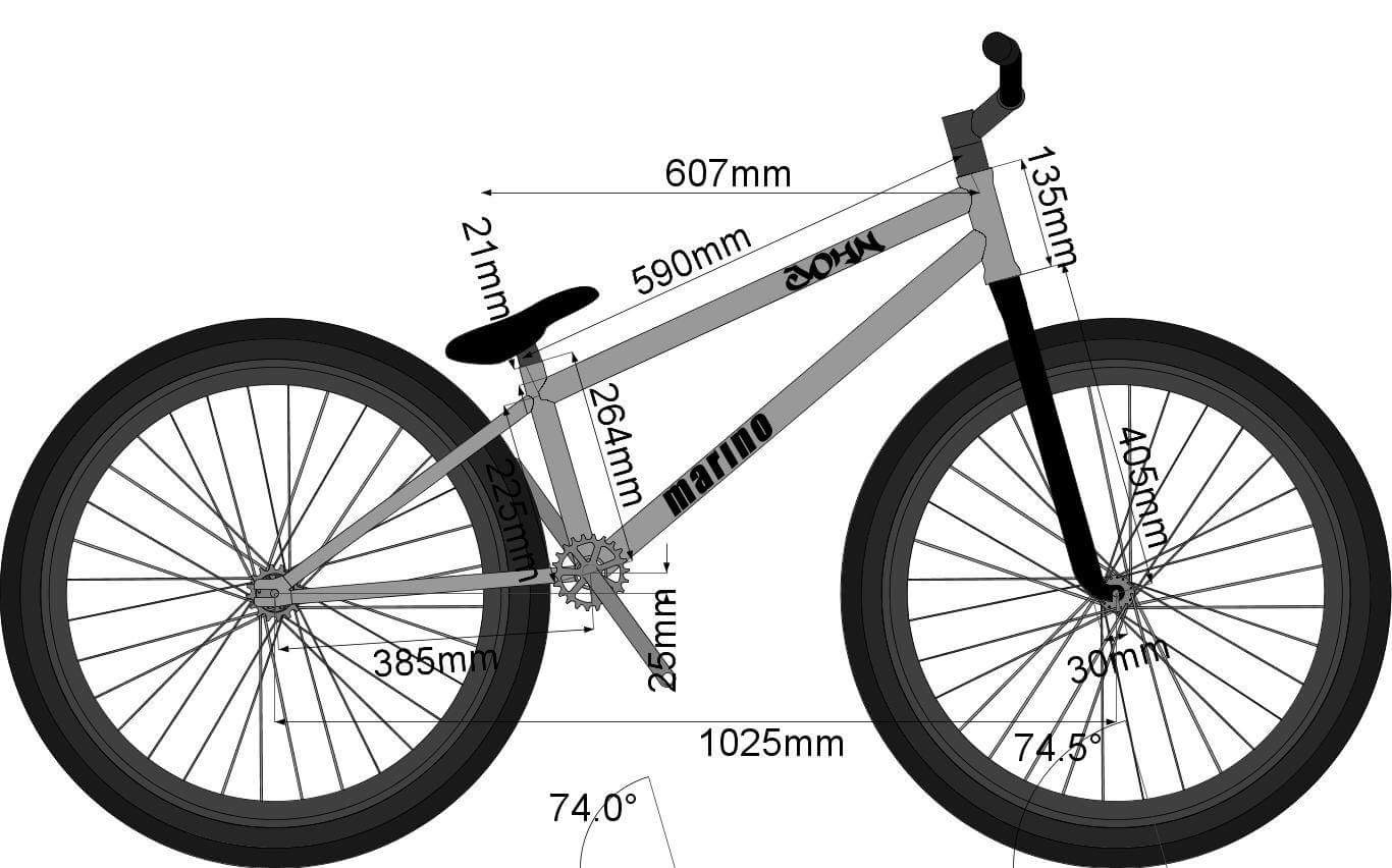

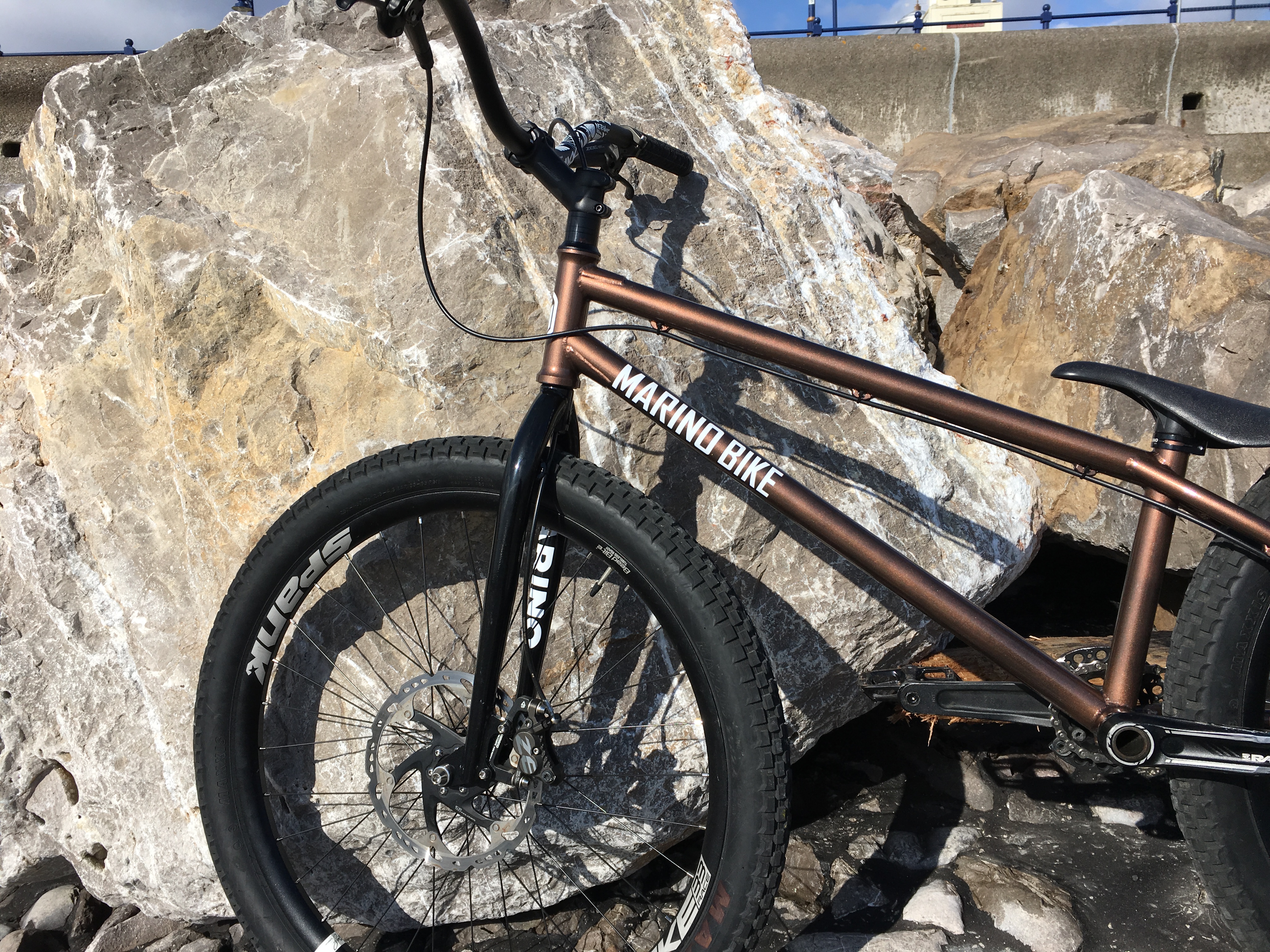

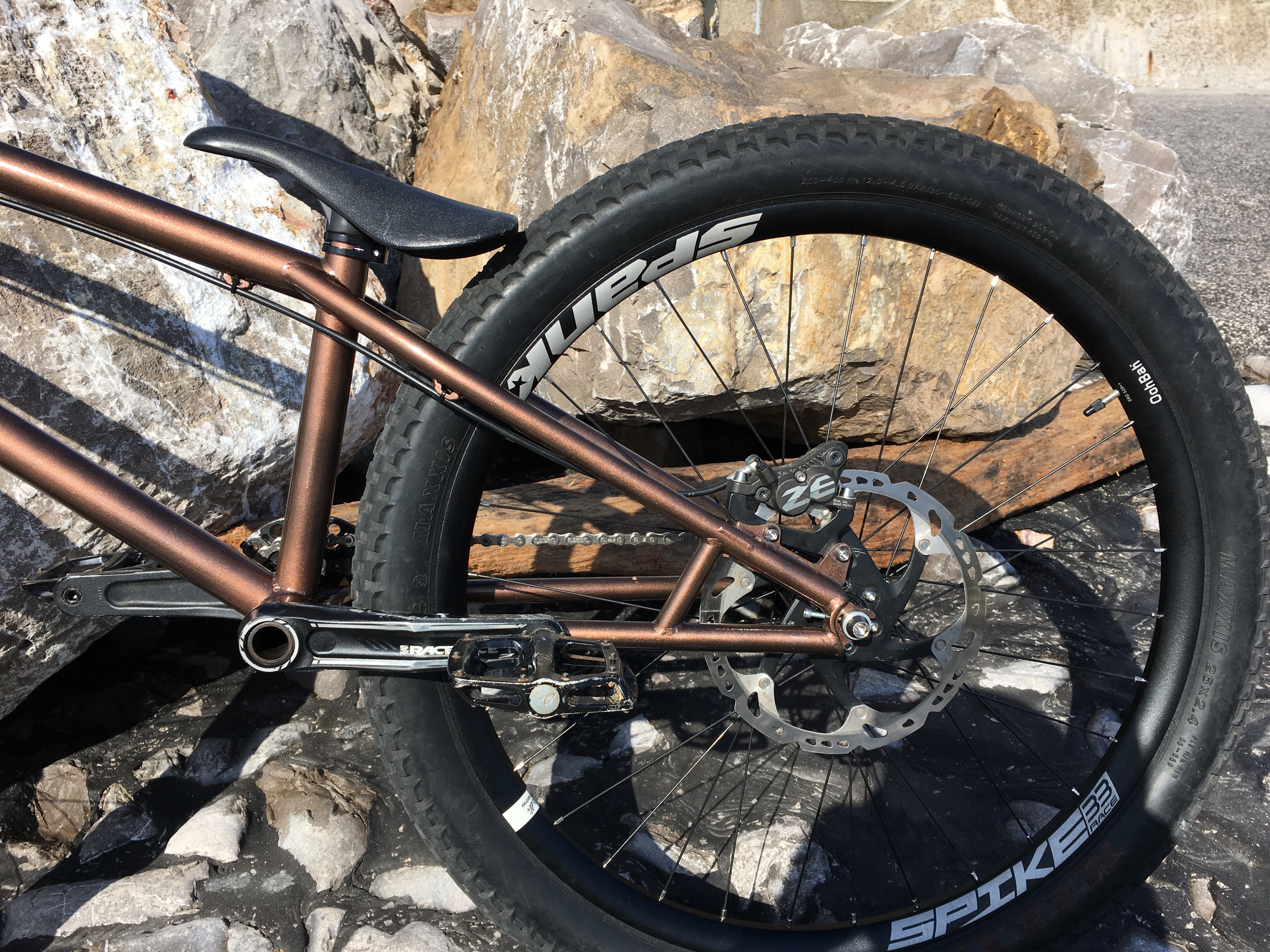

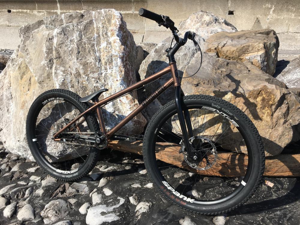

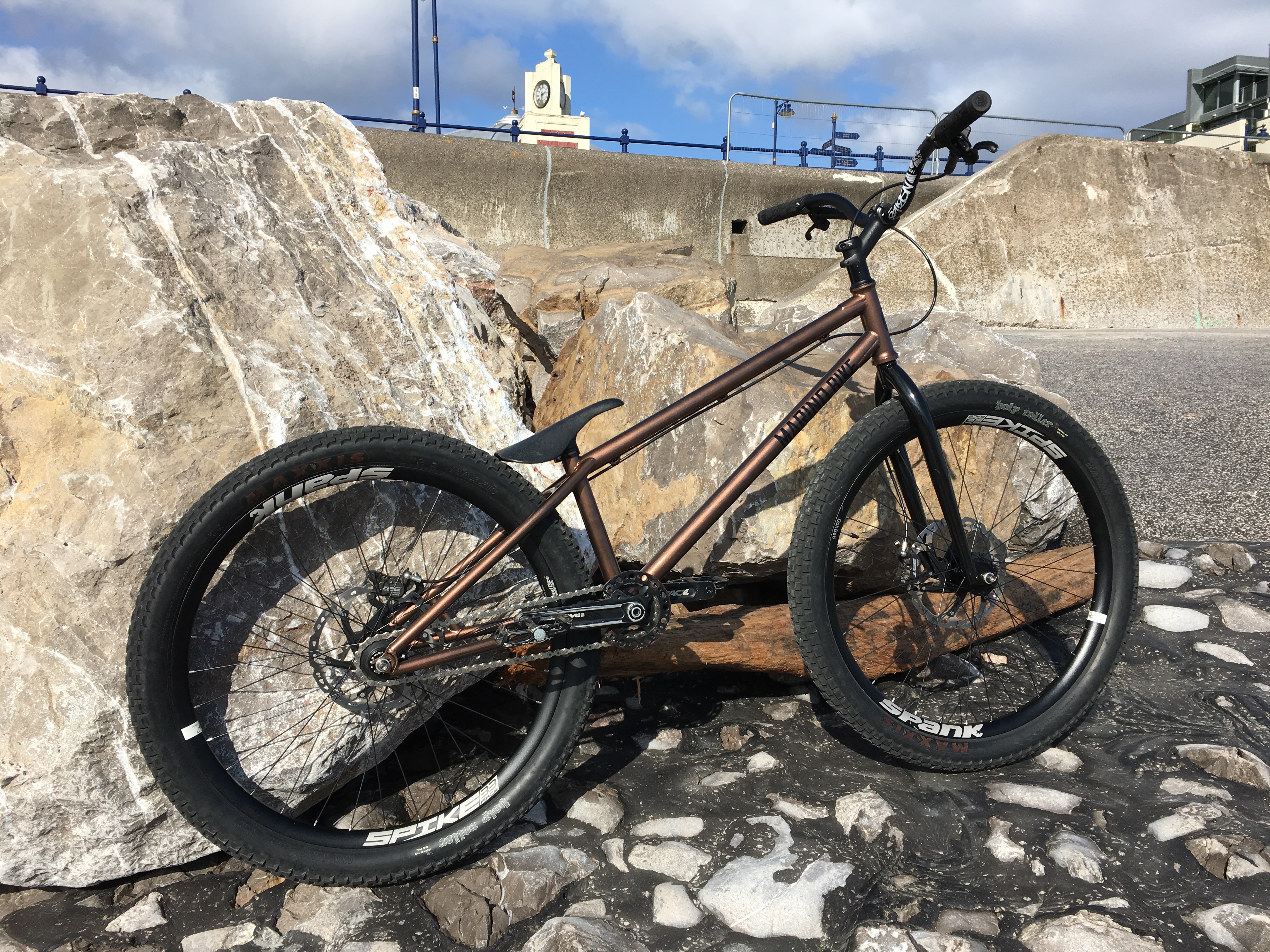

New bike built today huge thanks to @marinobike for working so hard to get this frame to the spec and geometry I've wanted for a while
PARTS........
Frame/Forks - custom 26inch MarinoBike
Bars - NS Proof/ Sam pilgrim
Stem - BBB 90/35
Headset - cheap bmx one
Grips - Mafia bmx/ Harry main
Brakes - Shimano zee 4 pot
Brake pads - EBC Reds
Rotors - Shimano XT 203mm
Bottom bracket - Shimano XT
Cranks - Raceface turbines 175
Front sprocket - Shimano 22T
Pedals - Dmr V8
Bash guard- custom made / Euan beaden
Chain - kmc z610
Rear sprocket - onOne 17T
Hubs - Hope Pro 4 trials/Standard front
Front Axle - custom made / Euan beaden
Rims - Spank Spike 33s
Tyres - Maxxis holy rollers 2.4
Saddle - Affix bmx
Bolts - Titanium throughout
