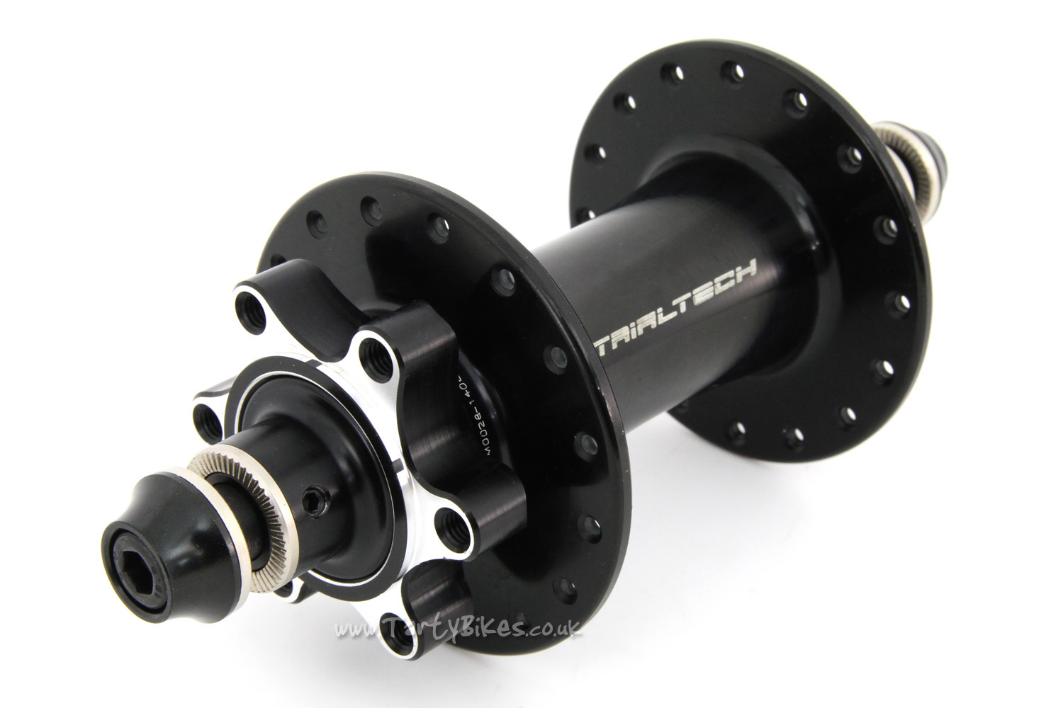

Do you know which XT hub it is exactly? Pretty sure it's not possible to convert to 'proper' bolt-on if we're talking Hope Pro 4 style where the 10mm bolts are the axle... However it is possible to convert a standard QR axle to take M6 bolts if you cut new threads into the axle on both sides (pretty simple and cheap to do yourself if you have access to a tap) - so it ends up like this Trialtech hub:

I’m glad you mentioned tapping a thread into it because I’d considered it already anyway! I’ll bring my tapping gear home from work tomorrow and go at it :D
its the latter type with the spanner flats for cone adjustment. I had guessed it to be doable since it wouldn’t be hard to get the current axle out. There isn’t much meat poking out either side of the cone adjusters though which worries me slightly; doesn’t look like there will be much in the dropout!
ill report back tomorrow if I get a chance at it
