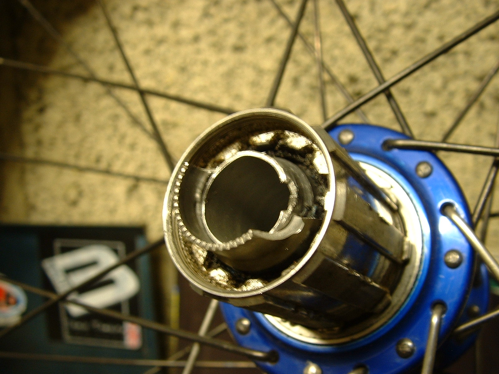

Just had the same trouble a few weeks back. Put a topic up, and as expected the mechanic maniacs helped out (cheers!) and so now my hub is on the other side of the world being fixed saving me £50 or£100! :) 'King were very helpfull, simple and clear, after a few emails too and from Adrian Knapp at info@chrisking.com he sorted me out with prices, shipping details, addresses (Y) Hasn't cost me anything to get it repaired other than £16 to post it over there.
This is what i did to mine;
[attachmentid=7927]
I recommend you dont touch it, as i tryed to do (i tryed to undo the axle mangling it abit,and still 'King said it was ok :blink: ) Then email ^^^ 'King explaining the situation and im sure they'l sort you out with a new axle.
