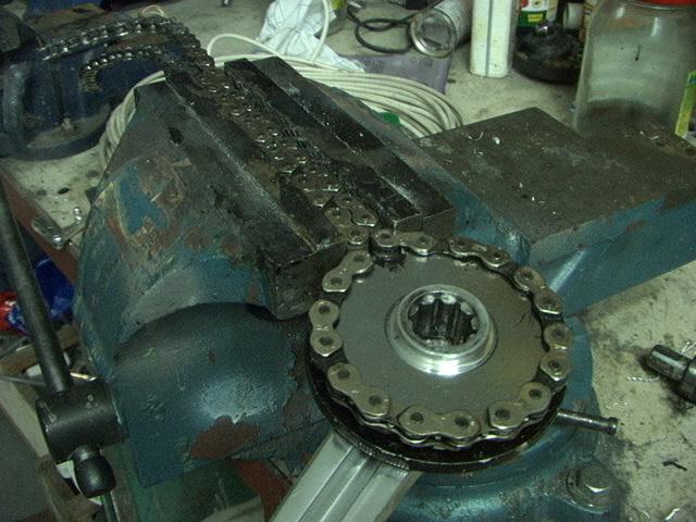

Right then. This is for chainrings only. Freewheels need a special key although the idea is basically the same. (Added a short ACS removal guide at the bottom)
Mounting the cranks onto a vice
Self explanatory really, don't need to write anything yet do I?
Well, actually I do - the vice needs to be done up really tight!

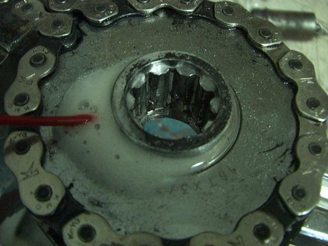

1st step of making our job easier
Flood the space between the cranks and chainring with WD40. Leave it for 10 minutes until it soaks through

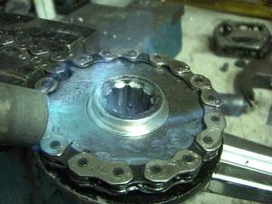

2nd step of making our job easier
Heat the chainring up with a blowtorch, try not to heat up the crank though!
This took me about 2 minutes or so. The chainring needs to be really hot!
WD40 is flammable but it burns slowly so don't worry.

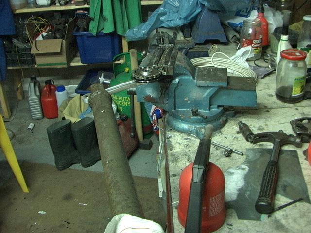

Undoing it!

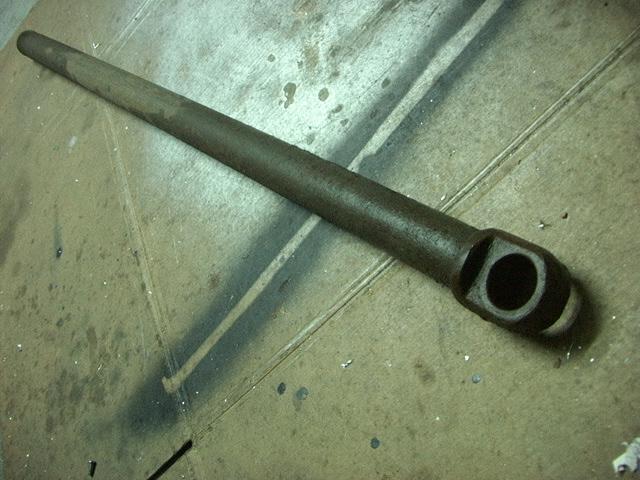

The tool. Slight overkill but it works. I wouldn't use anything shorter than 3ft.
This thing didn't dig into my cranks at all.
You might want to put some wood between the cranks and your "tool" if you're using something sharper or have i.e. black cranks :)
Turning towards the left of the pic.

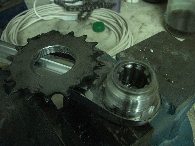

The better the grade of aluminum in your cranks, the easier the chainring will be to undo. In my case, I only had to do a small turn with the extension and I could undo the chainring with my hand. With weaker cranks ie. 6061 alu, you might have to do a few rotations with a long extension before you can undo the chainring, this is because the threads can bend.
Well done!
