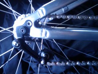

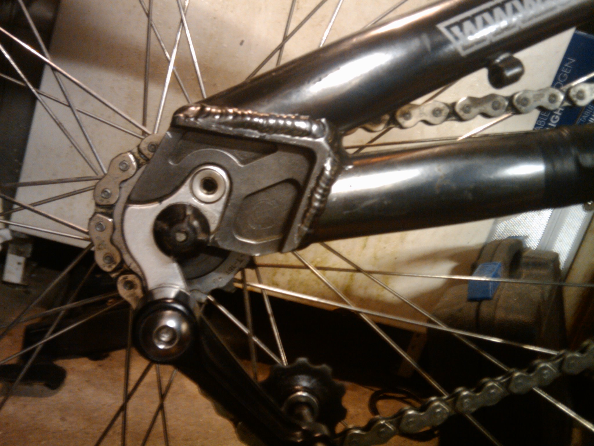

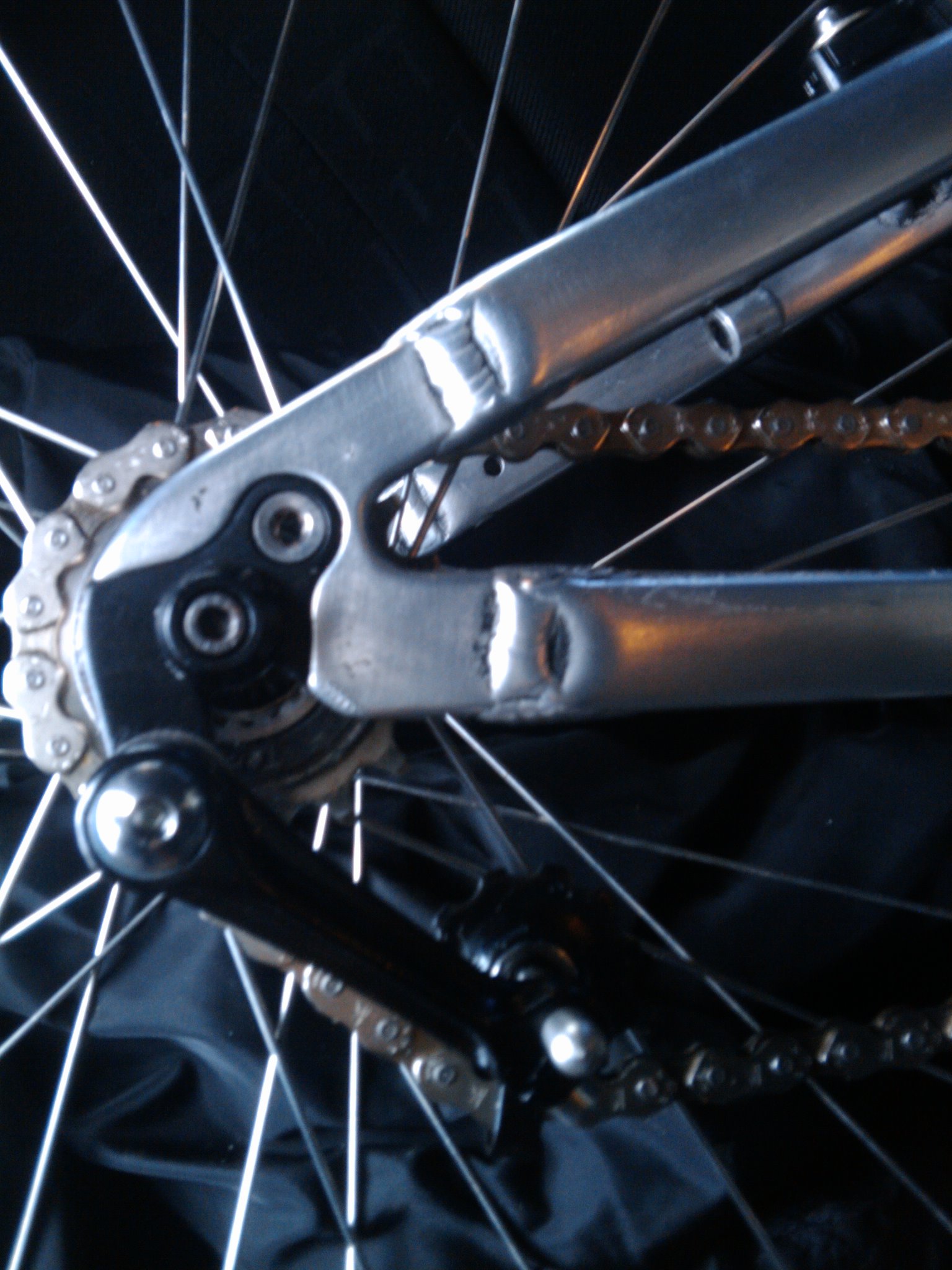

Ok guys... have tried to turn the tensioner around and that didnt work, not enough space etc. Tried using no tensioner, chain is too short or too long... I ended up putting an old rear mech on which is what I really didnt want to do, but its worked. Hey presto! end of chain skip issue!!! BUT the freewheel is still crunching... feels like the bearings are mashed or something. Guess Ill just have to get a new one... anyone reccomend a STRONG freewheel? Not bothered about clicks, as long as its more than 24? BTW check out my other bike's chain wrap... explain to me how this one never ever skips Pics below
Chain line is dead straight, dead straight to chainring and on the tensioner... Im kinda hoping right now it IS the tensioner!
Really? I will give it a go, but its a cheap tensioner and not sure itll swing that way happily. Im really confused at how my other setup is fine and has even less wrap but absolutely no skippage at all. Will try that though! Cheers!
Hey guys Hope someone can help me. Ive recently moved towards rear freewheel and have aquired a back wheel with a tensile 60 click freewheel on. The last owner said it never skipped and was regulary serviced and has had one recently. It is used though, but seemingly not very much. Ive fitted my new KMC Kool and a tensioner and shortened the chain as much as I can to get the best chain wrap. Initially I didnt shorten it enough and the chain wrap wasnt too good. The chain skipped off the freewheel a few times just light pedaling. So now Ive shorted it as much as I can (see pictures) and on the very odd occasion it skips whilst pedaling, not when kick-hopping though. If I put a lot of pressure in, it sounds like the chains grinding against something, like the freewheel and if I carry this on, it skips and the chain/pedals jump forward a bit. When I held the freewheel and spun the wheel, I cant feel any notches so it APPEARS the freewheels ok... but Ive got better chainwrap on this than my older setup (but that was a different bike) Can you techies look at the piccies and give me your humble opinion?
