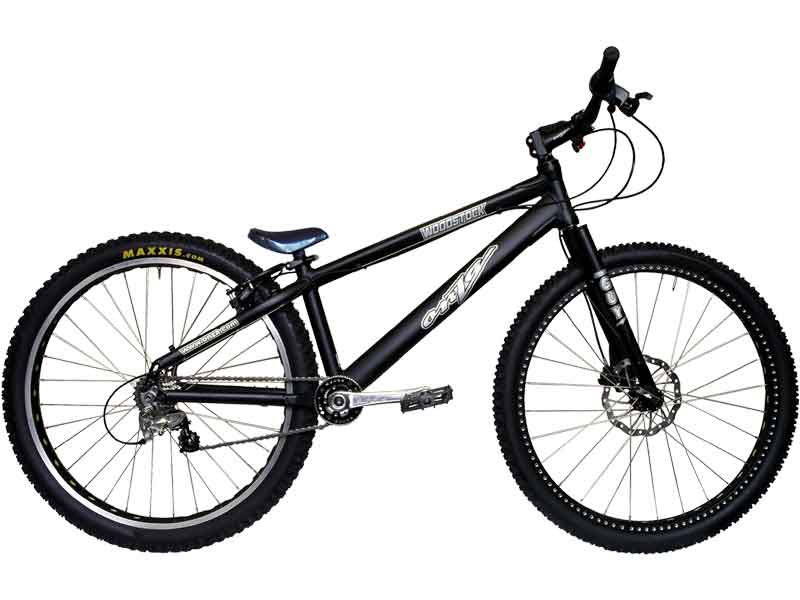

    325
Everything posted by † CETFLY †
  1. Lol I think I may already have the Echo rear rim http://www.tartybikes.co.uk/product.php?pr...;category_id=87 As it looks identical to the one in that links picture. I cant tell though as theres no brand name on it. From the research Ive done, a couple of PM's (thanks) its seeming to be mainly down to tyres and tubes. I may be splitting hairs here, especially on the rear rim anyway. The front is light enough, but I can try the different tyre combo swap first. I cant see me needing anything too strong or heavy on the front in terms of rims, as anything I'm to be doing will be loading the rear mainly. Yeah I agree with what youre saying about the rims. Ive gone through all this stuff with my XC bike. Its a nice wallet lightening exercise! On the scales my Onza weighs around 13kgs. I couldnt believe it. I wanted to get a lighter weight rear mech (I dont want to go single speed) but they arent cheap either for a high quality unit. I'll lose these 2Ply Minion Super Tackys which are the heaviest of the range and try to find some Continental Rubber Queen 2.4 for the rear and the Mountain King for the front. That Mountain King has a pretty good write-up on Tartybikes. Sounds better than the Try-All for grip but it didnt fair too well in reviews I've just read. I hope its wide enough. Some people including Tartybikes say its really narrow and more like a 2.0 or a 2.1. Depends on the size of the rim to an extent though... My pedal are ok. Theyre Planet X dual cage. Can you put up some pics of your bike please? Would love to see it Thanks
