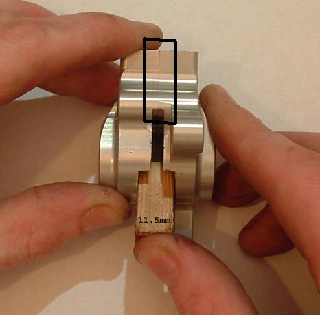

Hi just serviced my Hope mini 3 caliper and noticed a small leak coming from the caliper body itself .Iv taken it apart twice now to check everything is as it should be and it is, but the little bugger keeps leaking at the same spot . The bleed is perfect untill a couple of lever pulls and goes all spongy. I just wanetd to know if there is a fix for this such a sealent that can close the gap much like a seal on car engine cover . The diagrm shows where the leak is coming from thanks people
Well iv tryed again and again. Taken the caliper body apart cleaned the inside looked at the O ring and there is no split or holes present all refitted fresh bleed which is good, untill you pull the lever. Its still got a tiny tiny leak hardley noticeable really but its there. Im stuck for ideas now and thinking of trying to put some sort of sealent around the edge of the caliper to get a more perment seal any thoughts on this or sorting this pain in the arse will go a long way
I would strip it again as there might be the smallest particle of mud/dust causing it?
Was thinking the same thing lukas. But also going to check the O ring as suggested but cant see it myself as i was super carefull when replacing it but you never know its worth ago .
Did you rebuild it with new seals? There is a small oring between the halfs that could have a small nip or even just be too old to be effective. I would try changing that as a precaution and go from there.
No.7 on that diagram.
Yer all the seal were replaced when stripped down all the nuts are done up super tight to make sure. This has me stumped and in need of a fix asap .
