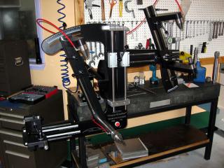

In the bike factorys they have a jig that holds the frame in position and holds the bits you need to weld on, its easy if you have the stuff, I would try a few local frame builders as they should be able to do it. The main thing is it has to be in the correct place, if you can get a man on the moon tjis should be simple, measure twice, once more for look and weld Some US links here http://www.sheldonbrown.com/rinard/framebuild.htm

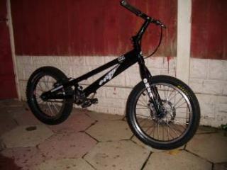

Thanks Bought a second hand but like new Onza Bird, 20" wheels cable disc on front normal brake on the back. He is 12 but about 5ft 7" tall, been riding BMX for the last year. I will show him it on You Tube, were could I get the DVD? Oh whats a track stand???
