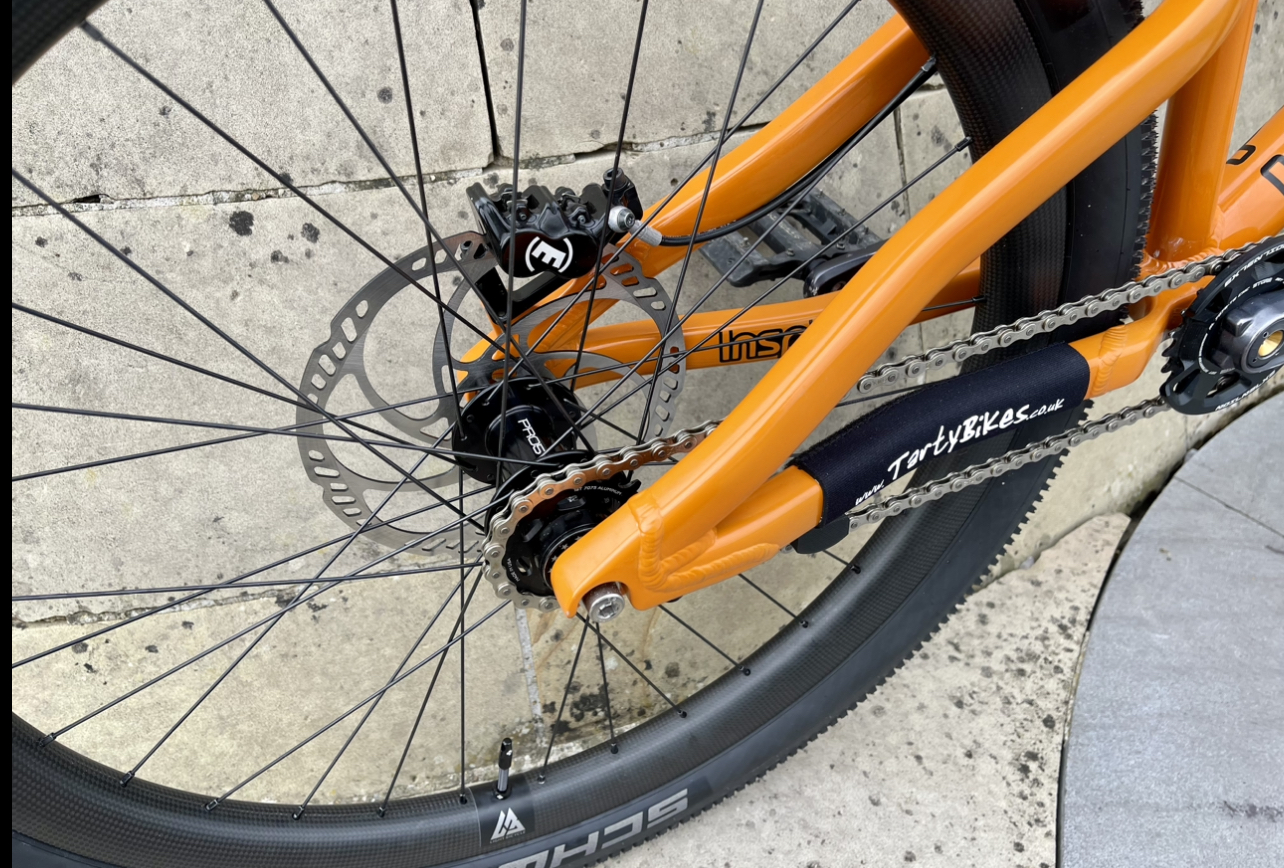

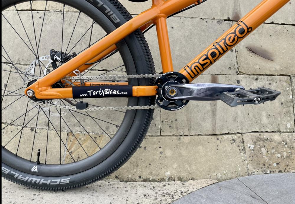

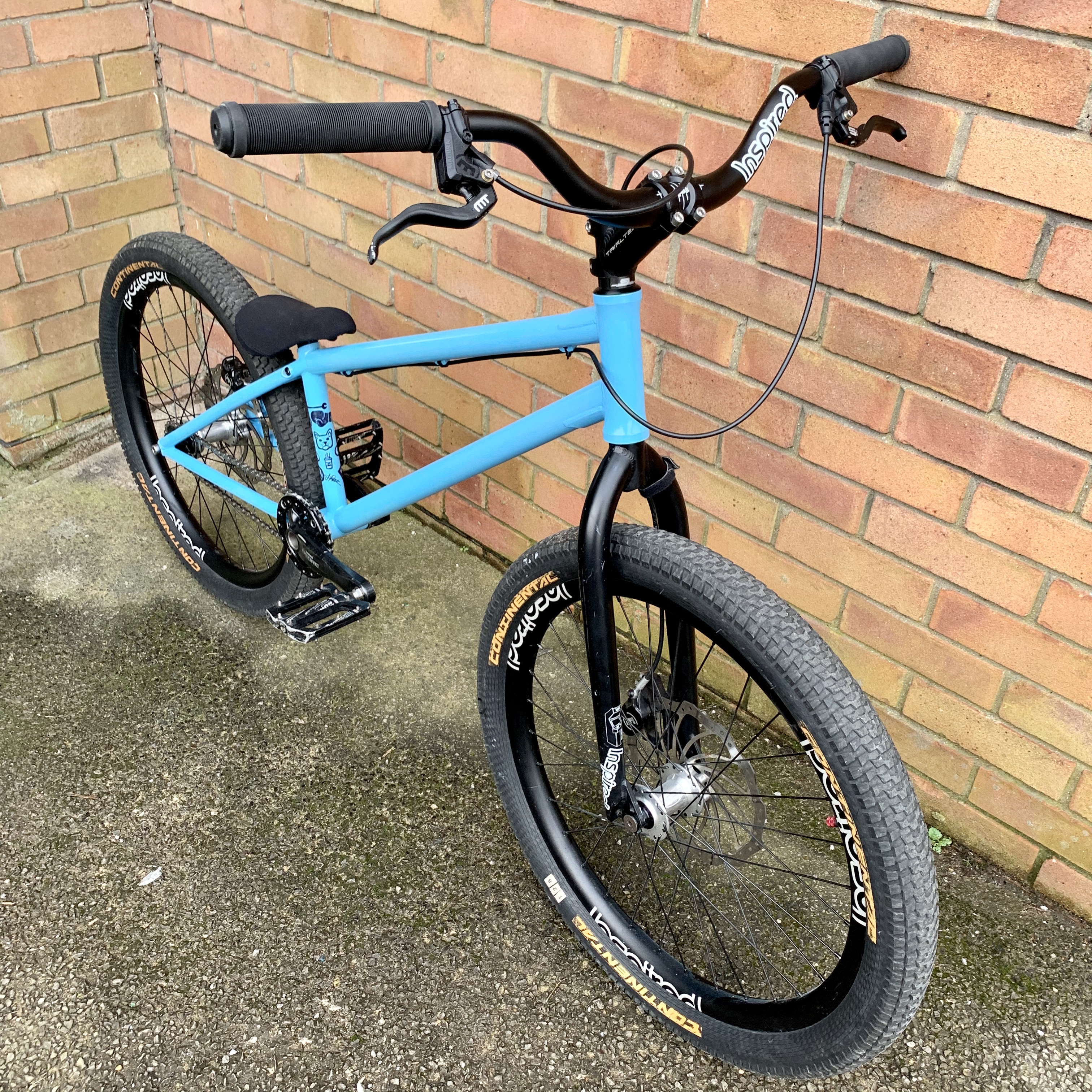

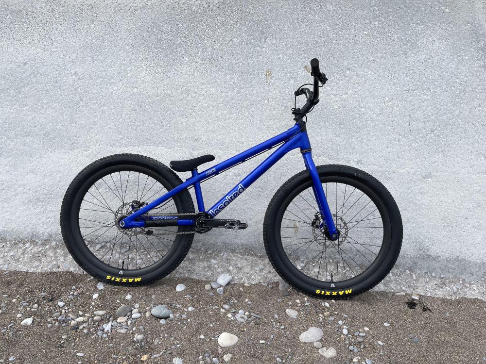

	As this as struck up quite the debate I can weigh the new blue setup. It’s had a couple changes so let me weigh it with some digital scales and post a picture of current set up! so since the orange bike I have changed the tyres to maxxis, pedals to hope, brakes to Hope, normal tensioner back on (waiting on a new 3D print for mine), longer stem and deity handlebars so it will be closer to 10kg I imagine now
	Pretty standard components . My tensioner is a custom made 3D printed one I created. It was set up tubeless and the tyres helped too! Plastic pedals combined with cranks with an aluminium axle is good. Maguras are really lightweight brakes too. My new set up is heavier but is the best I’ve had so far
	After the rear hub gave up on me on the Barcelona trip I thought it’s time to give her a makeover whilst the rear wheel was getting re built. Weight coming in at about 9.3kg. apart from titanium bolts no where else I’d really want to save much more weight.

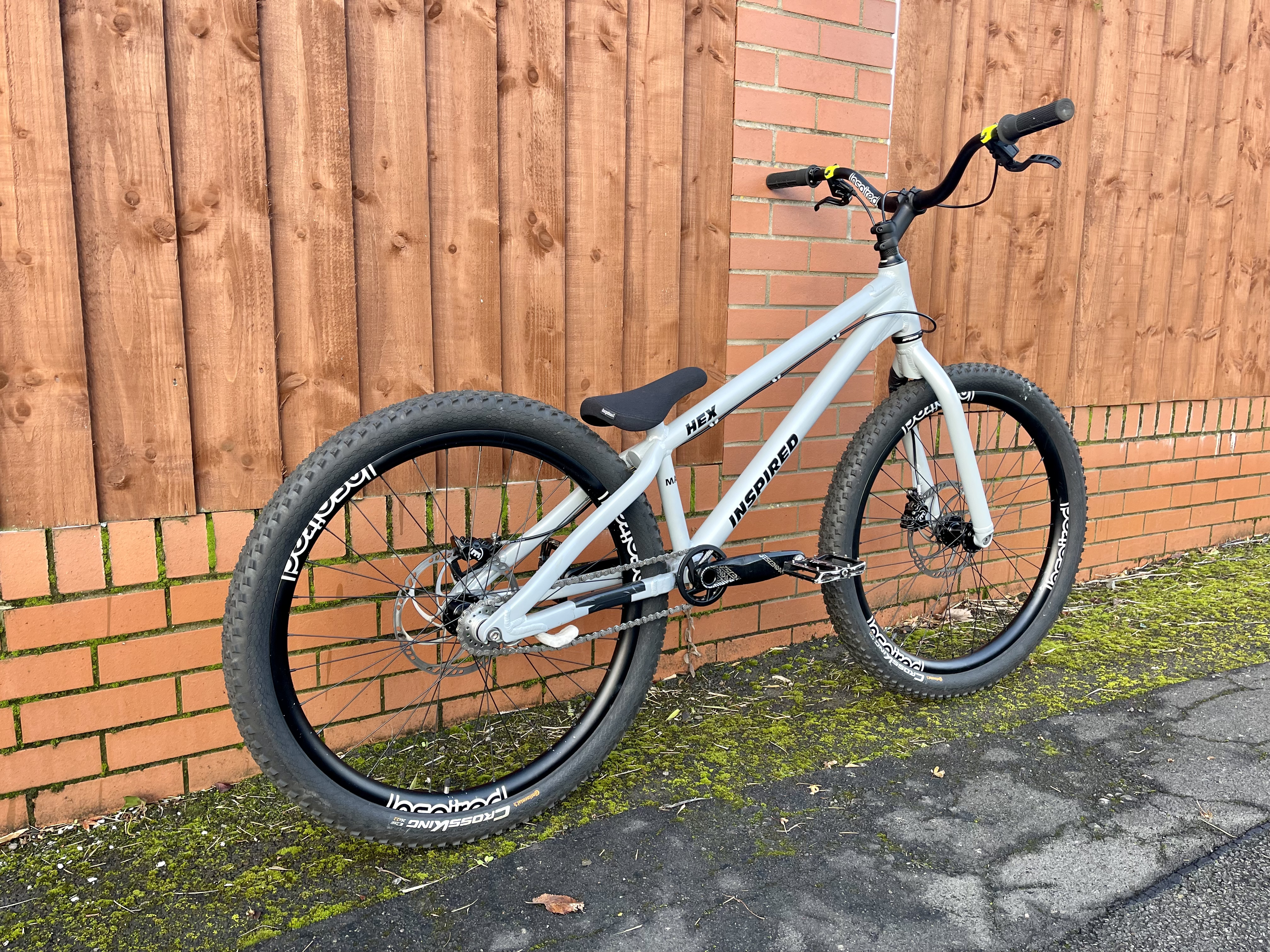

	Recently painted my hex in Volkswagen white silver. Will be changing a few more bits such as tyres, pedals and the tensioner to a new one. Overall happy with how it came out
	Looks really good!! Reminds me of the bike Martyn Ashton had, the yellow/white one.

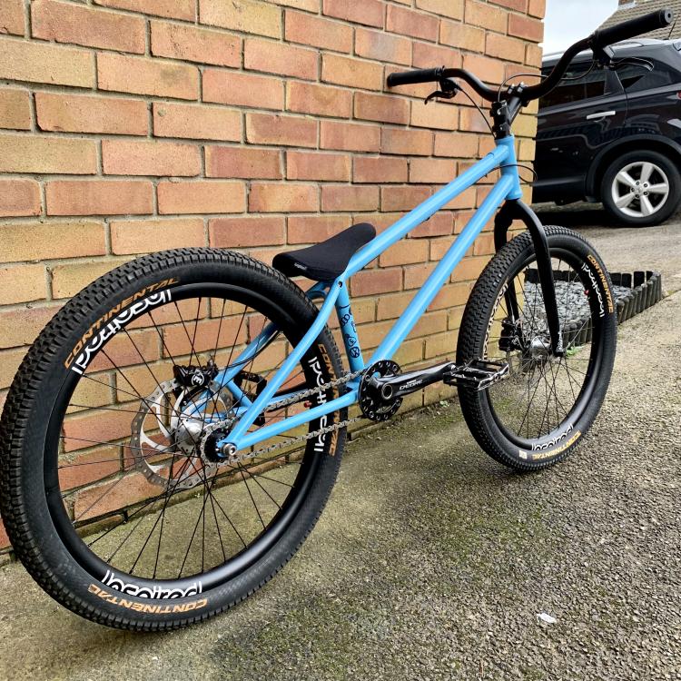

	Re-built the trials bike and played about with the stem height and geo. My sister painted drew some logos on that meant something to me and then it was laquered over!

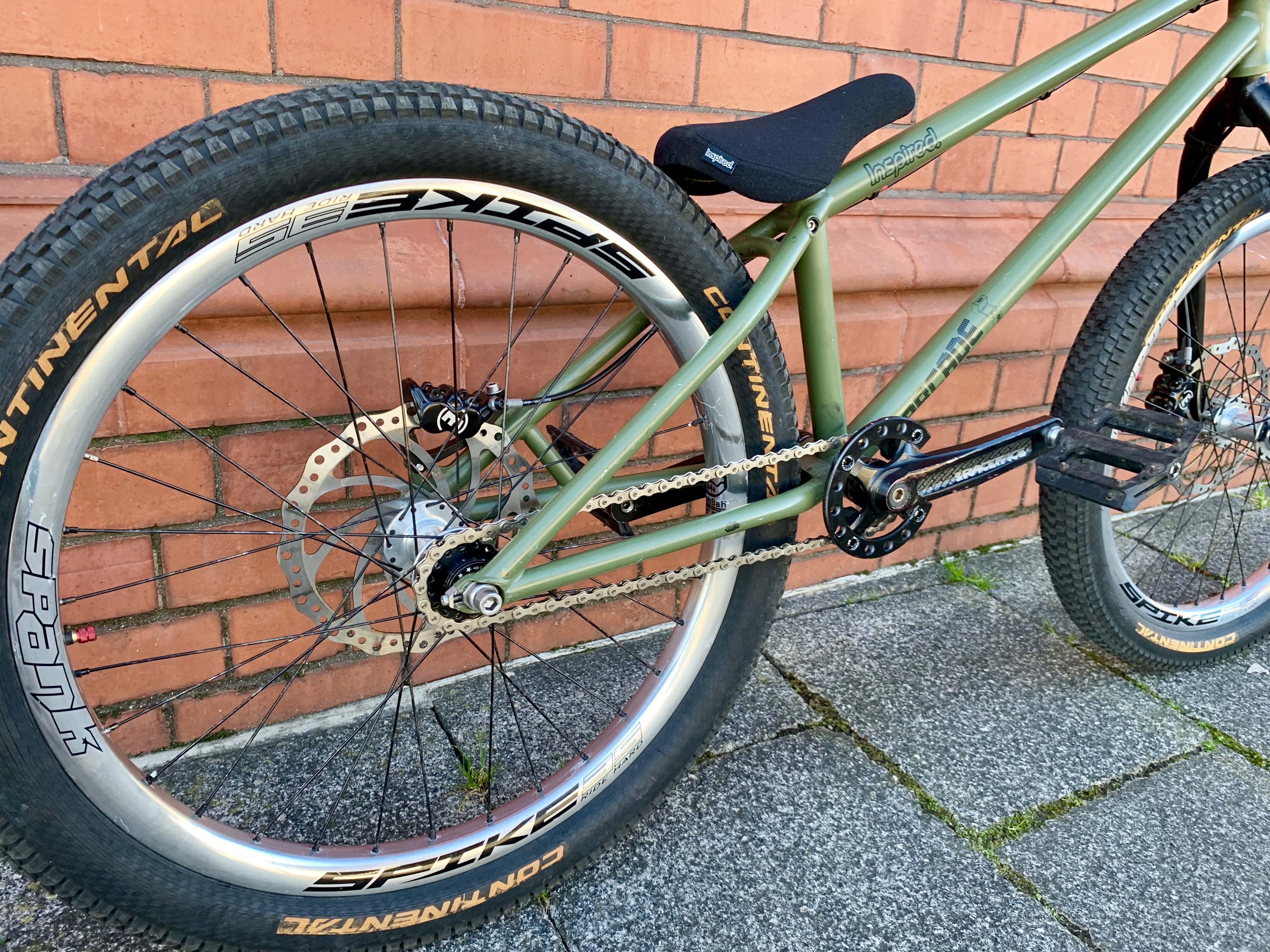

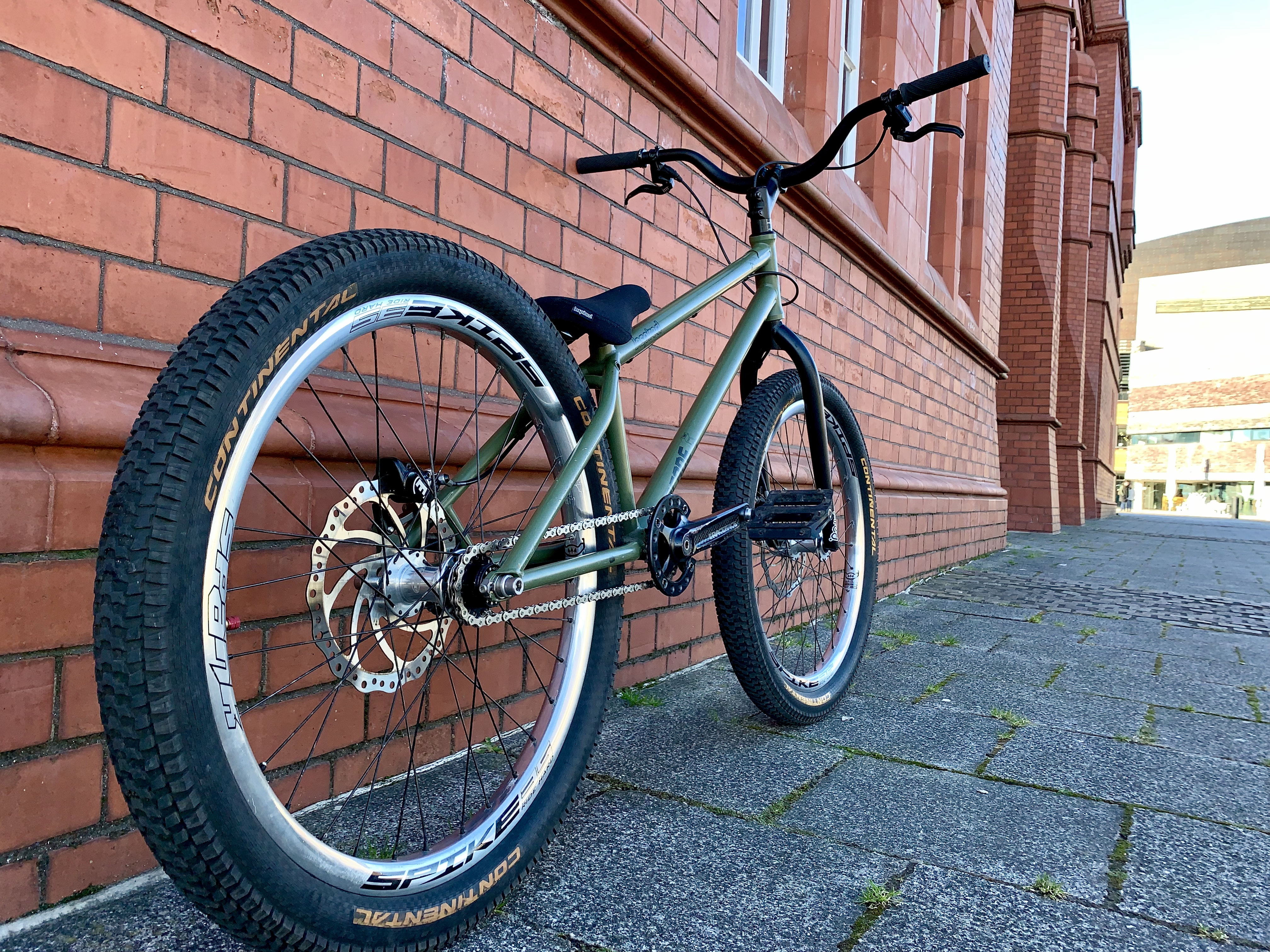

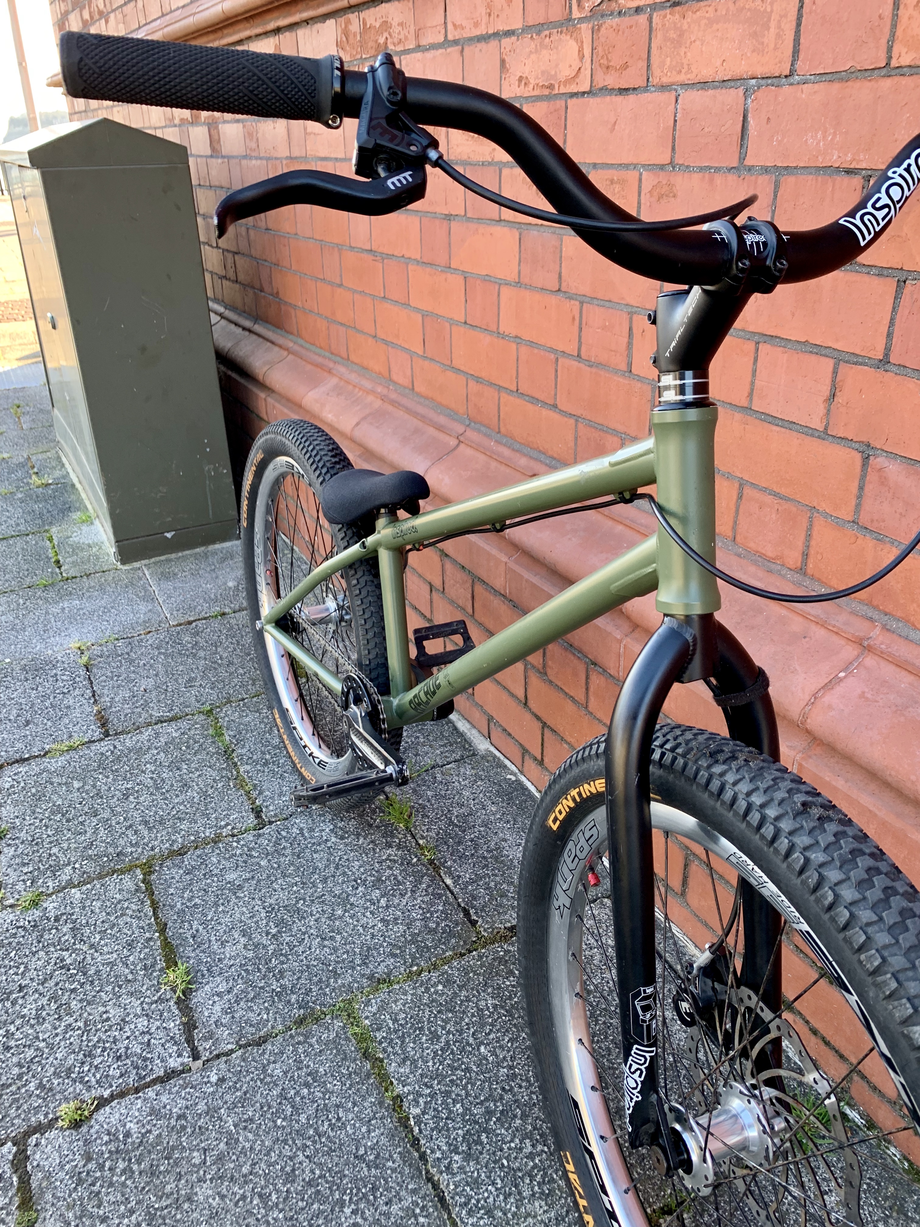

	Built this up last week, quick run down on spec is .... Frame/forks - Inspired Arcade wheels- Pro2 evo hubs built onto spank spike 35 rims , continental tyres Drivetrain- Raceface cranks, Shimano 22t sprocket, Custom bashring, Nukeproof plastic pedals Brakes - Magura MT5’s front and rear Bars/Stem - Inspired Arcade and Trialtech 80x40, Macaskill grips Seat/post - Inspired tripod saddle and post

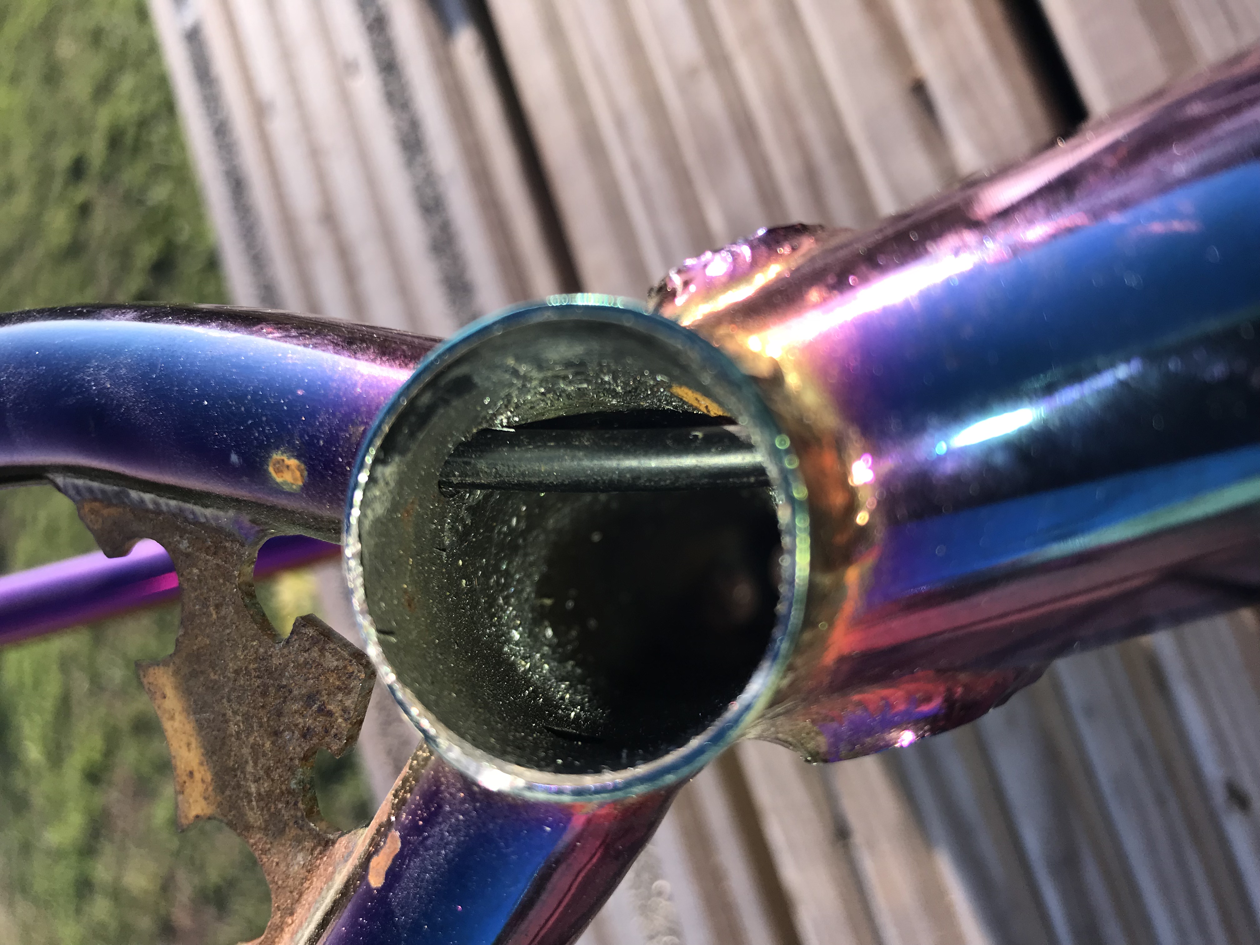

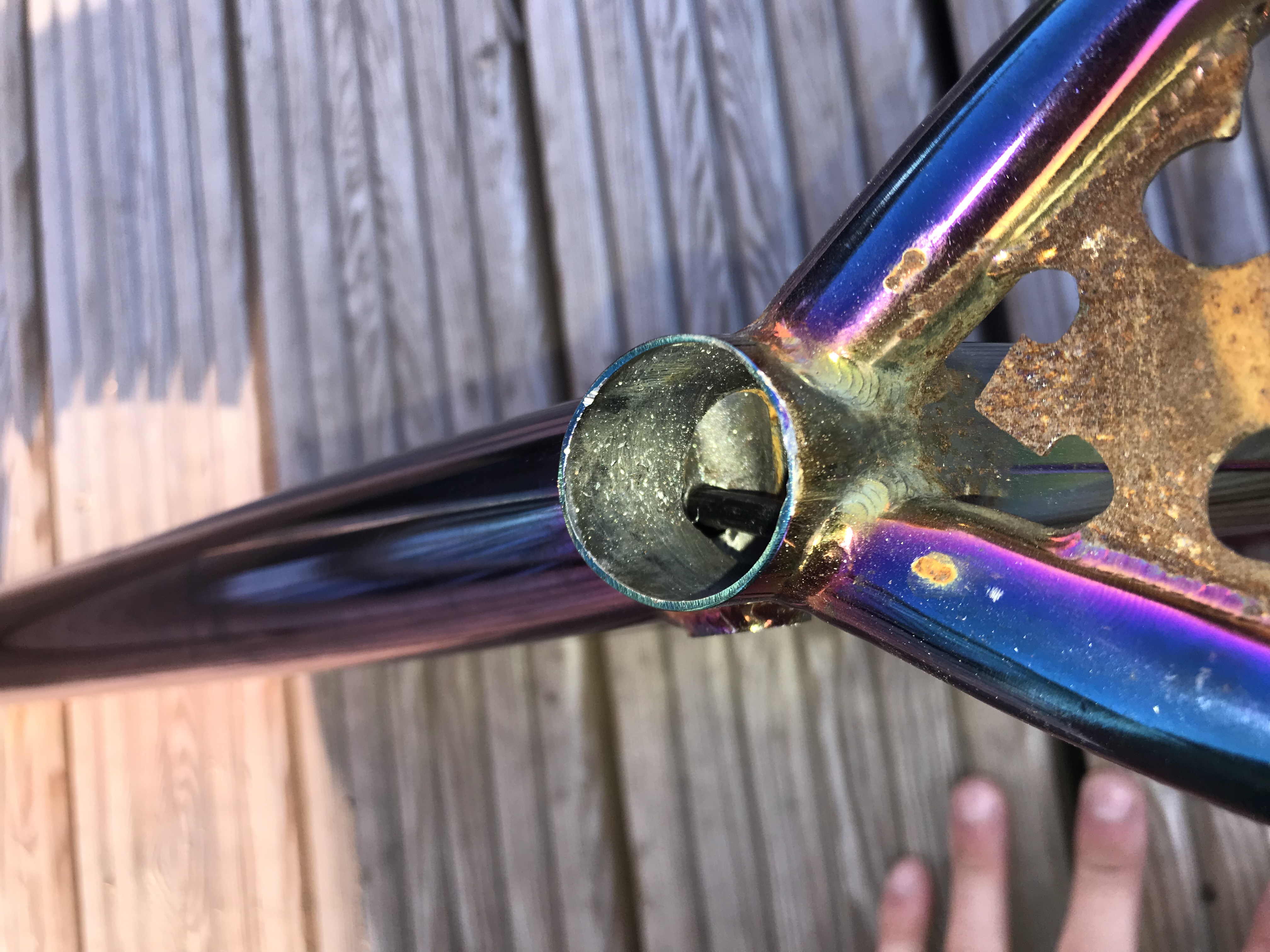

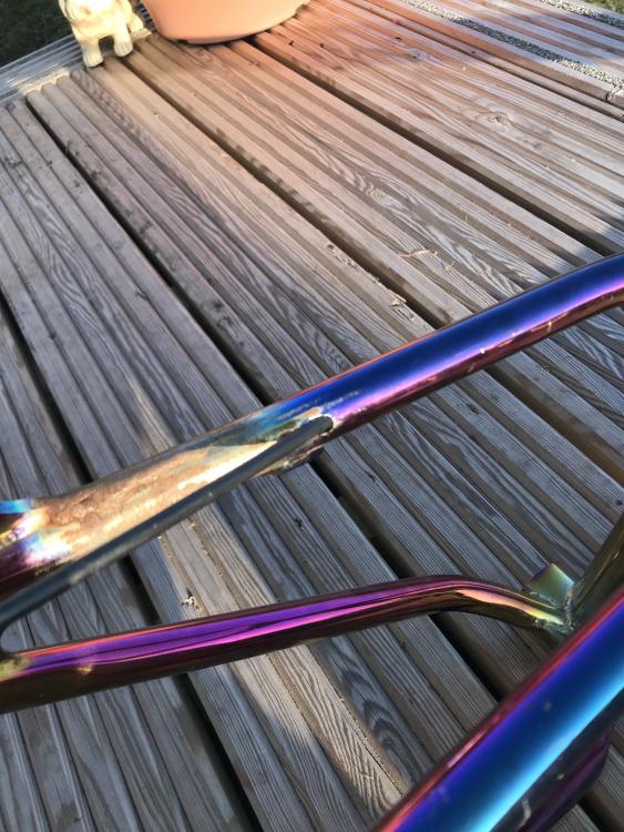

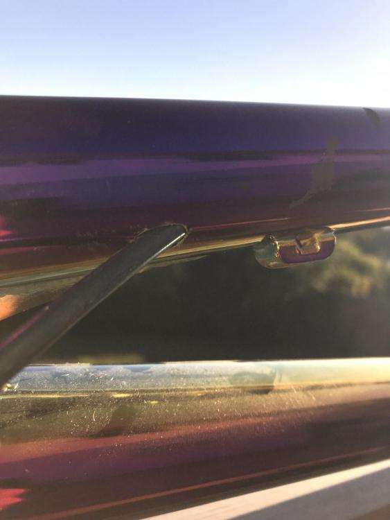

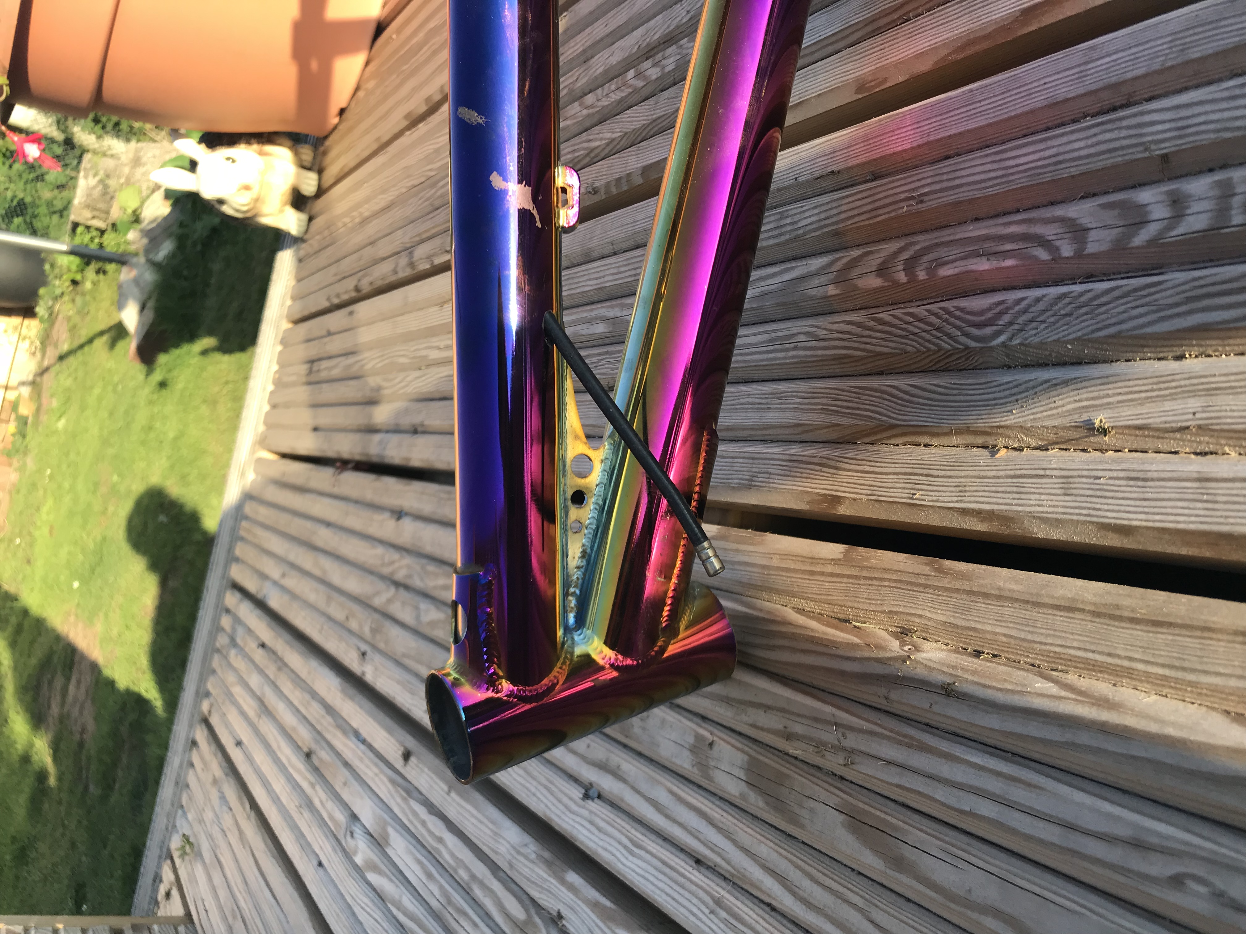

	As title says really, before I continue I would like to add this frame is cracked and bent before I got excited with a drill haha. I have tried to drill where I think is not a stressful place for the frame. I drilled an initial hole of 3mm then changed it to 6mm. Following this I angled the drill the angle that the cable would be gong into and out of the frame based around looking at my own bike. You can see with the cable going through the seat clamp area was not idea however with other frames like Marino’s the seat clamp is on top so if you cut your post down it would still clear fine (however in this instance it worked out well as I was able to see and show what was happening). Has any body got any advice on what else could be done? I thought of heat treating the area to make it stronger. Has anyone got any ideas or has this been done before? Cheers for responses in advance
