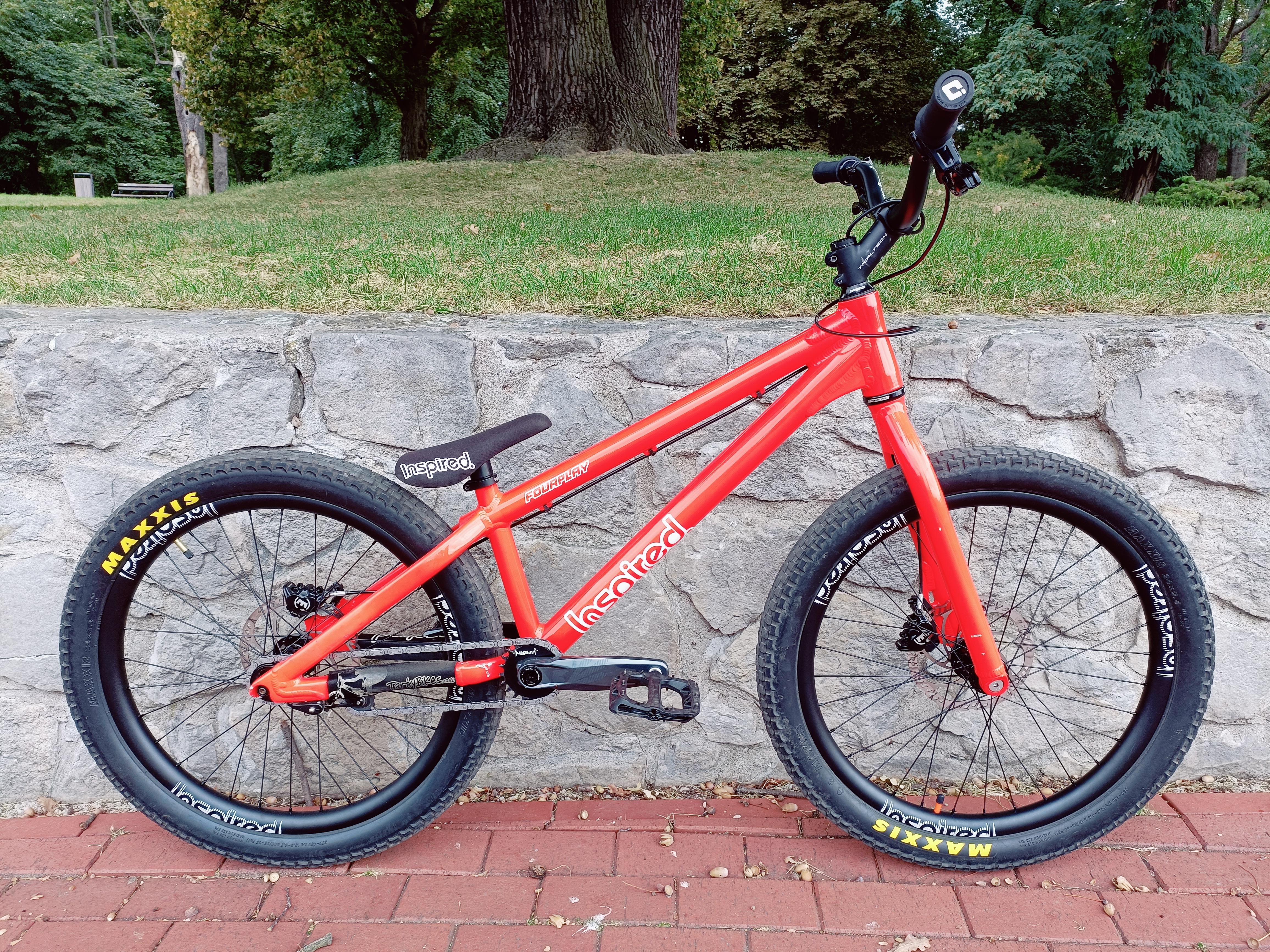

  1. My Inspired PRO rim weight 692g Inspired Team V2 rim 421g OEM spokes (64pcs) 386g Sapim race spokes (64pcs) 332g OEM nipples 62g Sapim Polyax Double Square nipples 26g Rubber rim tape 34g Jitsie rim tape 11g

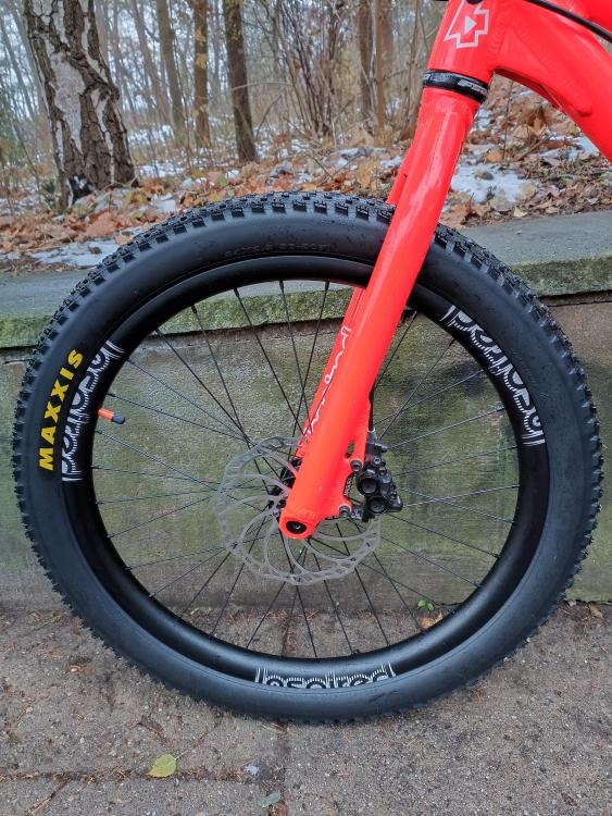

  10. Tires purchased and installed. So far, three rides in poor conditions. And I am very satisfied. Wet grip seems to be better than the Holy Roller. Weight 595g and 614g. They are thinner than Holy Roller but it doesn't bother me yet. I'm waiting for dry conditions.
