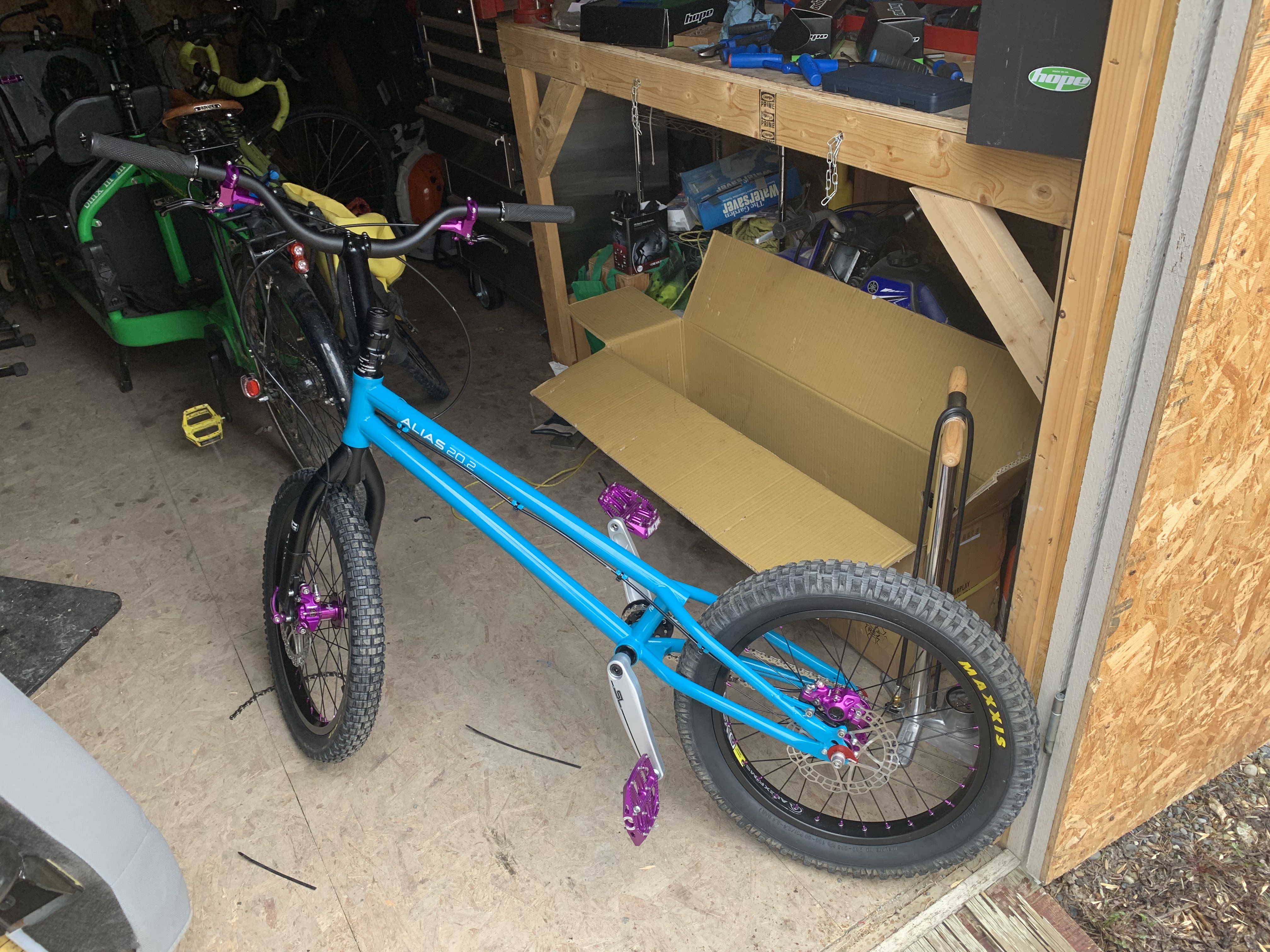

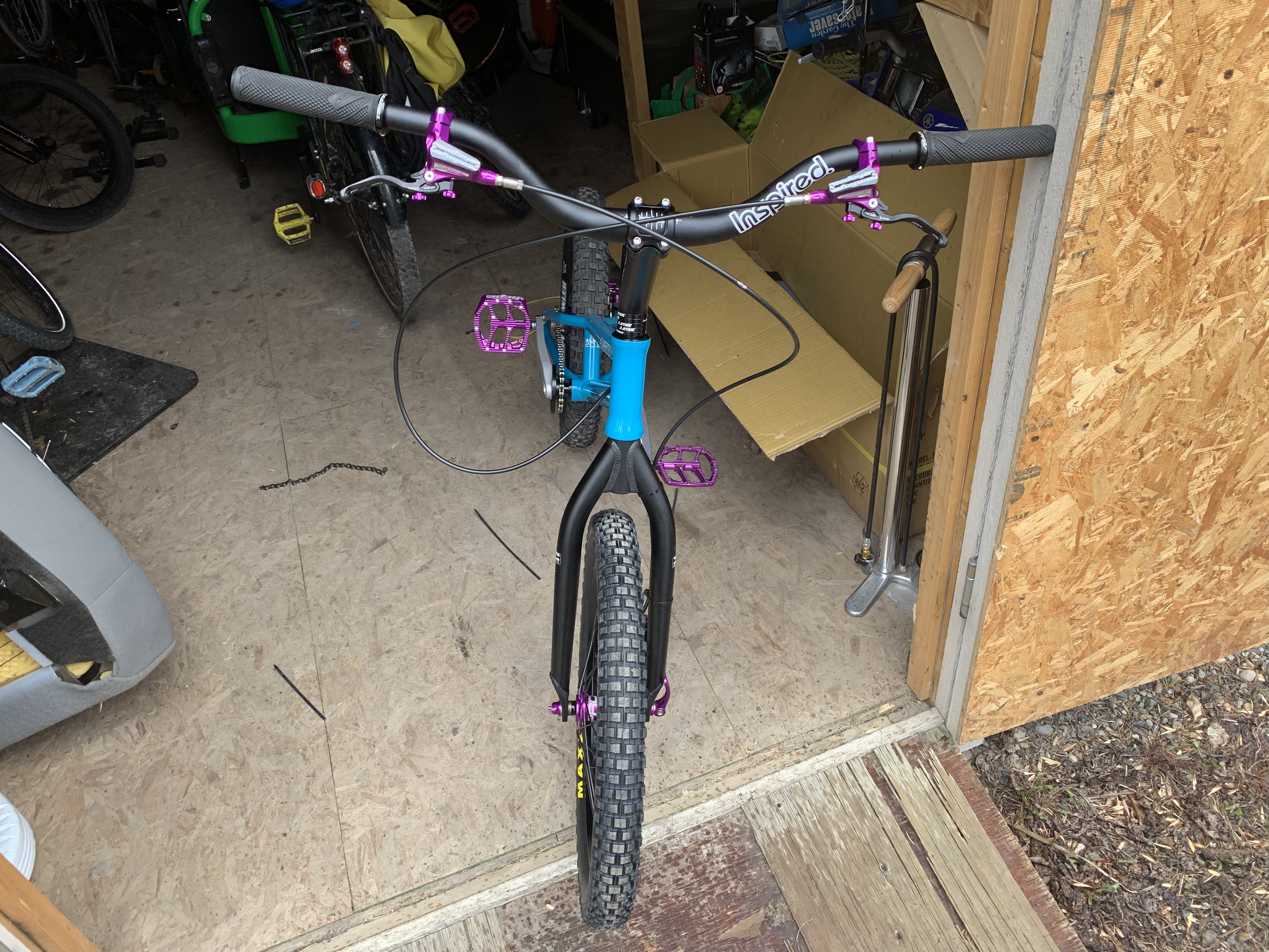

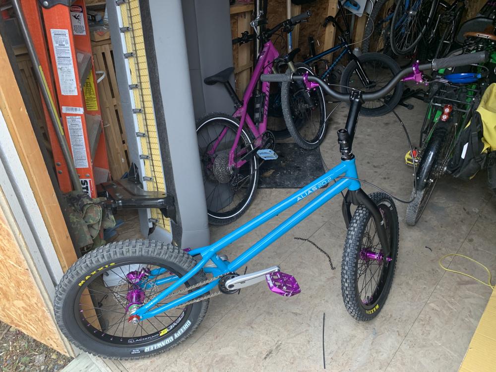

Pretty much done. Just got to fiddle around with the brakes and get them fine tuned and then shorten the hoses. And cut the steerer tube. And of course it just started pissing rain for the first time in about 8 months.
Build in progress. Just got to build the wheels tonight and then decide how short I want to cut the steerer tube.

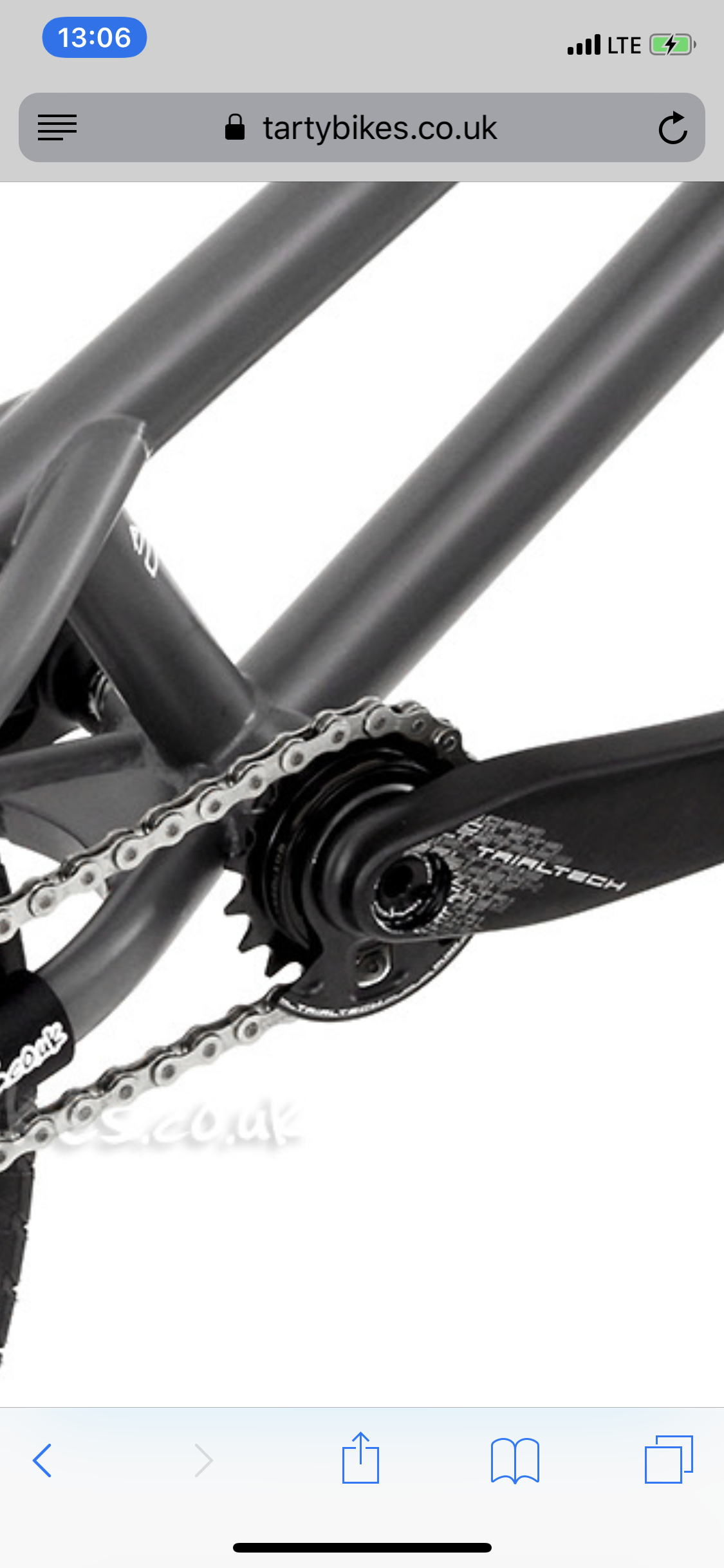

I’ve ordered a screw on 18t front sprocket onto the trialtech sl forged cranks. I went for 165mm too. So im sure it’ll all play nicely with the hope hub set up. I’ll post pics when I get it built!
So it turns out the 22t sprocket fits fine. But the crank arms hit the chain stays. So I’m going with a threaded crank and a screw on sprocket up front. The alias 20.2 frames are now in stock. Looks like my build should ship out from tarty on Monday. Then I’ll have a furious session of wheelbuilding and then the fun begins.
I sold my Skye last week. Just ordered a nice new alias 20.2 build with lots of shiny parts. I’ll post pics when it arrives and I get the wheels built up. It’s satisfying building ones own wheels!
Hmm. I hadn’t thought of that. There seems to be a fair amount of clearance space. I’ve only ordered half the build so far so I’ll confirm with Tarty before the rest arrives in stock.
Well that changes things a little! I guess I’ll be deleting my shopping cart and starting again with new hubs and cranks. That was the only thing I wished it could do was take a hope hub. Now the question is what to do about gearing. I was going to go front freewheel 18t + 12t rear for standard mod gearing. Im thinking I’d probably use the inspired/sram cranks now. So I guess 22/15 or maybe 22/14. Ill be be happy to run rear freewheel. I certainly don’t miss having my trousers eaten by mod chains. Lol.

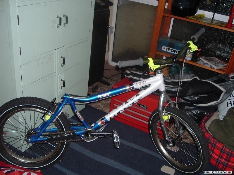

Pretty sure that’s one of my old bikes. I sold it and got this x lite in 2002. I got it to replace my 1997 square downtube x lite. I recognise the grips.
I thought it looked like an arcade. How does the 20” wheel compare to the 19” do you think?

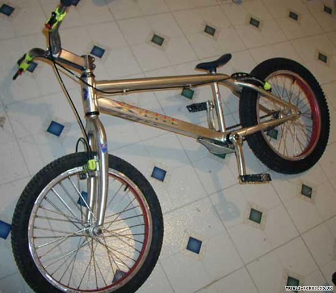

hmm, you obviously dont know much about older trials bikes. those cranks are the megamo team ones. super strong. yeh i know the brakes are wrong. its in canada and i can sort that easily by putting a hope trial on the front. the freewheel too is a good spec. less than £200....
